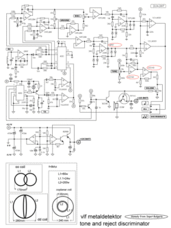

      Kalpazan detector variant.
      Tarsos and this no work in ground ,no motion amplifer.No GND fase detector.Bad low pass filter.Original schemstic work perfect with fase and amplitude coil compensation 'simulate in sascho :Metal detector with meter discrimination"

          Originally posted by Frend of Sasho. View Post
          No comment.This is a work of people without expiriance...:-)
          Hi Sascho friend
          May be Sascho also on abandonment of this forum.
          Please asking my questions from him .
          1 -How much degree phase differences between pin 1 of ne5532 ic
          And pin 1, out put of lm393 when diskr. Pot variable from minimum
          To maximum?
          2 - How much degree phase differences between pin 1 of ne5532 ic and pin 7,
          Out put of lm393 when ground pot variable from minimum
          To maximum?
          Best regards.

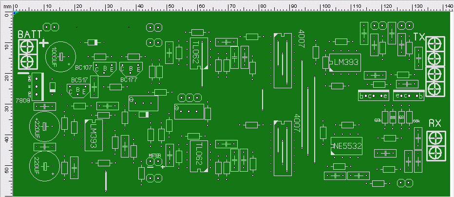

            Hi
            After my success with ivconic TGSL , I decide build Sasho vlf , scrutiny Leto
            PCB design , position of devices was good ,therefore redraw it with some changes in sprint layout format.
            Best regards.

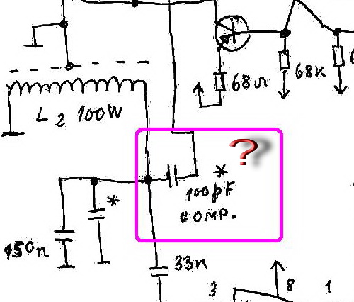

                Hi SASCHO
                Some people in Turkish site believe your detector
                Didn’t work well. maybe those are cannot ,adjust
                Correctly.
                Same as nexues detector ,it is working at full
                Resonance mode.
                I constructing it now and decide tuning for reach
                To maximum deep.
                About 100pf compensation capacitor:
                You said, at the first remove 100pf, then
                Tuning receiver parallel LC Circuit for maximum level
                Reading on oscilloscope. Then apply this cap.
                This capacitor apply some transmitter oscillation to
                Receiver input. Why? How tuning it for optimum
                Result?
                Best regards.
                • #53
                  Minimal amplitud in pin7 ne5534.Original schemstic work perfect with fase and amplitude coil compensation 'simulate in sascho :Metal detector with meter discrimination"

                    Здравейте SASCHO
                    Добре, аз видях в най-вериги, ти го използвате тази metood
                    за Comp. приемник съчетано с кондензатор за излъчвателя.
                    Какво е предимството на други vlf детектора?
                    С най-добри пожелания.
                    Hi SASCHO
                    OK, I saw in your most circuits , you did use this metood
                    for comp. receiver coupled via capacitor to transmitter.
                    What is advantage to other vlf detectors?
                    Best regards.

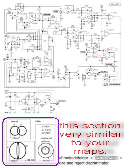

                    • #55
                      Здравейте отново SASCHO
                      Да събера всичките си верига в geotech форум.
                      Видях по-долу схема на този линк:
                      http://blisstool.com/index.php?optio...&limitstart=10
                      Това е много ниска резолюция. Моля, дайте ми го с по-добра резолюция.
                      Настояще връзка или го изпратете на aft.72005 @ gmail.com
                      Също така благодаря много за всичките ви проблеми са взели по въпроса.
                      Hi again SASCHO
                      I collect all of your circuit at geotech forum.
                      I saw the below circuit at this link:
                      That is very low resolution. Please give me it with better resolution.
                      Present link or send it to [email protected]
                      Also thanking so much for all the trouble you have taken in the matter.
                      Best regards.
                      • #56
                        This is NOT my schematic!
                        Sascho
                        • #57
                          Sascho
                          Hi SASCHO
                          I thinking ,it is your design .
                          because this section very similar to your maps.
                          Best regards.

                            Hi
                            Best regards.
                            Hi SASCHO
                            Are you design pcb for the best vlf detector ?
                            Best regards.
