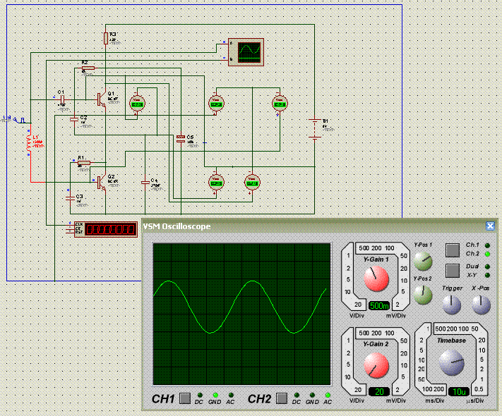

      I am afraid that there is problem with oscillator
        The circuit works perfectly. Depth target is 15x15cm -1m. The oscillator amplitude is 30v pc- pc. I built it 10 years ago.
          I can't understand how the oscillator is working . I never saw an output coil to be connecting at the input of the oscillator-amplifier (between the bases of transistors) ???? If it oscillates...the base current is very low so the output is very low.
            Geo, this is a push-pull oscillator. First make the oscillator only and look its oscilloscope diagram. Then write here what have you saw.

                Hi Sasho
                What is the operating frequency ?
                  11khz
                    Hi Sasho and all
                    Simulate only TX section with proteus 6.9 software,
                    In mathematical area on computer good working without
                    Any problem .out put frequency approximately 10khz .
                    Output voltage level = 60 vpp. supply voltage = 8volts.
                    Search coil inductance = 1500uh .
                    I study all of your circuits which uploaded this forum , my opinion
                    Are well and interesting.
                    Best regards .

                            No.I built 10yars ago. Tune c5 to maximal oscilator amplitude.
