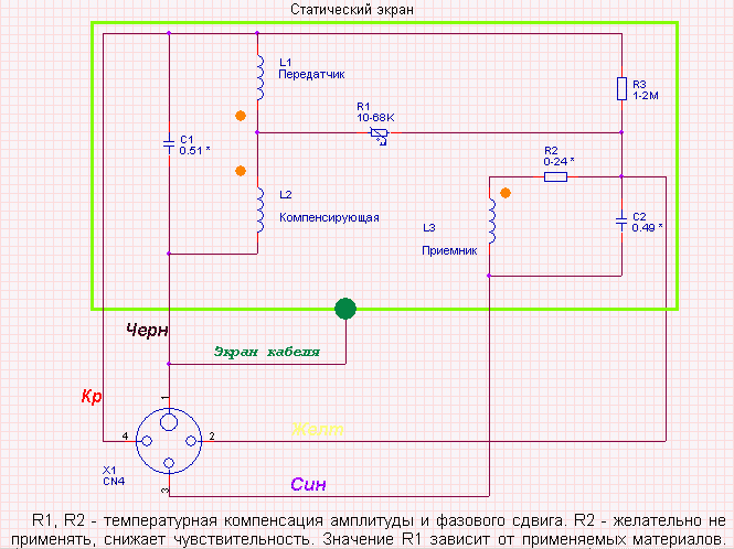

        how to do the thermocompensation of the balance is much important. look here a coil schematic.
              Hi KT315,
              what's this ? Is it from original coils ??? Seems an add-on...who maked it ?
              I've built the coil following Mike's instructions and works fine. No need to thermal balancing.
              So is it needed in too cold/warm areas ???
              Best regards,
              Max
