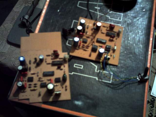

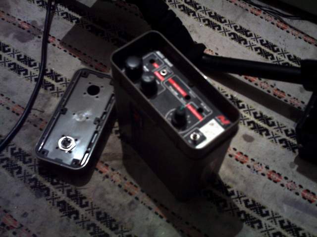

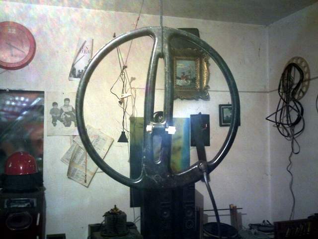

            So i took housing from my broken Relic Hawk and decided to put Sasho's detector inside, also to use R.Hawk coil with it. And it is working just fine with it. Detecting onluy coloured metals, very good.
            Cola can it can detect with this coil at 90cm.....No detection on iron at all.
            Heh!
            Here's some photos!
            P.S.

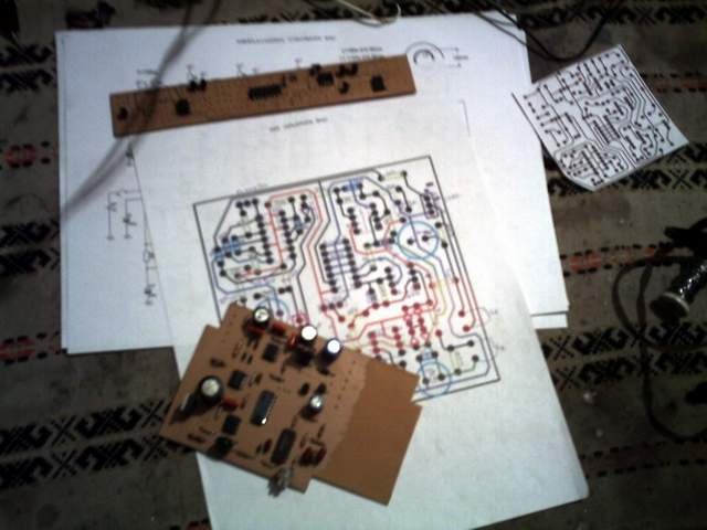

            I made two detectors, one for me to play with it occasionally and one for my friend....
              RIP
              Relic Hawk is now resting in piece....Amen!
              I still have complete pcb with components, nothing missing.I just gave up of fixing it. It is available for trading if somebody interested. I cant send it by mail, abroad....So only compatriots can make offers....Also bulgarians, due they are close to my place...
                Mixed up...
                I mixed up photos here...never mind....Also didnt take any photo of RH pcb.... If anybody interested i'll do...

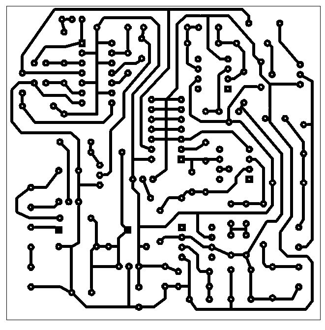

                        I will correct the PCB layout (one sided) and post it here.

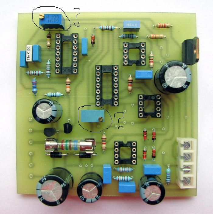

                          Hello
                          Can you tell me can I change NE5534 whit something?
                          Because I cant find it!
                          What is Im2930-8?
                          And how are called this parts?
                            "This part.." is multi turn trimmer potentiometer....may be replaced with ordinary....
                            29xx can be replaced with 7808....although better to use low-drop..
                            NE5534 can be replaced with LF357 or LF356....I used those instead NE5534 and those working very well...also other replacements....LM318 for example...

                              Corrected PCB (8x8cm), one jumper (+ for NE5534)
