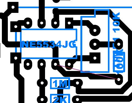

    Except few unknown capacitators and the upper conection around NE5534/where is conected this resistor to pin 7 and 8 or just to 7?
    Every thing else looks cool.
    Very elegant PCB.
    If anyone spot mistake please alert.
    I am in the middle of collecting parts.

      Hello Ultimate
      C4 8.2 pF is not looking on PCB have to be connect 5-8 . legs of ne5534
      Erol

        Its looks like you didn't understood me.Look this.
        7 and 8?or only 8?
        • #79
          Hello
          I understand You but C4 is missing on PCB .You have to add C4
          I think connection is only 7. leg according schema.
          I asked to asenkron.I will inform you.
          Best Wishes

            Usualy I print the schematic and in same time look at pcb on my PC.So now no toner and just give it a quick view.
            Thanks for help.

                            Hi all! Build up the layout and did not works The PCB has a lot of mistakes, you need to improve a lot. Are now in virtually all systems, but the detector behaves in a strange way, also has a small range (max 30cm) (could be expressed to someone who did and who is good work? (Sorry for my English ...)

                              • #90
                                I guess small misunderstanding happened A few years actively attend the detector, I know these things My point is simply the same pattern, whether it is correct? PCBs is another matter ... Do not expect giant are any performance, but the helmet could therefore detect the approximately 1.5 m, and I think that with such power and strength in the coil is rather poor value. And that got me interested detector already on the ground, he should have quite long ranges and at the same time ignore small metal objects Location shallow. (1x1m coil)
