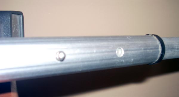

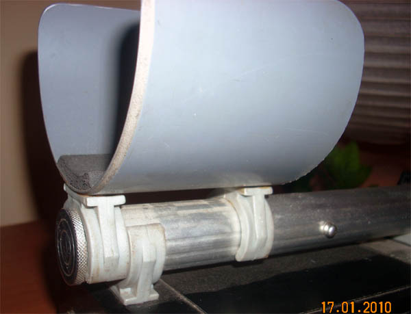

    handrail for the painting of the Austrian production and other parts used for installation of steam heating.
      What is this, battery department or pin-pointer?
      Yes this is battery department for AAA - NiMH batery 800mA.
