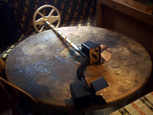

                      • Here is photo of one finished SMW. This one is with handmade coil...
                        I used TGSL front panel for it, beacuse i haven't prepared panels for SMW yet...

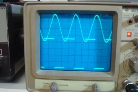

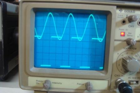

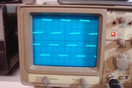

                            • Originally posted by Magma View Post
                              I think, you're probably turned to the entrance of the coil in rx or tx.
                              Hi Magma.
                              I have a discrimination problem, so if you can help me.
                              My Disc potentiometer rejects the "no ferrous" objects but not the iron. So with potentiometer full closed i receive a gold or a silver coin very easy, but detects and iron. If i will turn it right then i detect the iron good again but not the gold or silver.
                              I attach a photo of the out pin1 of LM393 (Geb), one photo od the out pin7 of LM393 (Disk) comparing to Tx signal and oe photo between pin1 and pin7 (Geb - Disc).
                              I forgot to tell you that i reversed the coil wires without results
                              I wait your opinion
