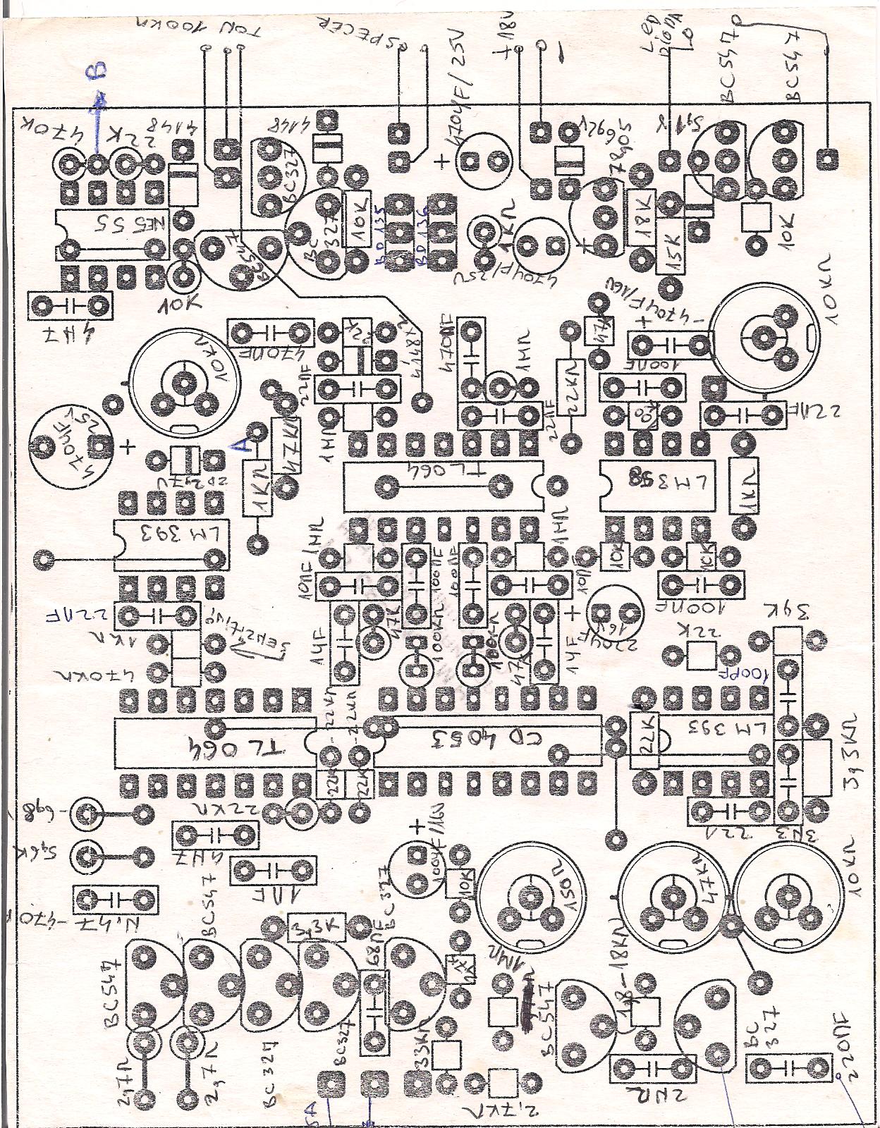

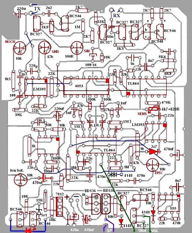

        • Corrected and amended ....
          • You made the topic so much about the detector, which is so simple, and which is all known. My first Gold Rover as it so then I called before I did 5godina. Set a pattern for you two tons, which I did 3 years ago and which is 100 percent accurate.http://www.geotech1.com/forums/image...ilies/wink.gif
              Error .... I'm sorry, ZD2V7 is oriented wrong!
              • Attached Files
                • Originally posted by Magma View Post
                  Hi,Magma!I think there is another one mistake in this pcb.At the pot "SIN" middle pin,which is "+" must be connected to right pin ,where must go "+" too..
                  • Originally posted by Pompey View Post
                    Thanks, but I ignored it, only the exact schedule
                    components.
                      Thank you neighbor, I forgot about this upgrade, it's been a long time since then.

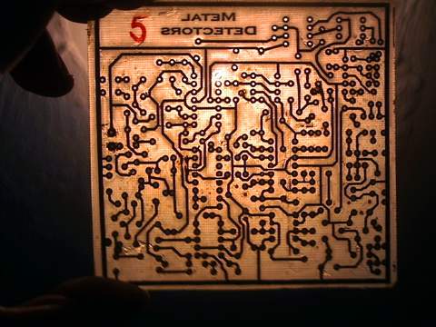

                      • Ok...i skimly searched through my HUGE pile of scraped pcb's and founded this one with audio extension included.
                        Since my camera is to bad i also discovered EXCELLENT method to take so so sharp photo in present conditions in my living room...
                        Later on i might find a proper schematic too..need to search trough tons of papers! Huh!
                        Maybe later or maybe these days...it is to cold upstairs in my workshop!
                        Anyway...this pcb shows enough by now...

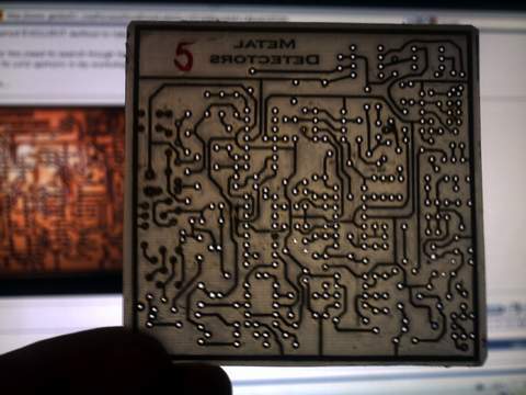

                        • Trying again, this time to use monitor backlight!
                          In background there is my previous post....which one is better!? Hmmm...
                          The first one is better ("light bulb" version!! )
                          I just discovered "poor man scanner"!!! Yup!!
                          • Small correction;
                            it is obvious (looking at pcb traces) that used opamp is single one - not dual opamap. So it can't be TLC272 but TLC271 or simillar....
                            Orbit can correct me if i am wrong...
