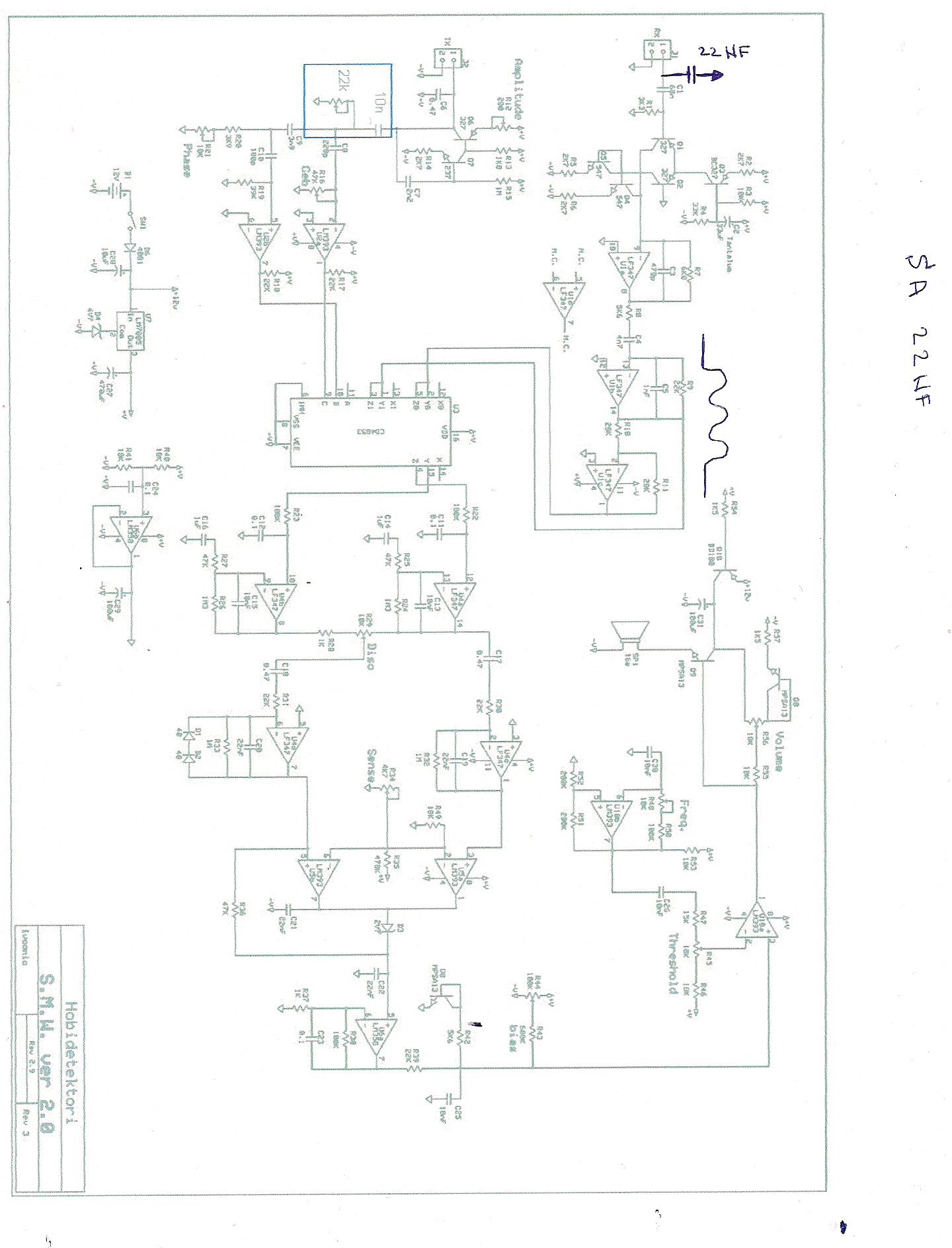

        • Finally i found the solution but have another problem.
          I reversed the Tx signal again.... and i made a new calibration of the Phase, Geb and total phase potentiometers and now is ok.
          It full rejects a piece 10cm of ferrite rod, also don't beep at iron and it is good on gold and copper.
          But i lost depth!!!!!
          It detects a 30mm coin at 40cm, no good depth for a 15" coil.
          Yesterday when it was unstable it detected the same coin at 50+cm.....
          Also it detects the soda can at 75cm compared to 1m yesterday.
          Sound is worst ..... when the signal is strong it beeps OK, but when it is a medium or small then it beeps interrupted. Maybe i must replace it with the 555. Also it needed a fine tuning of the coil.

              Hi Geo
              You must change the value of C9, how? I am not
              sure, I think it would be good 6n8. Capacitor and
              potentiometer, which are already added, in this case you should
              remove.
              • sinusoida sa 22nf nije vise slomljena , veci domet i stabilnji rad .
                  • Pravilna sinusoida ,ne vise slomljena .Veci domet ,stabilniji rad.

                            Geo has a problem with his probe blue max, Do you have any idea?
                            • Bluemax has Tx =540uH and Rx = 33mH.
                              Also Tx and Rx are not in phase.

                                Try to sort the C26. Sound becomes more good (not 555 version)
