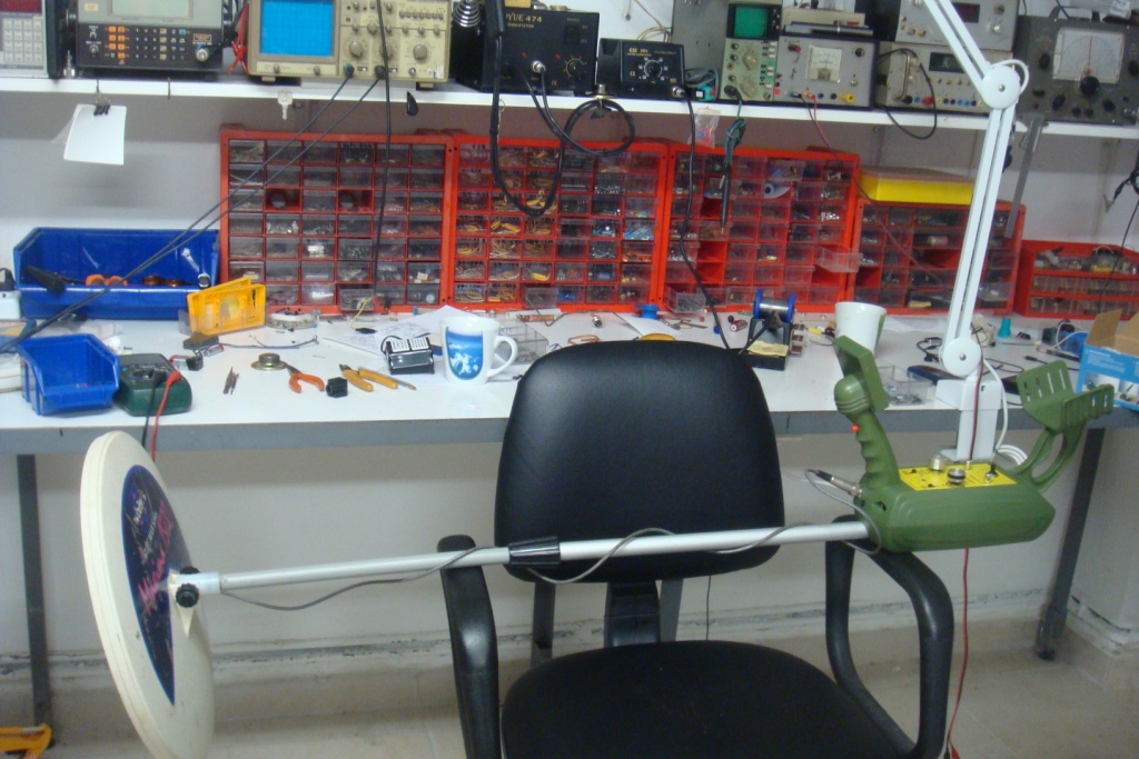

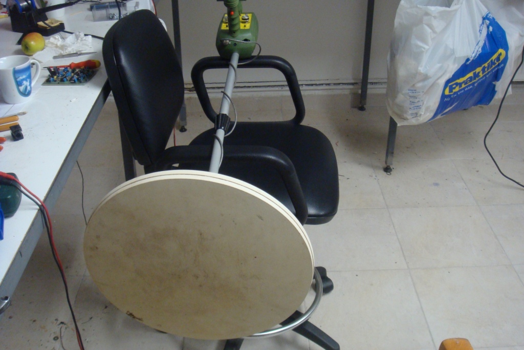

              • I finished my Caesar with the BlueMax 1500. The detector is very good at air test, but i must make a really test when the weather will calm.
                I put the detector inside a box of a MD5002. All ok but the coil is very heavy for this box so when i move the detector i hear always some krik.... krak... etc from the bad plastics. If i will keep it, i must replace the box with the arm.

                  • Yes, but is not comfortable. It is heavy
                    Maybe today to try a Blumax 950!!!
