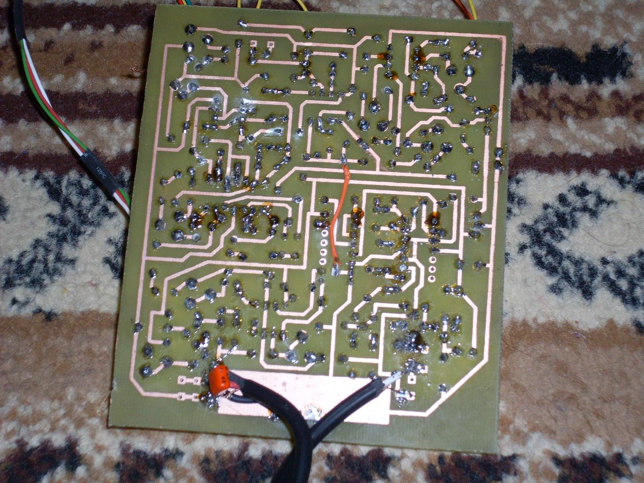

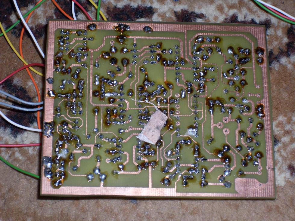

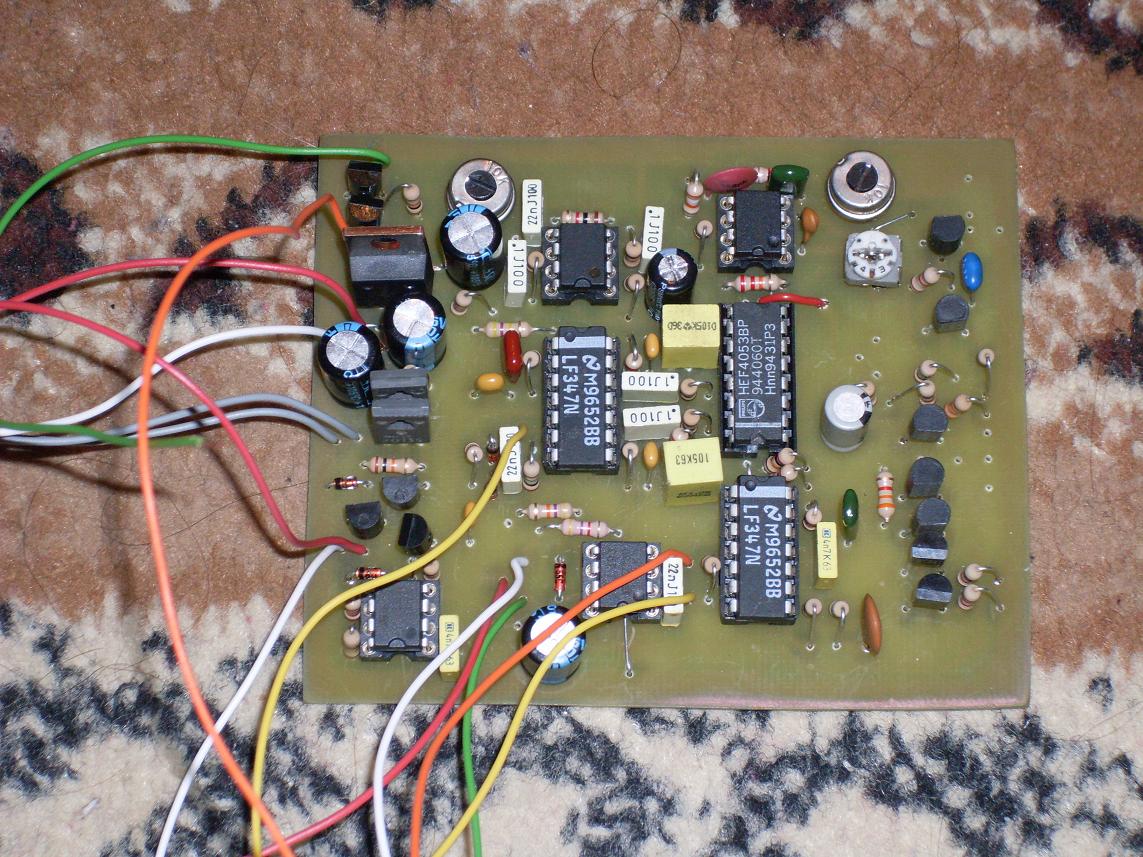

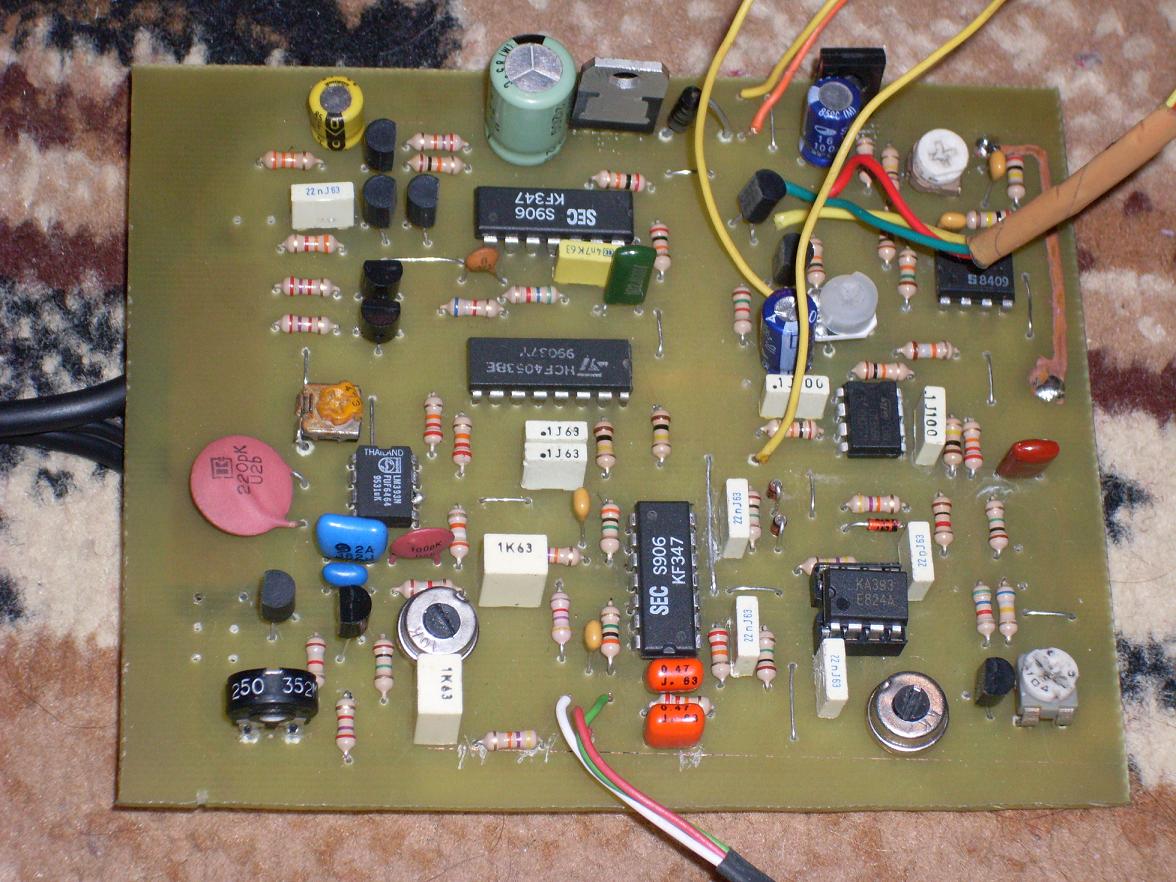

    • Golden Mask 2 as it seems with standard IC circuits and parts

        • MD "CEZAR"
          Hello, everyone! "CEZAR", so this scheme is known in Bulgaria. I read
          here are given only air test (€ 1 45 centimeters!!). Very good, but this is not
          important parameter for an MD. Some will tell you what rezoltatite the earth, MD are seeking to metal in the ground and not in the air!

                  • Originally posted by georgi.g.zhelev View Post
                    At such high air sensitivity test in field work would have to strongly reduce the sensitivity (TUNE), discrimination is not true (ferros, no ferros). GEB should be much efektiven.ONLY TEST OF LAND WILL SHOW THE TRUTH!
                    As I heard from builders Caesar cannot go deeper in soil than 20cm for coins.
                    • Hello Dear friends I am interested in your experience directly with the polygon for example the Roman denarius in the country where the depth can be detected maximum, or what device you tried it offers the best performance in the country.
                      • I am Caesar made a lot of pieces, and my one friend I have tested it on 18 mm diameter gold coin in the country with plenty of minerals the gold is located at 20 cm without any problems but no more, we compared the same gold Garrett in 2500, Fischer 1266, Fischer 1265 igl spectrum vajts Classic 3 vajts idh normally under the discrimination does not see any of them except the cesar and Vajta idh
                        • However in some places I found with the coins cesar much deeper than expected and things Krupanj fist sized piece of lead on 7ocm in the country.
                          • I will make ground tests soon and will show video clips here
                              Good to hear about different experience. Congratulations to you on your success.
                              • Yesterday i made a real test at a farm with the Cesar and the Sovereign.
                                I found a very thin copper coin at about 25cm in heavy terrain. Sovereign located it very strong, and cesar not so good (it wanted the coil to be very close to earth so to locate it). On air test cesar is better but at ground Minelab is better. But it is fantastic for his money.
                                I tried both with 15" coil. Maybe another time to test both with smaller coils, for the time i have not yet smaller coil for the Sovereign.
