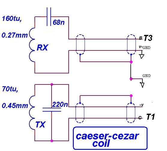

          • Hi Freddy67
            try to put each capacitor c in on coil RX , TX like pic. Will greatly improve the situation.
            -Be sure to Ground and Ground virtual.
            - R16=47K GEB Adj.
            best time
            j.Click image for larger version
            • Hi Jap
              Thank you for the information. I implemented the components as shown in the post # 105 and I replaced the capacitor 470 nF by 220 nF .
              I just ordered a L, R, C, and transistormeter, but as it comes from China, I have to wait 6 to 8 weeks.
              Best time

                • I have made some measurements, my Tx coil have 1,52 mH and 1,6 ohms, and Rx coil have 2,4 mH and 2,03 ohms. Coils are tester on 1 KHz. Coil is DD type, 16 inch by 14 inch.
                  • Hi TheBreMar
                    -What you got from the results is not like Standard coil is 0.9mH;2,1ohms/ 14,72mH;30,6ohms.
                    This does not comply with this project . best time
                    j.

                              • Originally posted by TheBreMar View Post
                                I have one question, why there must be a gap about one cm in length when we put aluminum foil on coils???
                                If you don't leave a gap in the foil, then it looks like a shorted turn. This will completely ruin your detector's sensitivity.
