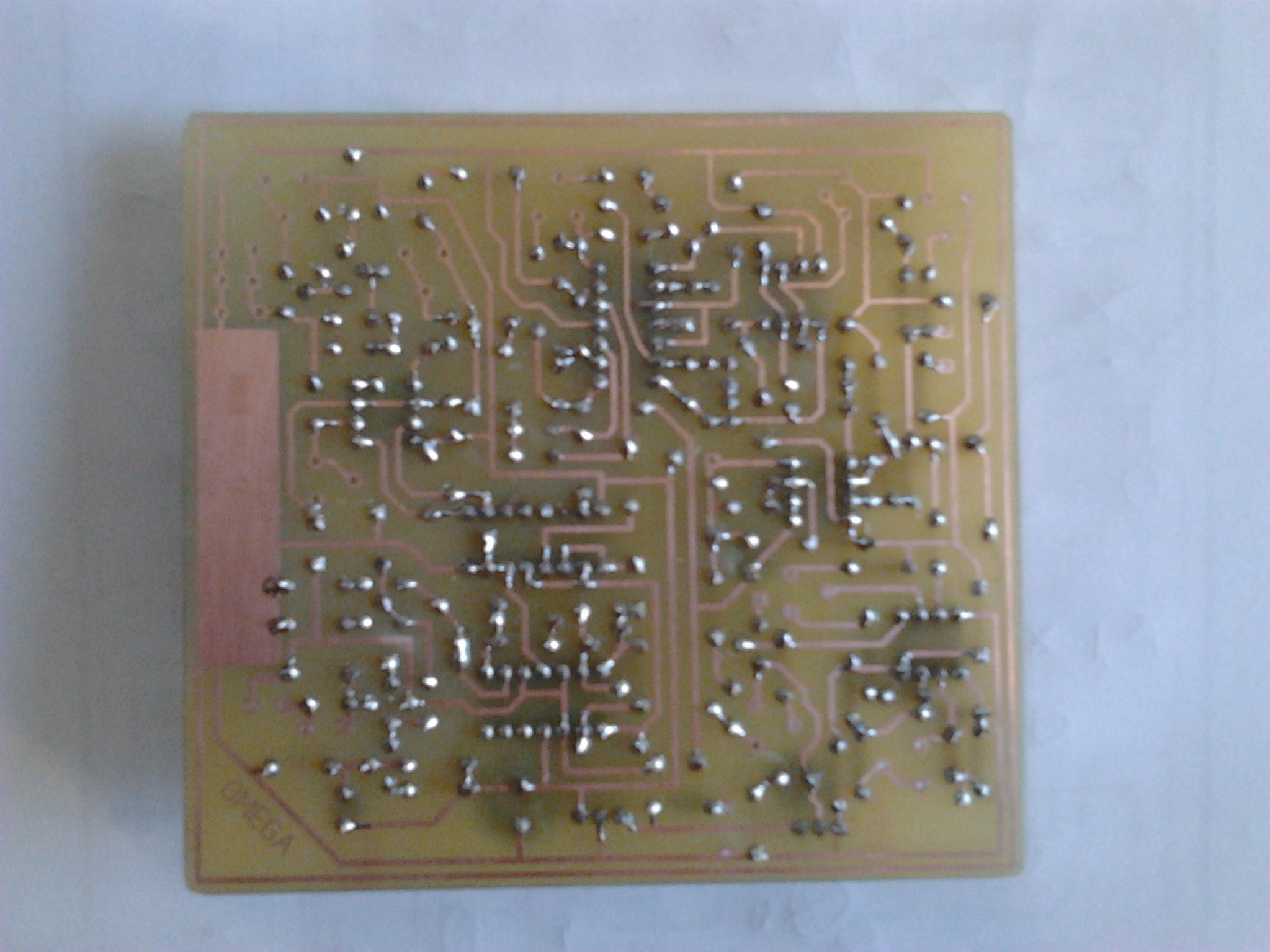

            and I want part list of this pcb
            http://www.geotech1.com/forums/attac...5&d=1352457719
            ......... please ......

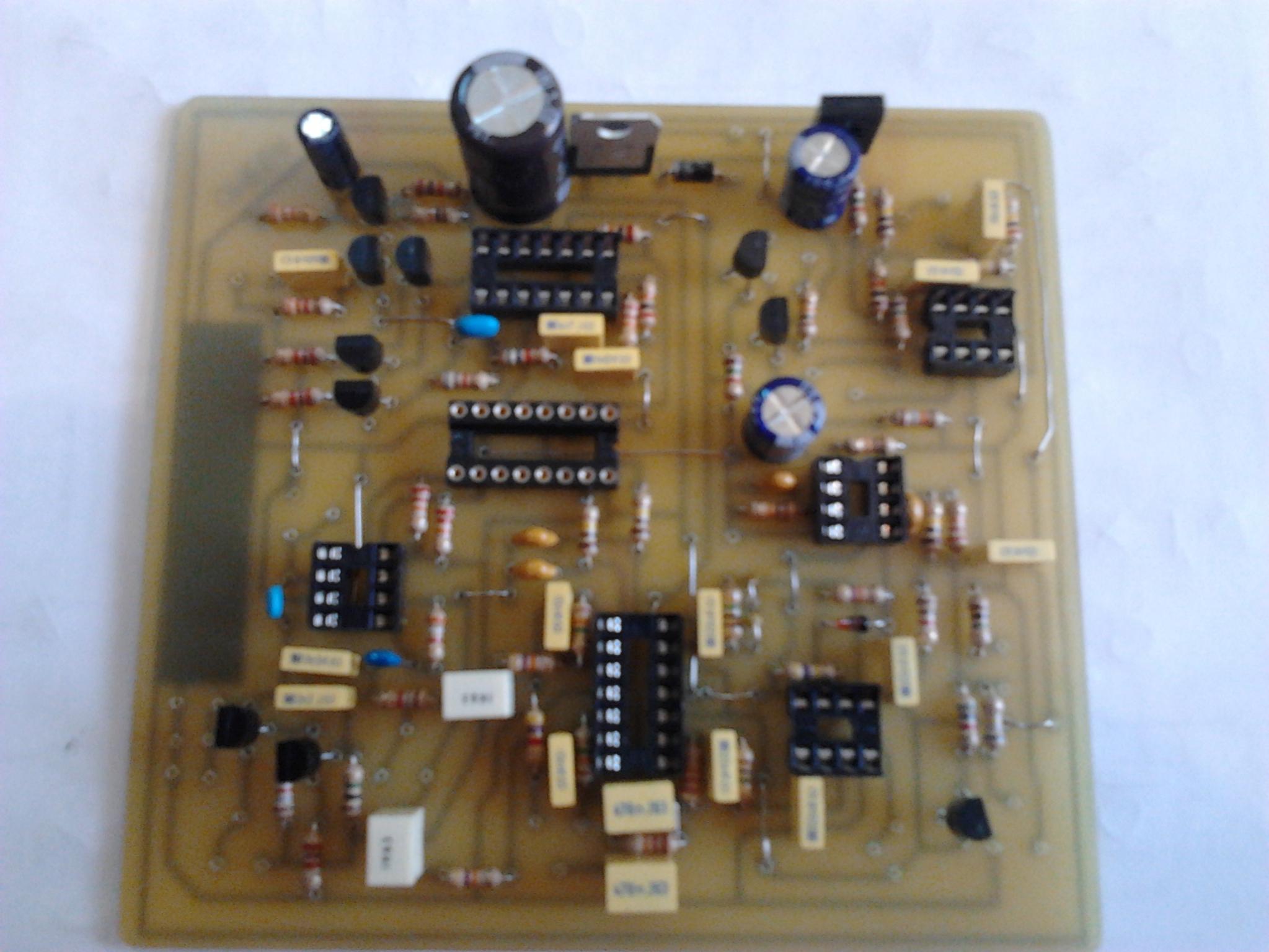

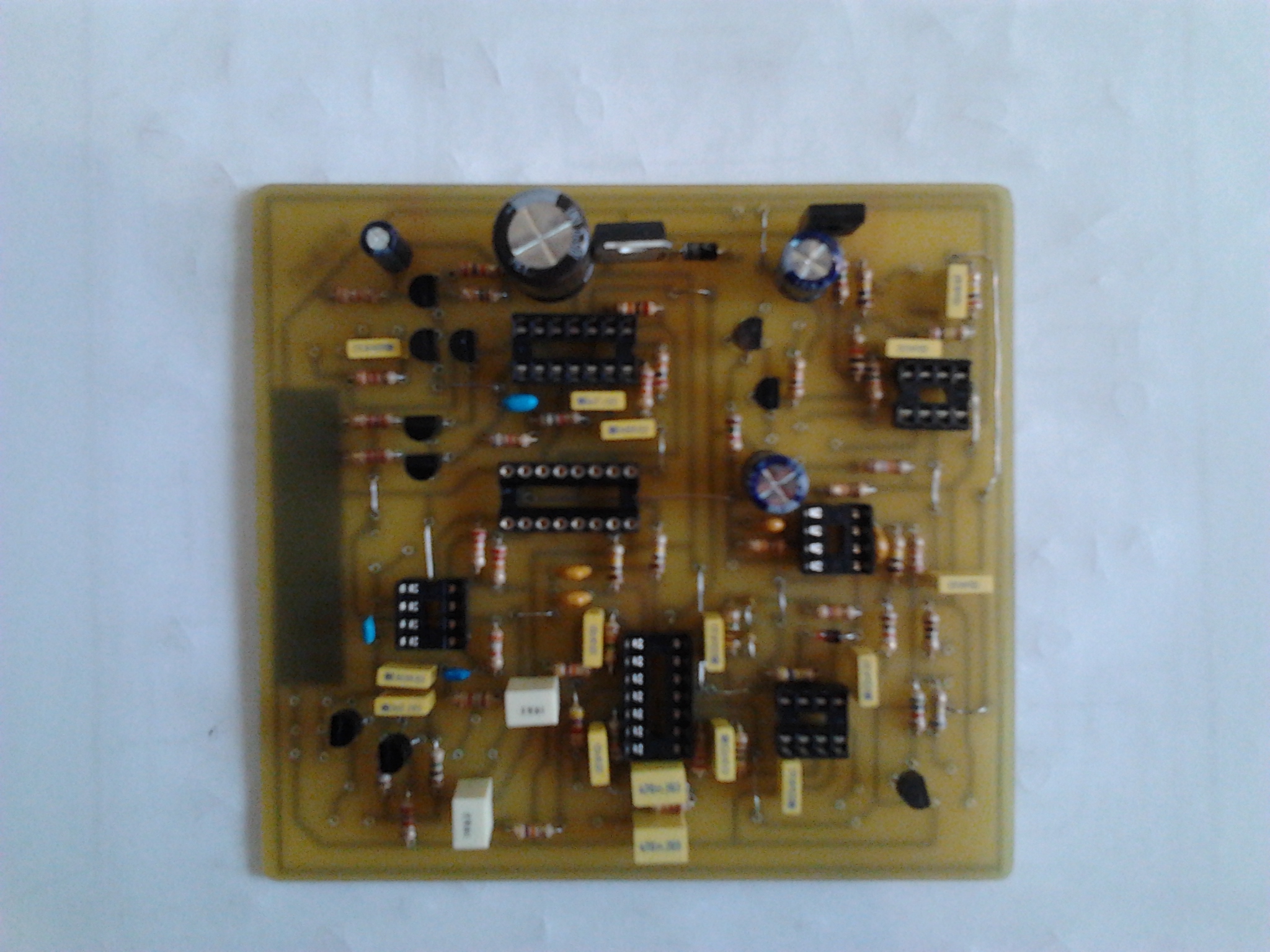

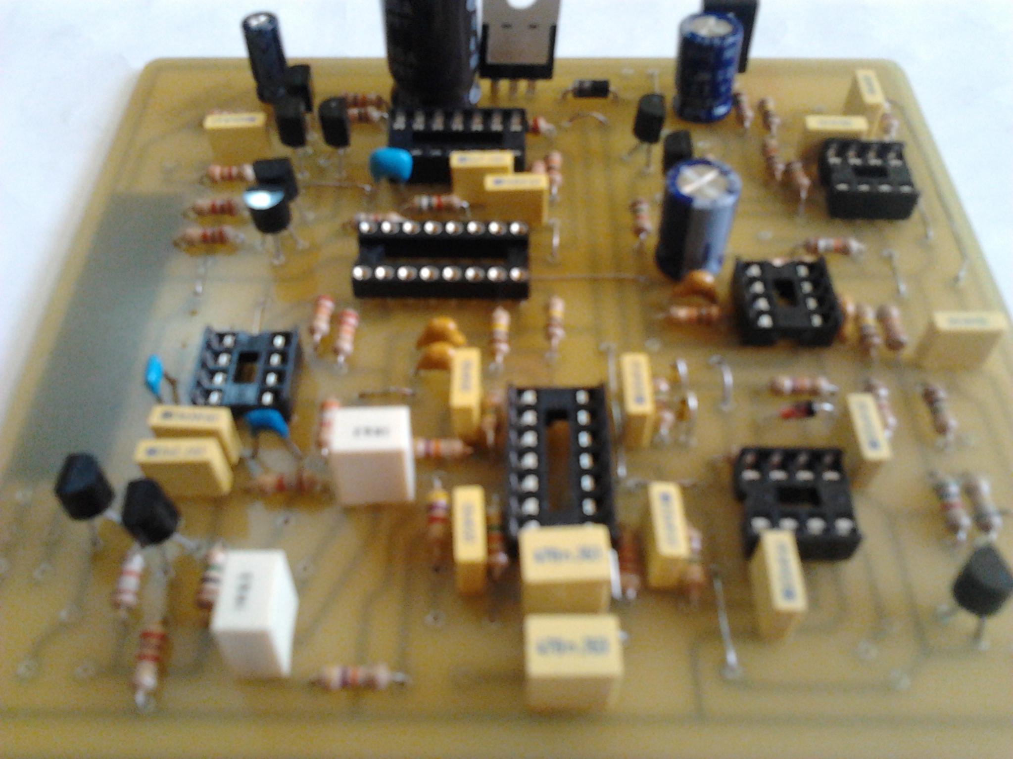

            • Here's my card. Which potentiometers to put on the front panel.
              • Disc and Sens.
                • Only I put them on the front panel. Others how to adjust.
