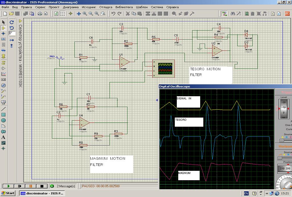

      • Comparison of two types of signal motion amplifiers.Click image for larger version

        • Try Tesoro WITHOUT C4
          It is responsible for the odd delays and shortening the pulses in response of Tesoro motion amplifiers, and actually has no function that you'll ever miss. Without the C4 it works dead-on, just as it is supposed to.
          Magnum has no compression, and I don't like it at all.

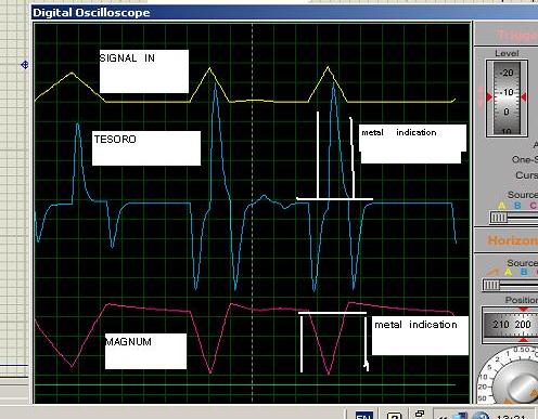

          • Magnum heard signals with no delay.Tesoro make three signals. They hear second.This leads to gaps in the ground.
            • Metal indication time diagram.Click image for larger version
              • Very true, but you did not try to extract C4 and see what happens with Tesoro after that

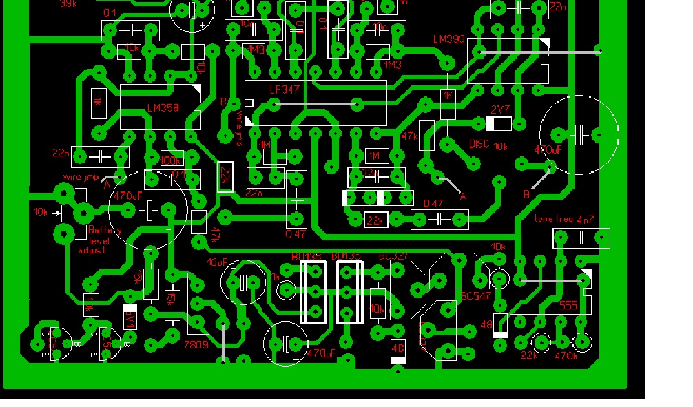

                • Ivconic can you send me a correct version of the board 555. I do it because I see my moshten.Tryabva metal detector for ferrous metals only if you can recommend me another option and I'm grateful.
                  • Achieving Fe discrimination is easy - you just reverse the pins 5 and 6 of a comparator to set discrimination phase for Fe.
                    • Originally posted by emoxristov View Post
                      Yes.
                      Here it is:
                      • Thanks a lot can you upload the following scheme for BC547 will EBC. Antenna and data.
                          Emoxristov you should read this thread from a start, already is explained well.
                          BC547,BC327 pin assignment is always CBE.
                          Coil ("antenna") can be Tx=1mH, Rx=15mH. Tx cap is ~ 470+47nF (parallel).
                          Also Fisher coil can be used, 2.2-2.4mH for Tx and 9.6-11mH for Rx. Tx cap is ~220nF.
                          • Thank simply LAY file you sent me below is seen how they put tranzistorite.Shte temata.Blagodarya read again for the help.
                            • Ivconic , Really transistors are located at the bottom of the board.
                              • Was it a question? Not sure that i understand well!?
                                BD135 and BD136, ECB pin assignment
