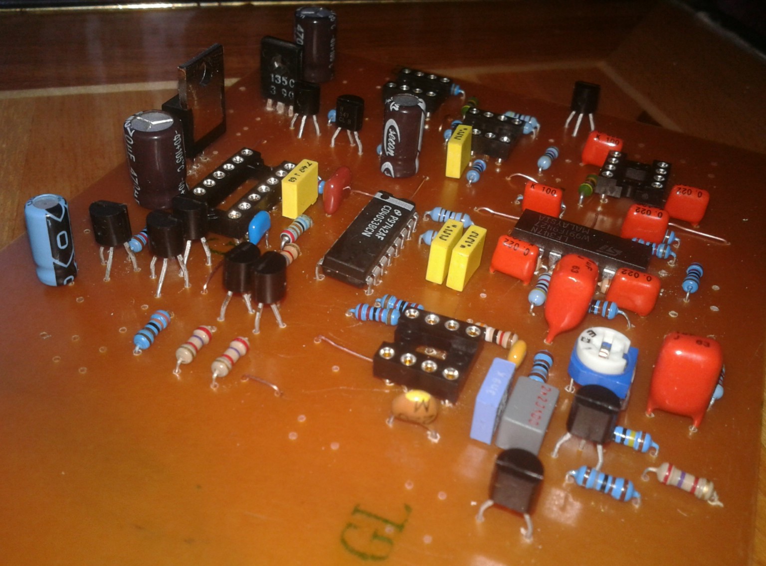

  • hi to all freind I built smw but it does not work well.No sound in output.When I moved to the point where the voice coil is similar to the noise.I've connected to before zener diode 2.7v a beeper.work with beeper but very little depth.I can not find the transistor mpsa13 and bc517 Instead they put bc548.Where is the problem?
    in transistor bc548 that replace with mpsa13 ?Or elsewhere in the circuit.?
    Please advise if you have to replace the transistor forms.Please introduce a number of transistors.
    best wish

                    • post # 105 pcb drawing you can see regulator 7809 and diode 4007.
                      if you look schematic post #107 regulator is 7805 and diode 4001.
                      Which one is correct?
