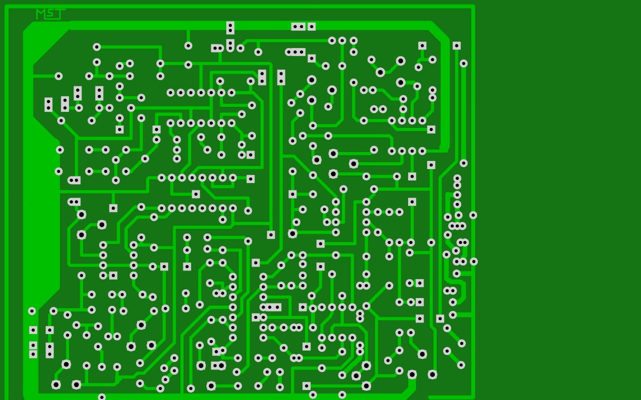

                        • hell mst
                          any news on this project, does the layout work for you?#can you post the missing files for making a pcb
                            hell mst
                            you my maiı sound simülasyon ltc 1044 switched-capacitor voltage converters 2n2222 ...bc547...2n2907 coin hawk trshl and voice....ok..
                            • could provide the scheme pdf
                                This is basic pcb. Tested and accurate.
                                hello can anyone tell me what is the real size of this PCB in cm or mm.
                                Thanks...
