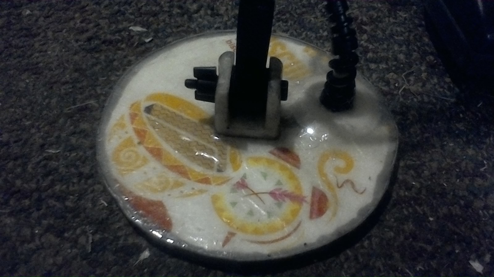

      Did not use a shell for my last build. Coated some card for the shield then fibre glassed it above and below the coil.

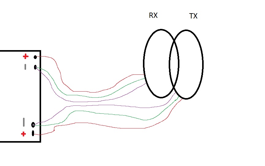

                        • I finished my smw, i got average depth, about 36 cm for 1 eoro coin. Good thing is that the detector is rock stabile, no instability in room beetwen wifi router and power sources in my house.
                          Discrimination is near perfect, hot rock fully rejected, ferite rod and nails. Here is my connection for search coil, from head to pcb.
                          All wires going separate from search head, at the and of cable ( in connector) shield for TX going togheter with TX minus, the same thing with RX.
                          Red wires are hot connection's, green are minus, and violet is shield.

                            good resalt CDI
                            What is the version you build?
                            can you put a pic of your circuit board
                            and coil informations (diametre turns & inductance)?

                              Hi totob, my pcb version is from ivconic, with 555 timer.
                              Coil parameters i can tell only for RX, cause TX is finished long time ago, inuctance is 1.03mH, resistance 3.4 ohm. Not remember how many turns and wire diameter, but somewhere between 0.45 and 0.55.
                              RX 175 turns, 0.25 wire, resistance 30.8 ohm, 15.09mH.
                              TX capacitor 480n, RX 62n.
                              Similiar coil parameters like Minelab Musketeer coil.
