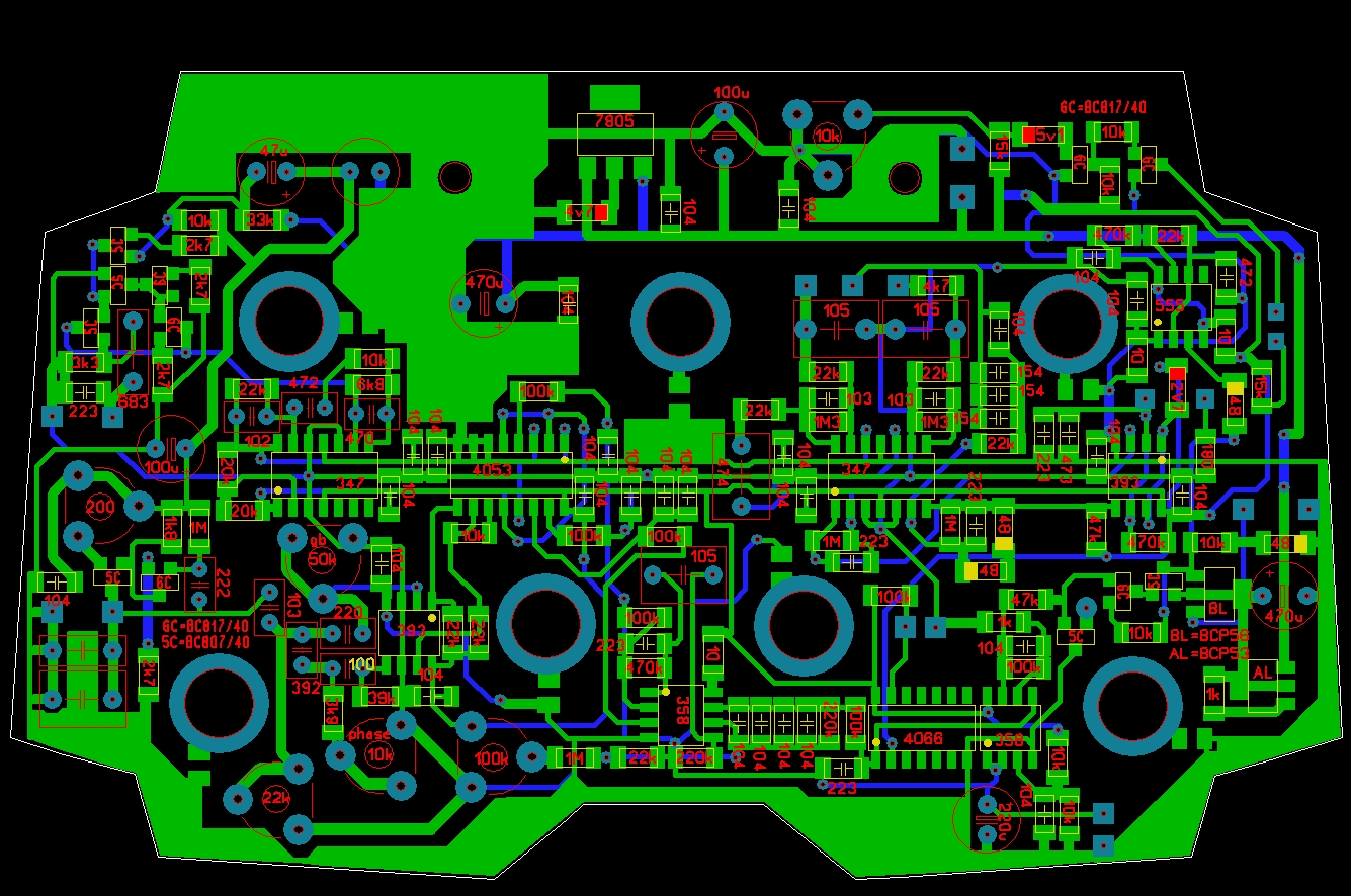

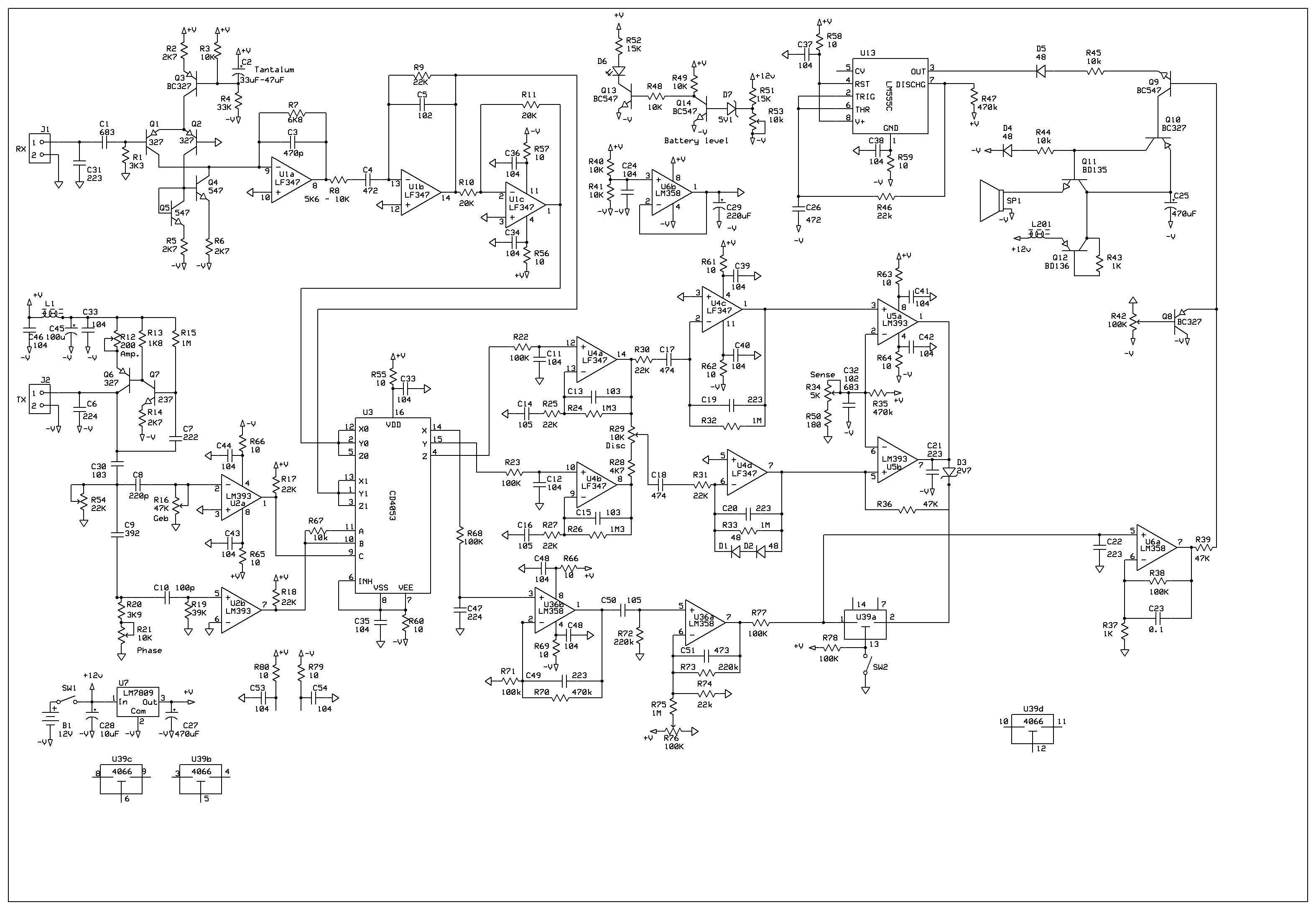

                    • Let's refresh this with new updates;
                      SMT, pinpointing feature, adapted to suit smaller enclosures (Bulgarian made enclosures, like at newer Golden Mask detectors)...
                      • CD4066 is having spare pins, so later this winter i plan to figure out how to engage those and extend this circuit with extra more features...
                        In meantime any of you are free and welcome to make own changes and mods.
                        This circuit can be modified to work at 15kHz.
                        Davor gave important suggestions about that.
                        Point was to use the same pcb design and not to change it much.
                        Later this winter i can disclose the rest of that work...

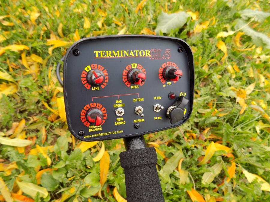

                        • This is or no
                          • Originally posted by bandito View Post
                            This is or no
                            [ATTACH]37727[/ATTACH]
                            No. Terminator is based on Magnum.
                            Look for the details at "Magnum on steroids" topic.
                            • Very good job ivconic,keep only so,This board checked Is errors,Is it tested if it works
                                I made prototype in March, earlier this year. Tested, checked, working alright.
