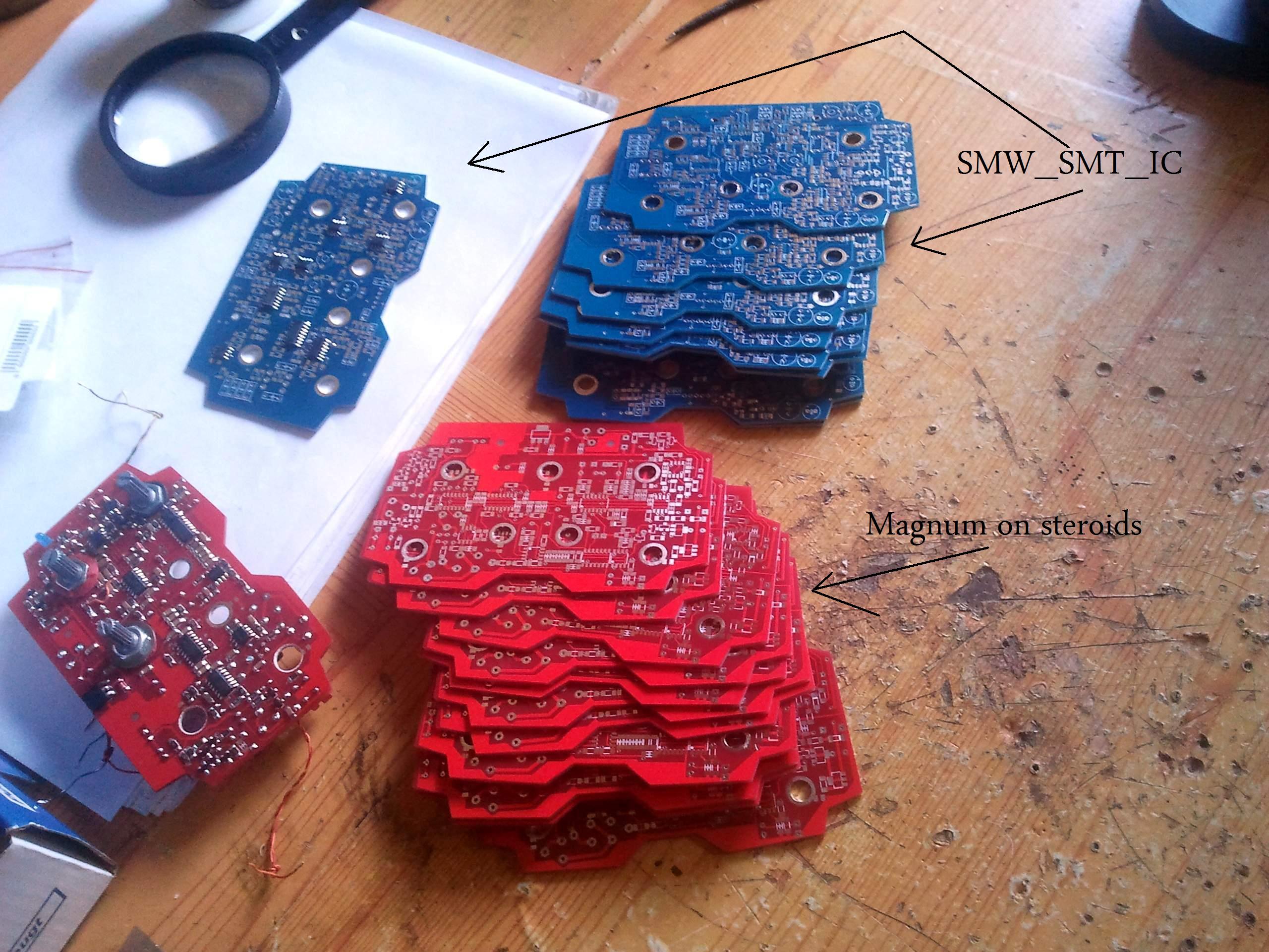

  • Here is the only photo i made than:
    • To order boards and then to readjust
      • Sorry! One small mistake!
        I reversed the texts on that photo;
        "Magnum on steroids" is for the blue pcb and "SMW..." is for the red pcb!

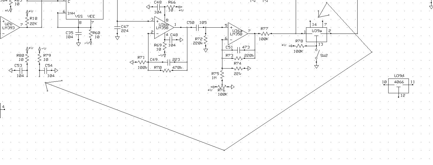

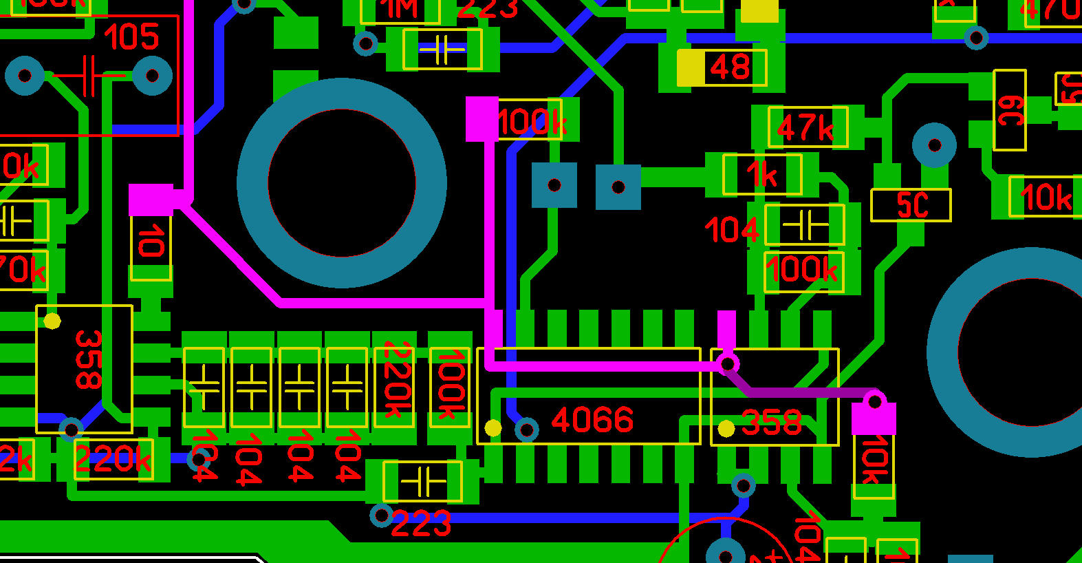

                    There appears to be another omission the 4066 has no power connection.
                      Yes it has:
                        Yes it has:
                        [ATTACH]37737[/ATTACH]
                        Not on the schematic.
                        • And again; yes it has on schematic too:
                          The reason why it is displaced on schematic is because i am making a room to put new components there.
                          Like i previously said; i am planing to engage spare 4066 pins and to add new features later.
                          Knowing the power pins and wiring at such basic component as 4066 is; should be elementary common knowledge.
                          Some CAD software even don't offer you power pins on basic sketches, taking exactly into account the fact that it is common knowledge and is automatically done without saying.
                          Neat and nerdy approach will not make successful builder from one, nor will guaranty good working unit.
                          I always was pretty much scared... horrified from such approach and from splitting hairs on most trivial things.
                          But... that's me...

                            OK , I see but without labels its hard to associate those r's and c's with the 4066.
                            • Ok, no problem, you are right about present state of schematic.
                              But i missed to emphasize that this is still "alive" thing, in process of changing and improving.
                              The way it is now; it may be made with no fears, it will work nice.
                              But it is not finished project, lot of nice little things can be still done on it.
                              Do expect that this schematic will change more in nearest future.
                              What i am trying to achieve now is to do the changes but to keep the same pcb design... as long as it is possible.
                              Because drawing completely new pcb is somewhat tedious and painful job, especially in SMT.
                              And especially when old one is already proven to be alright.
                              But main reason is in fact that i can't do such pcb on my own, here at home.
                              For more dramatical changes on pcb: i shall start producing quite new series at Elcrow... as i said; tedious and painful!
