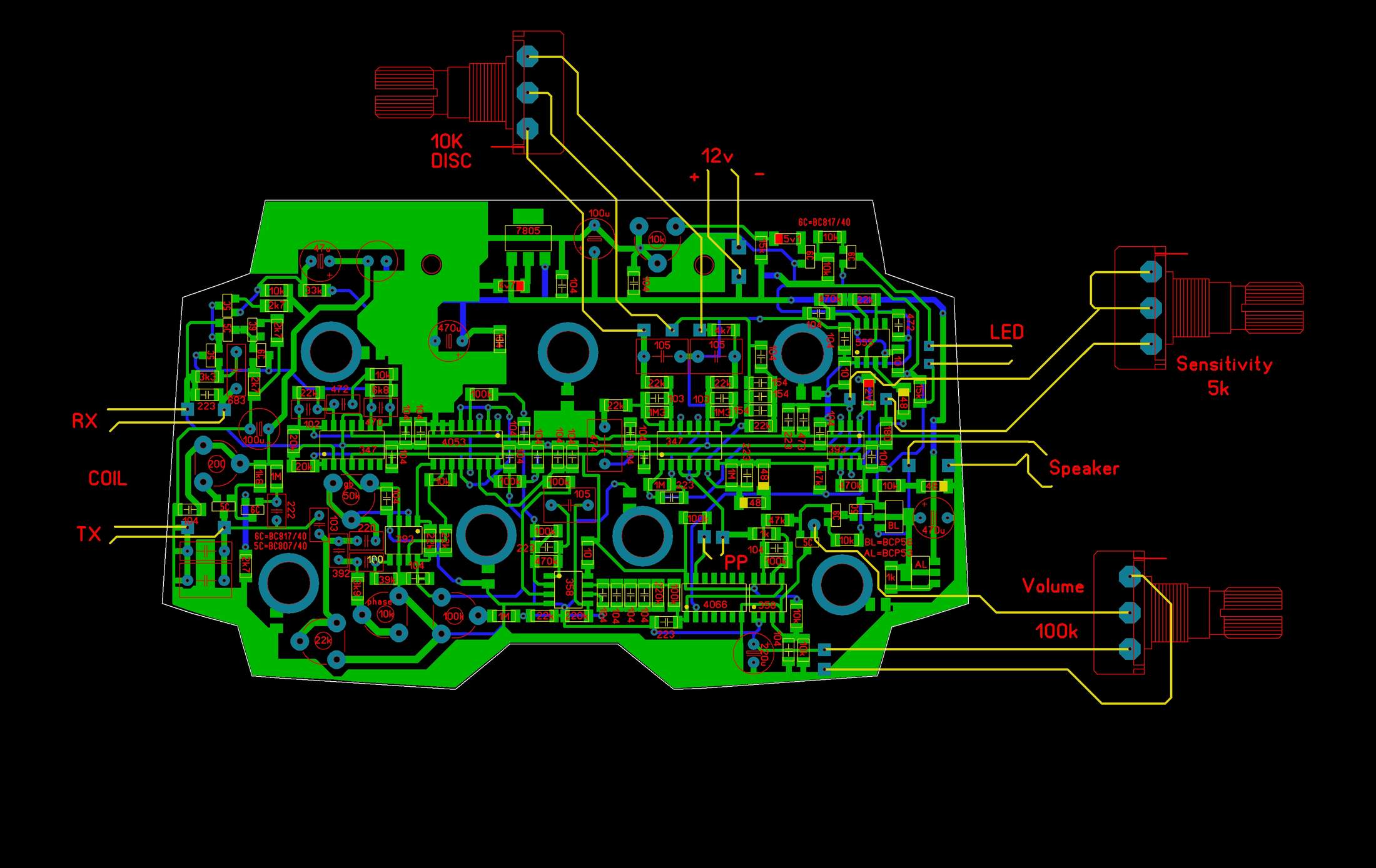

  • hi how to connect coil , speaker and pots help me please..Click image for larger version

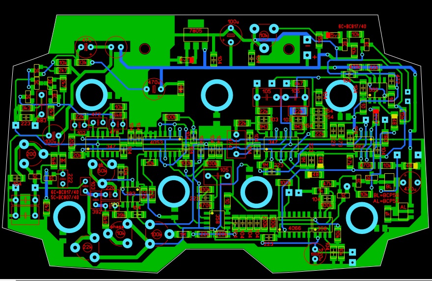

      Originally posted by eduardo1979 View Post
      OK
      These files you checked.The layers correct you or as Magmum on steroids

        hi how to connect coil , speaker and pots help me please..[ATTACH]38078[/ATTACH]
        • THANKS for help me ivconic

            • Can anybody share files on the board in Gerber format.I think those who are in the forum are wrong as Magnum

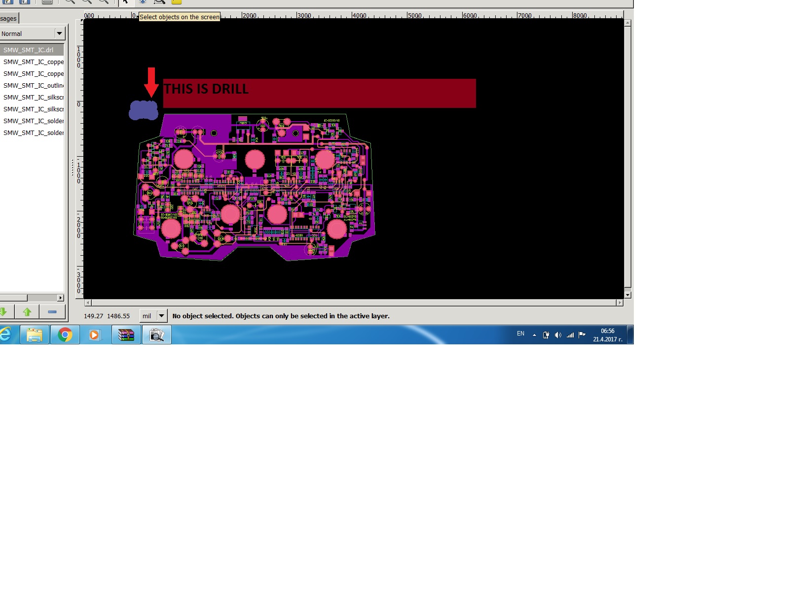

                  • I have a problem.When generating gerber files,drill file Only one big point comes out.Can anyone share gerber filesClick image for larger version
                    • at another Project i had this too, but pcb manufacturer in China found nothing wrong- all pcb i got were correct
                      you ca send files to pcbway the can proove files immediately, the tell you if something is wrong
                      btw. which Version from this thread do you use? link the single post- i can check files for sure

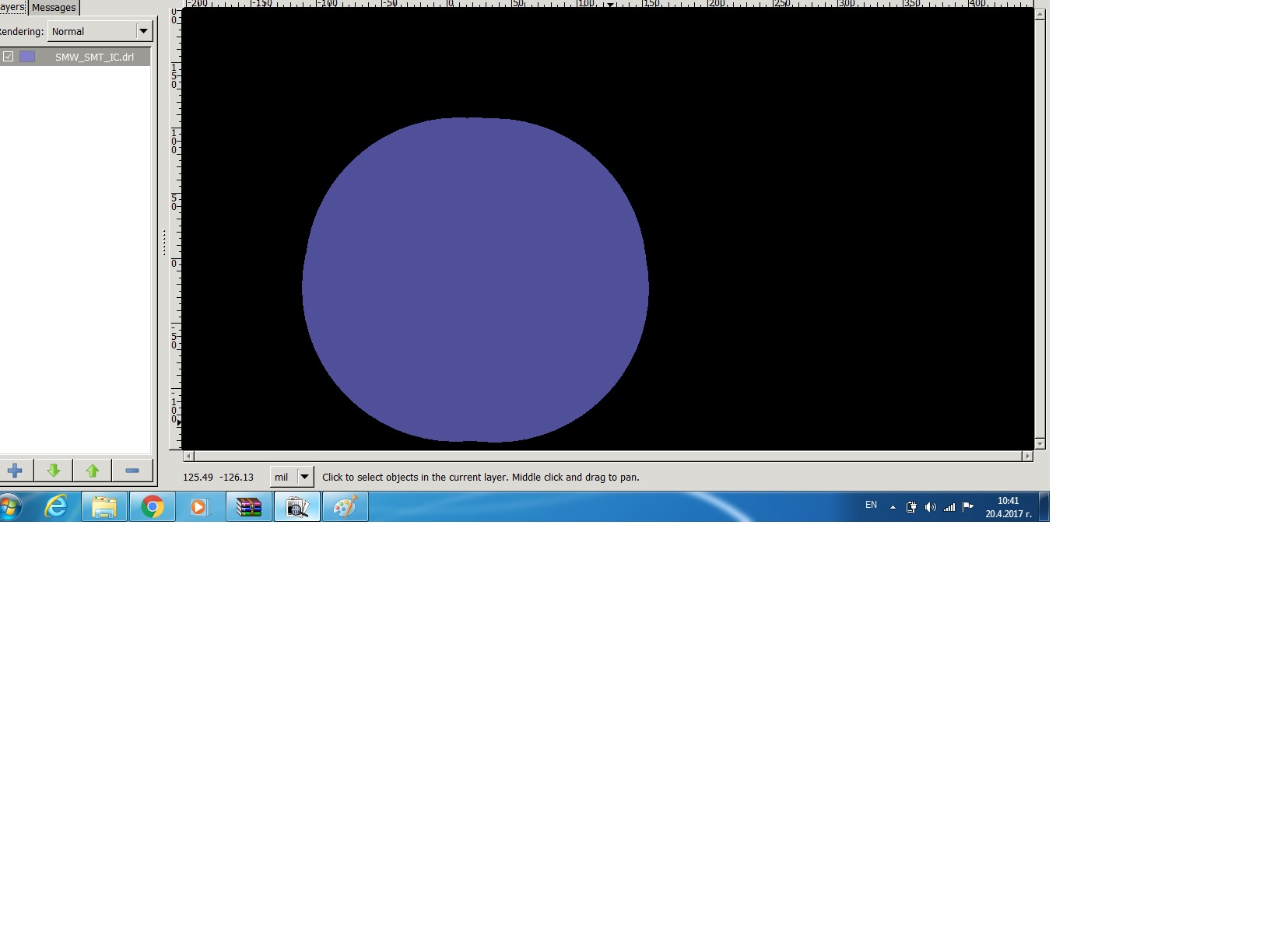

                      • This file I generated.If you can share the production files(gerber).10x

                            I can see that.You have made an order for these filesClick image for larger version
Name:	error drill.jpg
                            • Originally posted by bandito View Post
                              I can see that.You have made an order for these files[ATTACH]39554[/ATTACH]
                              The error is in the program I use

                              • as i write before, manufacturer can handle this "wrong drill file"
                                Problem is just the visualisation in program we use
                                i dont make this pcb, for this design you Need a professionel pcb
