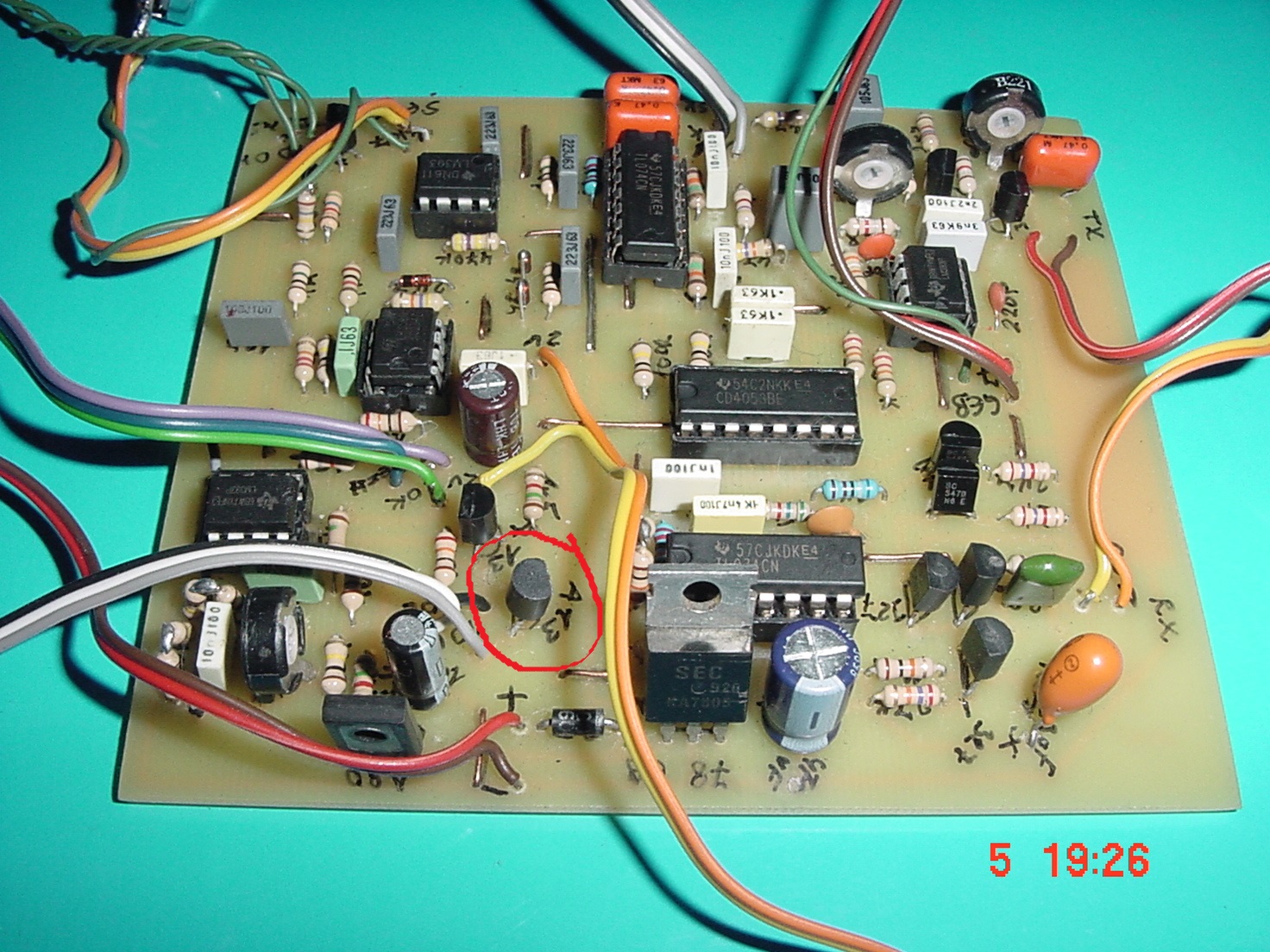

          What is the detection range you reached it in both version?
          my detection range is not good. 20mm copper coin just 25 cm with descrimination. also there is critical point in frequency potentiometer . if you adjust it slowly to get point where the audio becomes softer without cracks.
          i think i will try with 555 version i hope i get some improvement.

            SMW v 2.0
            The largest range on the coin is 12cm, on a larger object up to 15cm. and without discrimination, and I tried all the steamed transistors and changing IC circuits, only that my PCB is something wrong.
            The 555 plates work perfectly and the depth of the coin in the earth about 30cm. and discrimination very good in the range of factory detectors. Coil is my manual work.
            • crni1
              your depht with v2 it is very poor
              Check the rotation if it is transistor MPSA13

                    • Not Totob has been replaced with BC 547 but no difference.
                      Maybe something else.

                        • СМВ 1.0 и СМВ 2.0 су суштински исти детектори, промене које сам урадио на СМВ 1 и вер.2-0 и имам мало боље резултате, новчић од 10-12 цм. веће ставке до 50цм. у ваздуху.
                          • crni1
                            in (smw v2) try to turn threshold pot to full anticlockwise
                            in my case i got better sensitivity (25mm copper coin detcected at 38cm in air) with 27cm coil.
