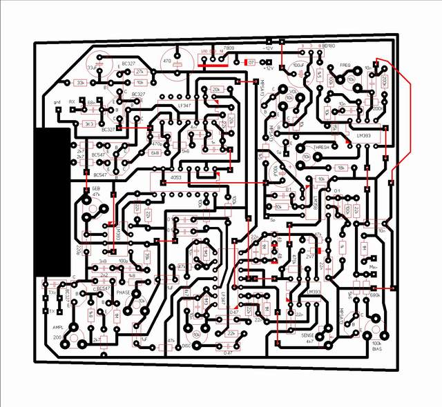

    Edit - What specifically do the "phase" and "amplitude" controls accomplish here? Also, what is U6b the opamp floating at the bottom connected to nothing doing (is that the ground reference for the other opamps?).
    I can not use name somebody else invented. It is strange , especially at this particular design. There are few "designers" who are trying to take all the credits for this design. One of those named it "Caesar". There is much antagonism among those few "designers" here in local. Provincialism, vanity....what can i tell? Most funny is fact that this "Frankenstein" actually is not original design at all. It is just crossbreed between White's Classic and Fisher 1225. Even than...this schematic originally came, long time ago, from Bulgaria - not from Serbia. I received original schematic 6 years ago from one bulgarian friend. At the time i didn't payed any attention on it.
    So...leaded by that logic and that bad experiences with local "designers", i simply refuse to call it "Caesar".
    Not only that, also i refuse to use "original" setup because of few major lacks it is having. "Original" "Caesar" or whatever, is made very poor and bad. Not working enough good. Handmade coils i have seen so far are very bad.
    So for all those reasons i decided to use only schematic as starting platform to improve and change and finally get something different and better.
    So...as long as i am concerned name "Caesar" is out of question.
    "Phase" is...phase! Ahahah! Simply as that. With that trimmer you can additionaly fix the phase at phase detectors.
    "Amplitude" is actally preset with which you can affect amplitude of TX signal.
    With that trimmer you can regulate voltage that fed into TX transistor BC327.
    In original Classic oscillator there is fixed resitor; at some 100ohms and at some versions 51 ohms...etc...etc..
    Replacing that resistor with 200 ohms trimmer you can fine readjust that voltage to shape up the sinus at TX output.
    Clear?
    "...Also, what is U6b the opamp floating at the bottom connected to nothing doing (is that the ground reference for the other opamps?)..."
    ATTABOY! Indeed.

            You have found supplier for those coils?What is the price?
            Can you see the changes I made around disc. pot?Is this correct?Also what are those spots in blue for?Some switch?
            I will try to find same coil on ebay.
            Oh ...that is just part of 1265/66 audio stage i excluded from schematic... Never mind. Don't pay attention on it.
            • #96
              Ok.So I just skip those?
              Can you see the green lines that I changed around disc pot?
              I think that they should conected this way.According schematic.Because I saw this mistake yesterday when tracing pcb.
              Or I am wrong?
              • #97
                Or I am wrong?
                YES! You are very right! But PCB is accurate - schematic is NOT!
                I will correct schematic asap and post it again.
                I made that mistake in a hurry. Switched pins.... because i used old schematic to redraw new one with another audio...
                So..respect pcb, it is accurate (made and tested)..
                Thanks and Regards!

                    • Hi,
                      Ok.So schematic have mistake.
                      But because there are no labels on parts I begin to trace.I now that pcb is acurate.But cant figure out which part is which.
                      If you have labeled view please post.
                      Don't bug your self with those fulls!Those are just provocations.

                        • Originally posted by Ultimate_Haze View Post
                          Ok for private thread idea.
                          You have done great work.
                          See you
                          Ok i will put labels on pcb today. I will post it here later.
                            There is no reason, my friend, to go on restricted. Your work is the best answer on provokative posts. Dont waste your words for it.
                            Thanks WM6!
                            • hi ivconic
                              how much depth detect for coin and larg target Most Wanted"????
                              • Ok here is pcb with labels. Hopefully this will help..
