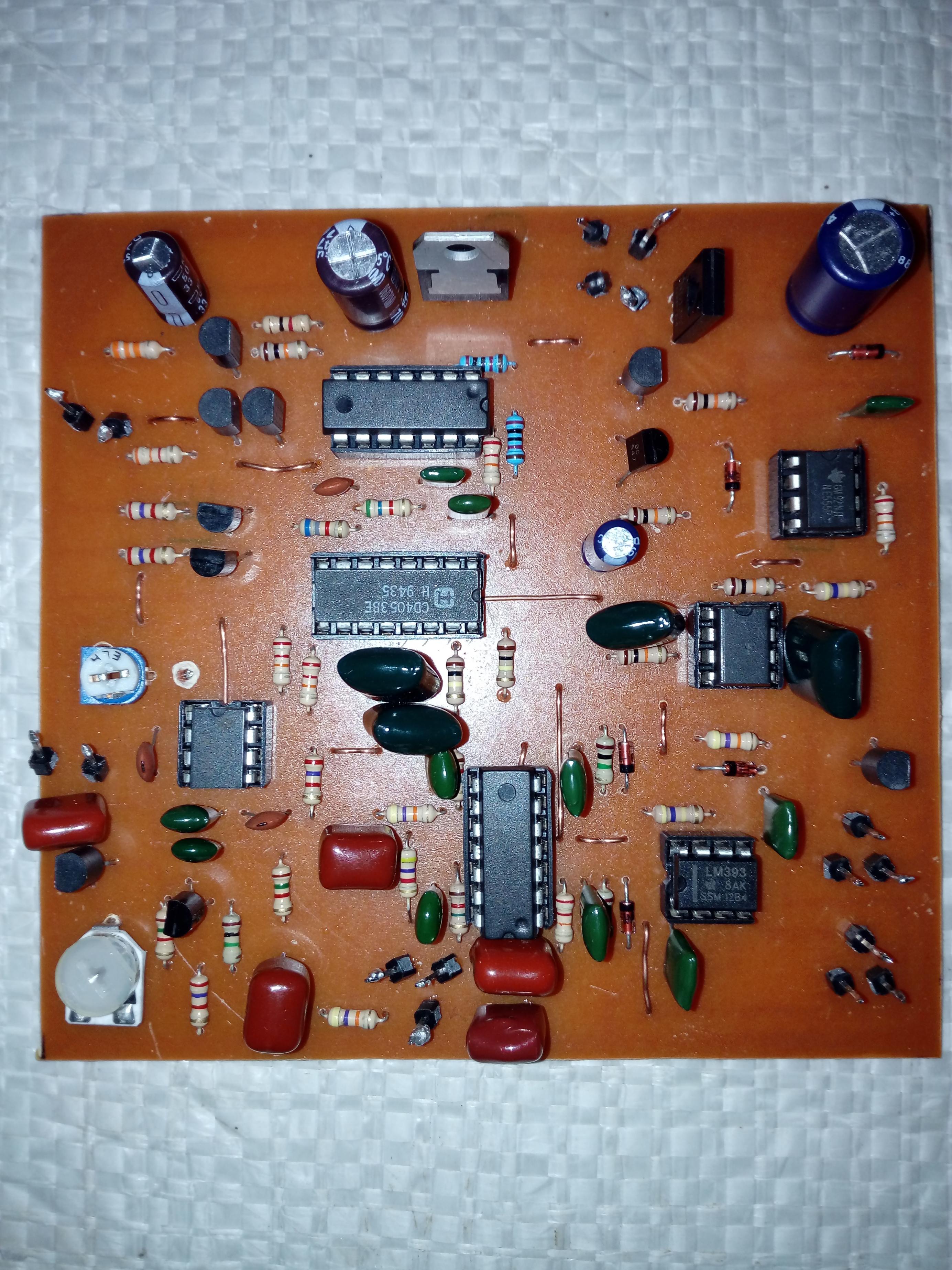

    Hello hooby life.

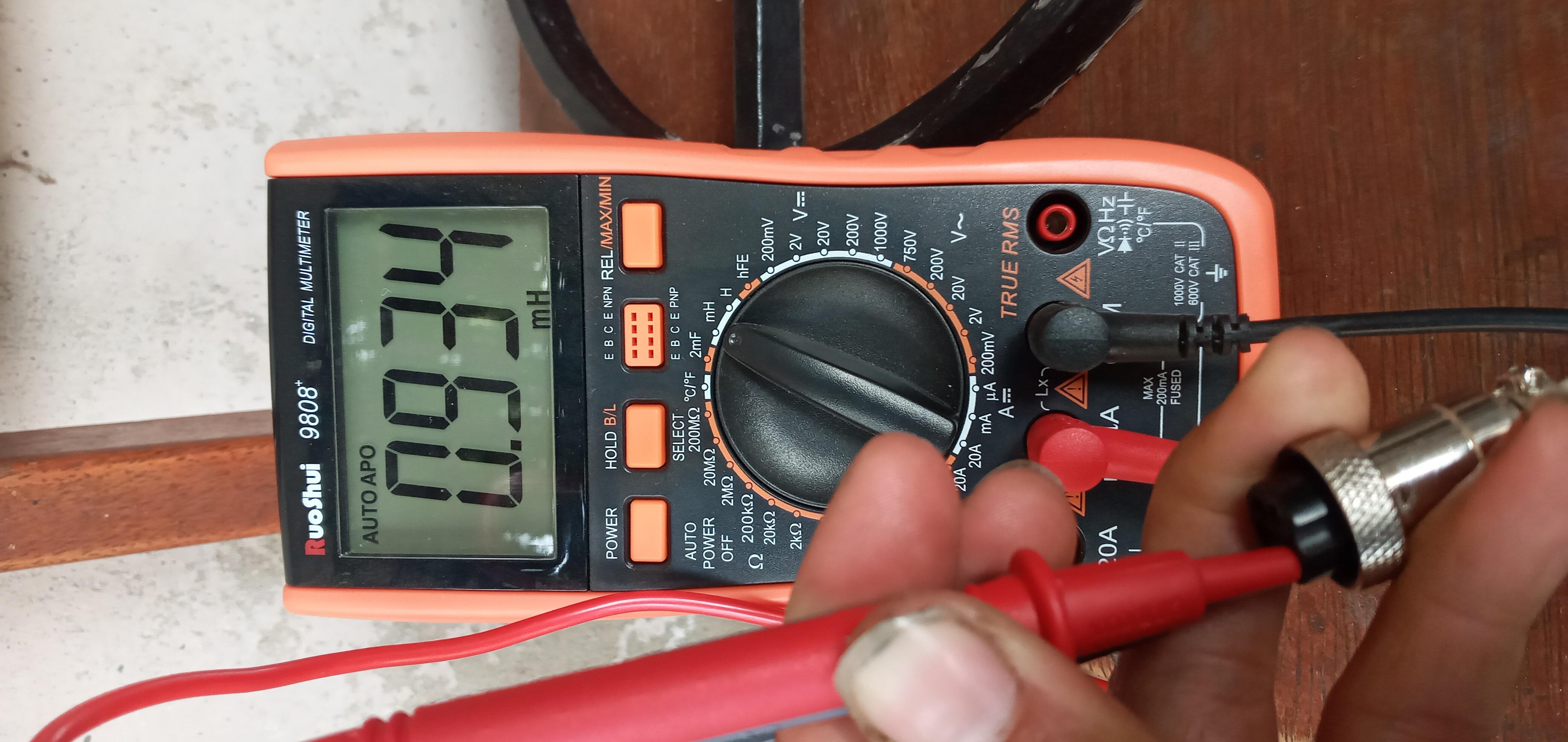

    My DD 27cm coil, TGSL mold I built it with the specifications of:
    Tx 1mH
    Rx 15mH
    And approximate frequency of 7.3Khz.
    I made this coil with an inductance meter that I built, with these specs:
    Tx = 43 turns, 0.45mm, 3ohm, 1.013mH
    Rx = 161 turns, 0.25mm, 37.2 ohm, 14.948mH.
    C1 = 68 nF
    C6 = 47O nF

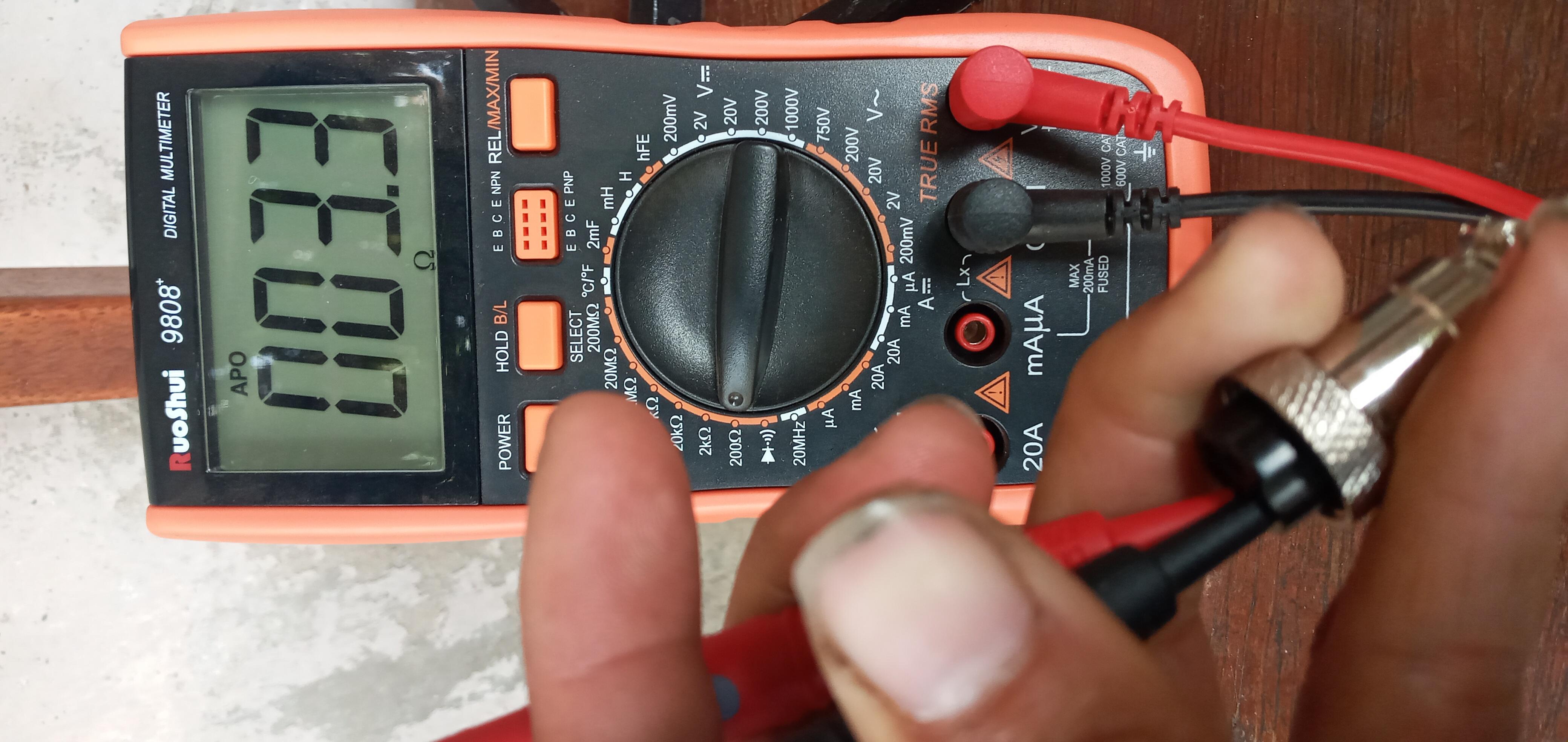

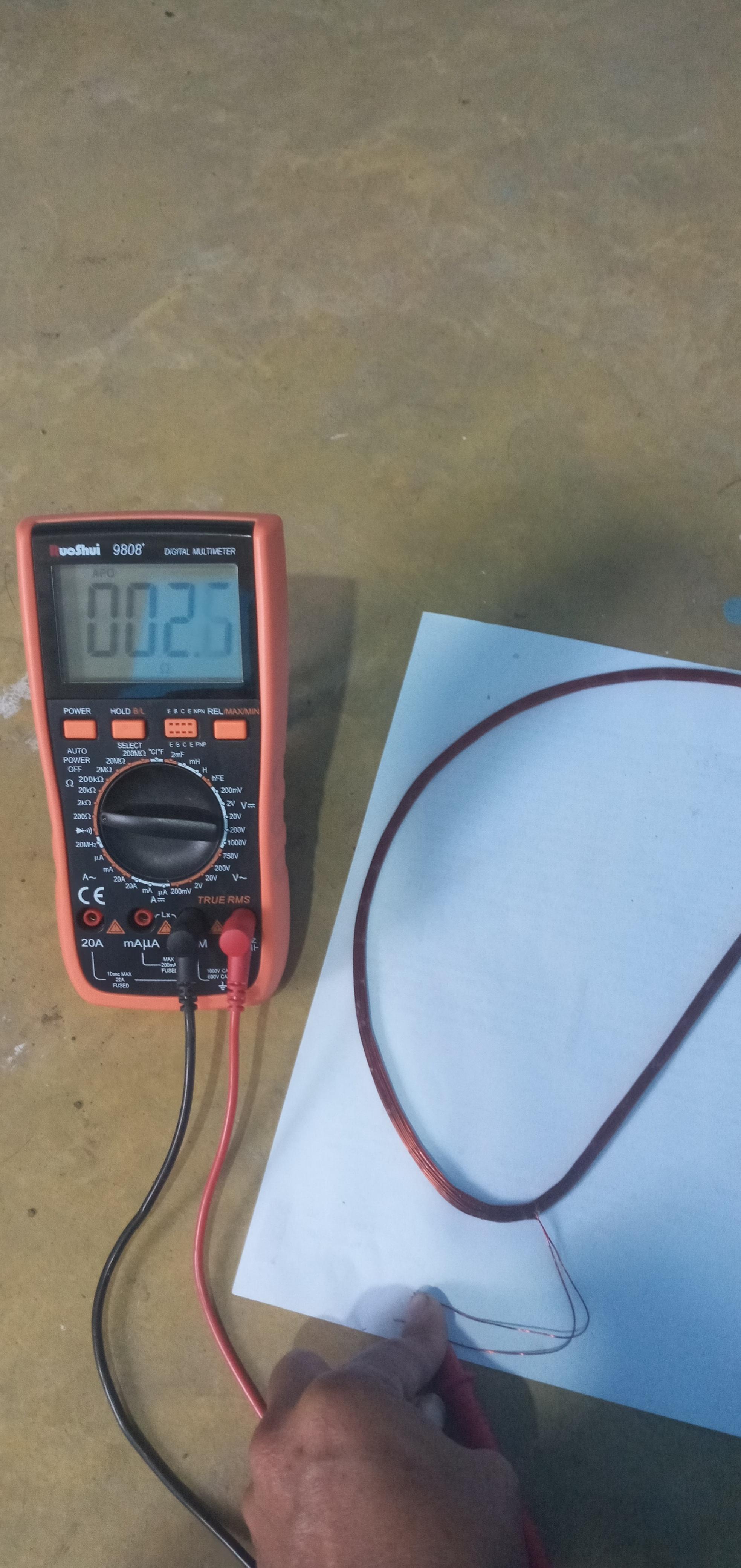

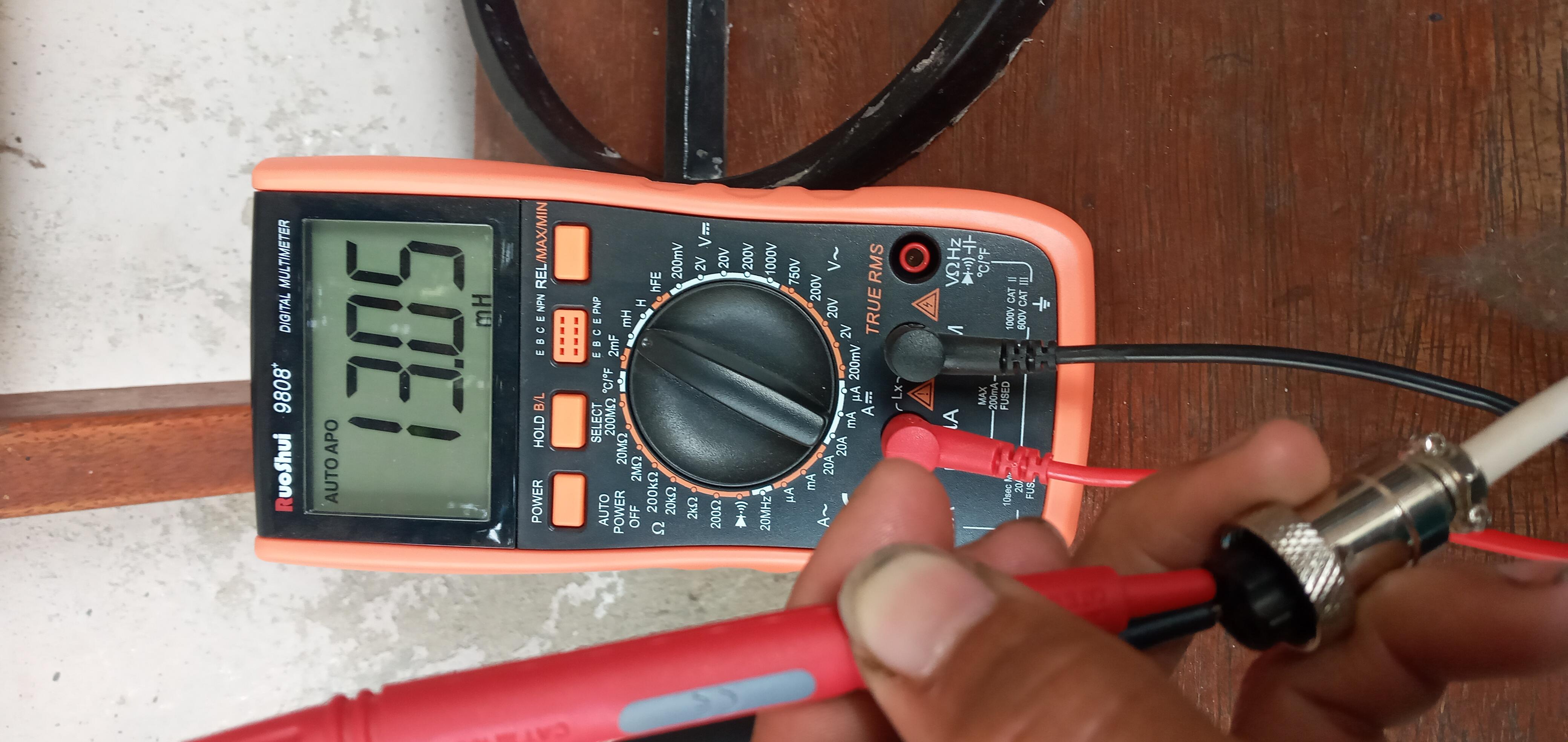

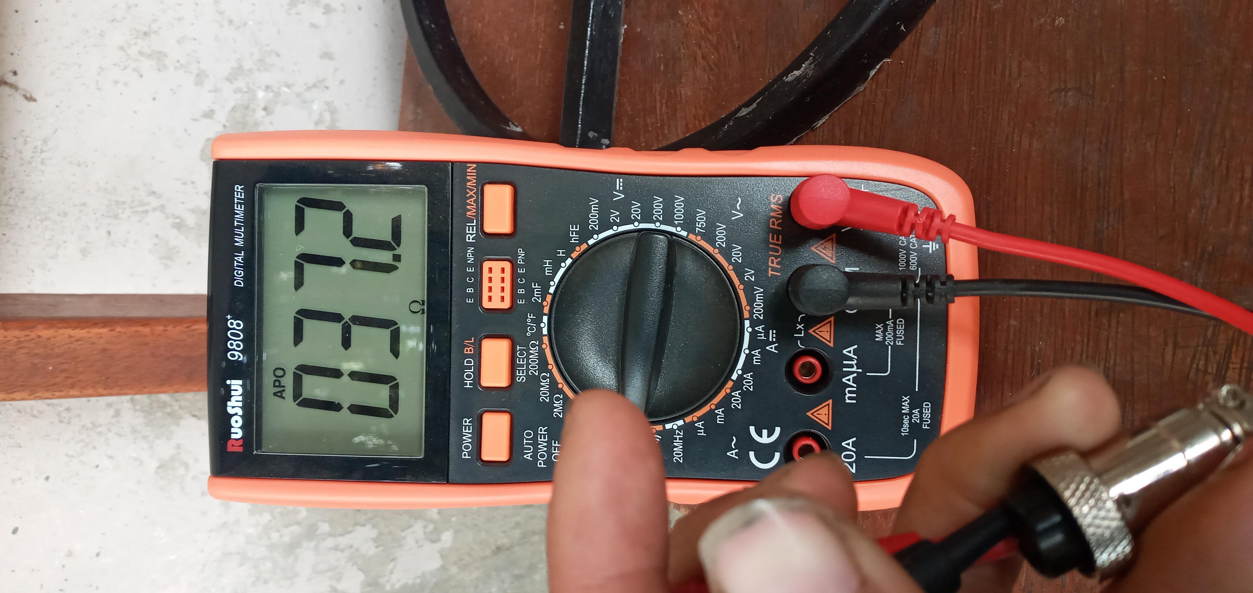

    At that time I did not have an instrument to measure inductance, but now I have received my instrument purchased from Aliexpress and I have measured my coil and it measures very differently than described above.
    • These are the measurements of my coil with my new instrument. And that must be the problem for which it does not discriminate.Click image for larger version

      • Any suggestions would be welcome!!
        • I am going to have to build a new coil.

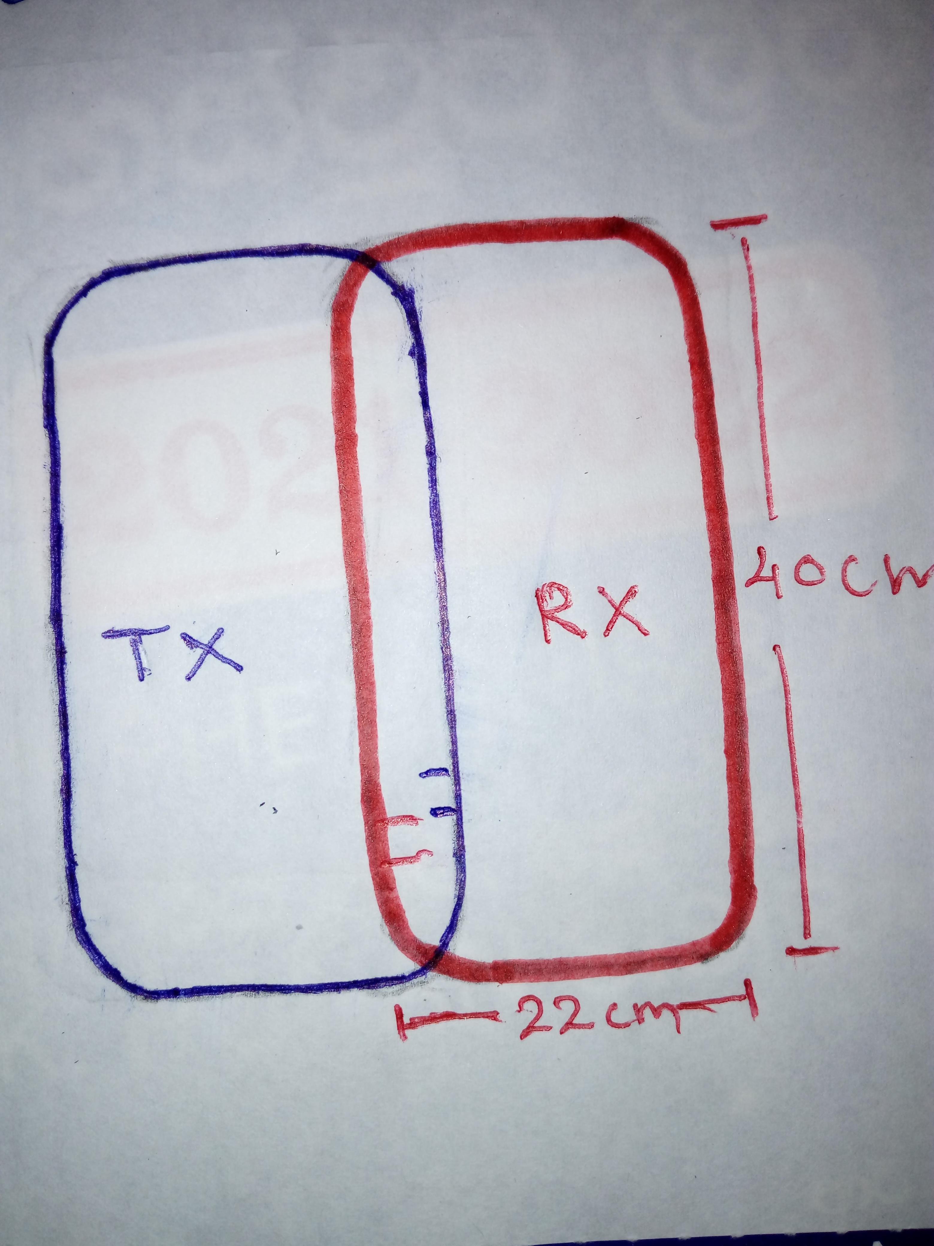

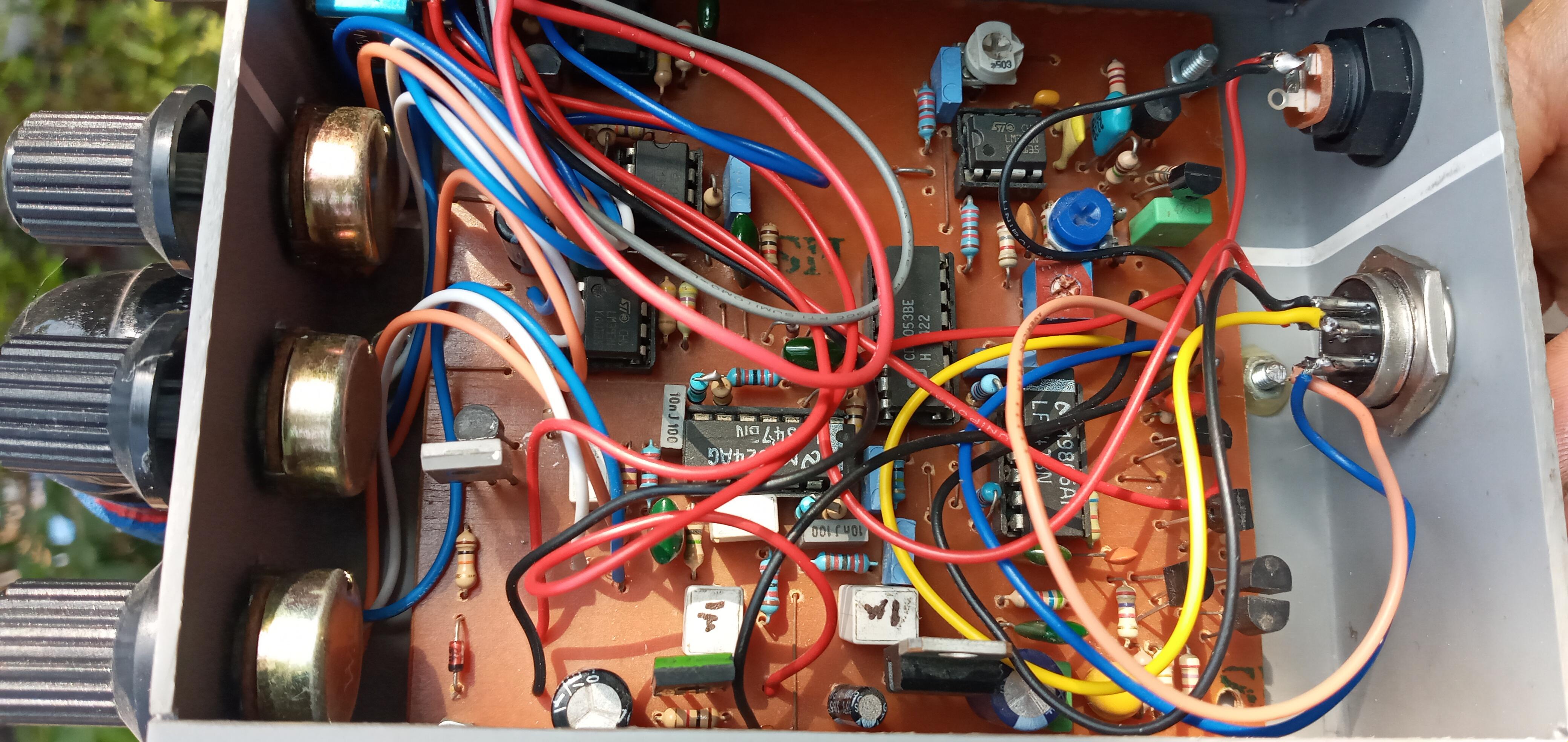

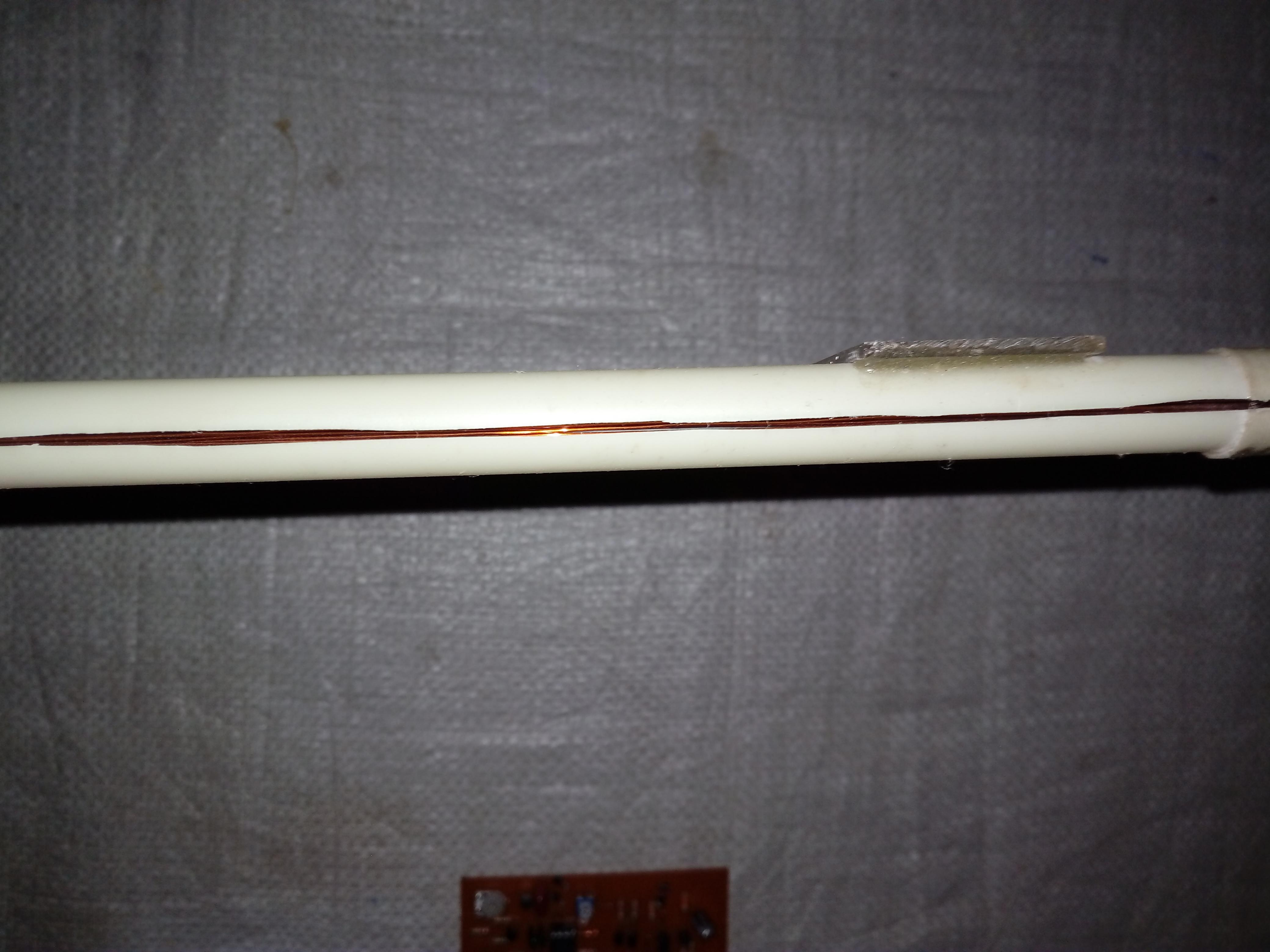

            • Dear my friend,
              Here the photos, if you want discriminate important think is coil mH value. if you made many many size coil you need to select tx 1 mH and rx 14-15 mH. HERE THE CHANGED RESISTORS
              PUT TWO RESISTORS 1K5 FOR 1K8
              2K7 FOR 2K2
              1M FOR 1M3
              DO NOT USE RX 22NF CAPACITOR
              sorry my coil is 40 cm *22 cm [one coil part ]Click image for larger version

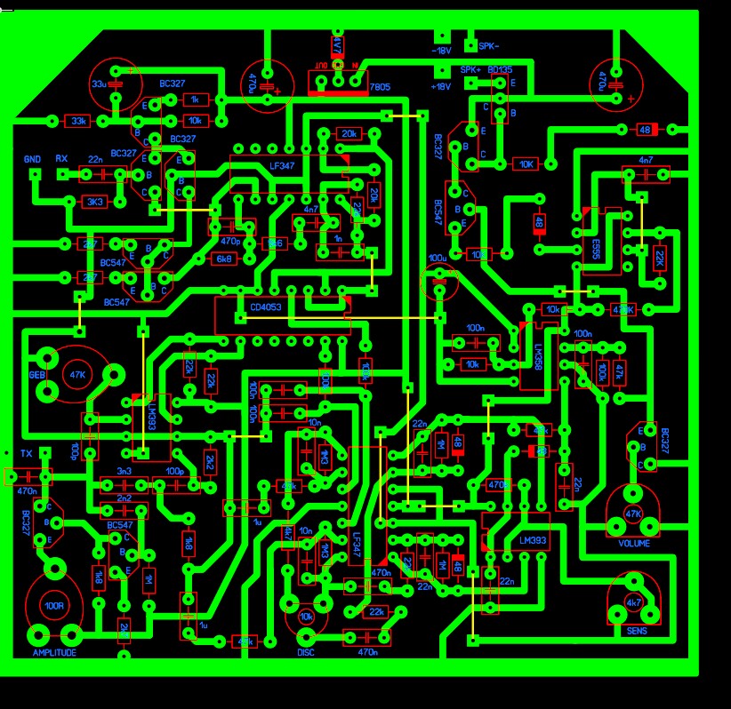

              • okay brother, i will try to help you , please tell me which thik wire [swg gauge ] did you use for TX and RX COIL and did you remove or change resistors and capacitors ? Also did you use this PCB pattern, Am i correct ?Click image for larger version

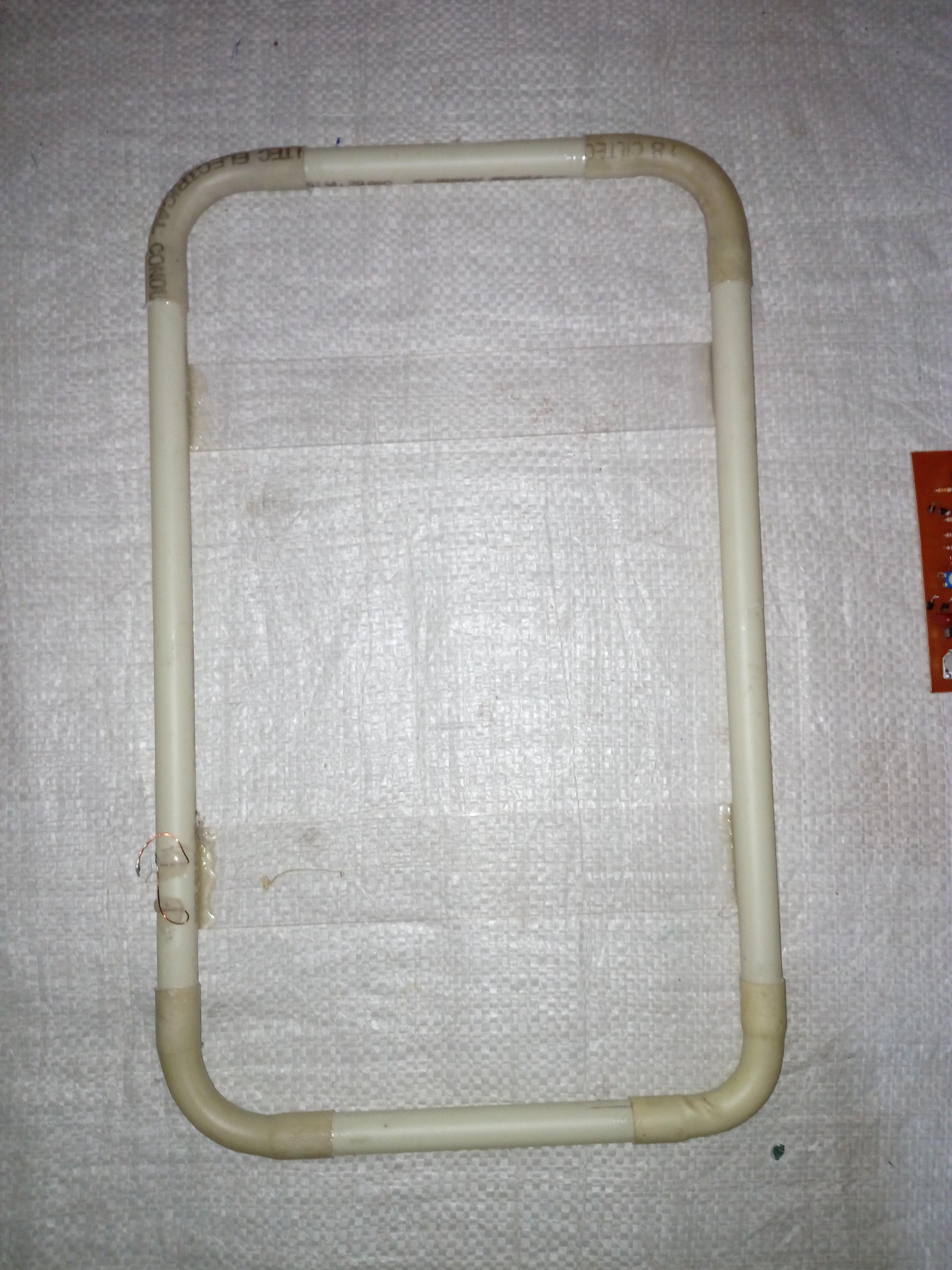

                    • Hello zakari and Ruben 2000
                      smw is deeper machine among all IB metal detectors. But discrimination is not good. If you want to good discrimination you need to make admiral metal detector. It's simple and cheap home made project. I use ruben's share PCB version. I t is good and super discrimination than other PCB version.some pcb version are not good. also i did not use RX capacitor. When i remove RX capacitor detector works well. Ruben2000 your coil induction value correct. I think problem is your pcb version or unbalancing coil. If you want good work IB md you need to good coil balancing and check the null point. I did not use coil pattern and coil cover because my coil is big.I made equiangled square coil cover using PVC conduit tube and bends. also not shield it.not ground test yet. i made it as a temporary coil because how to work to search this PCB pattern. Here the my coil pattern. It is simillar Russian volksturm coil pattern. Happy huntingClick image for larger version

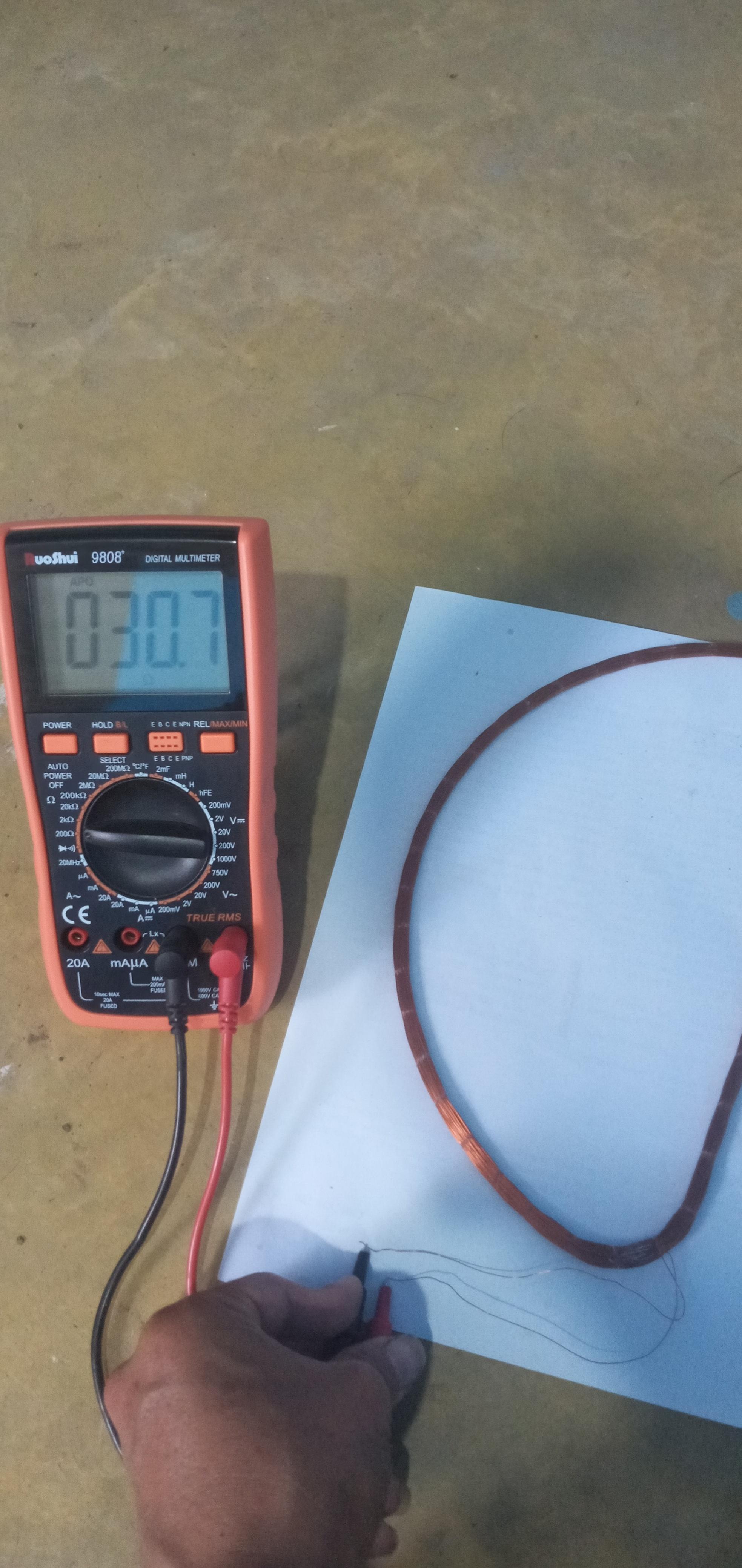

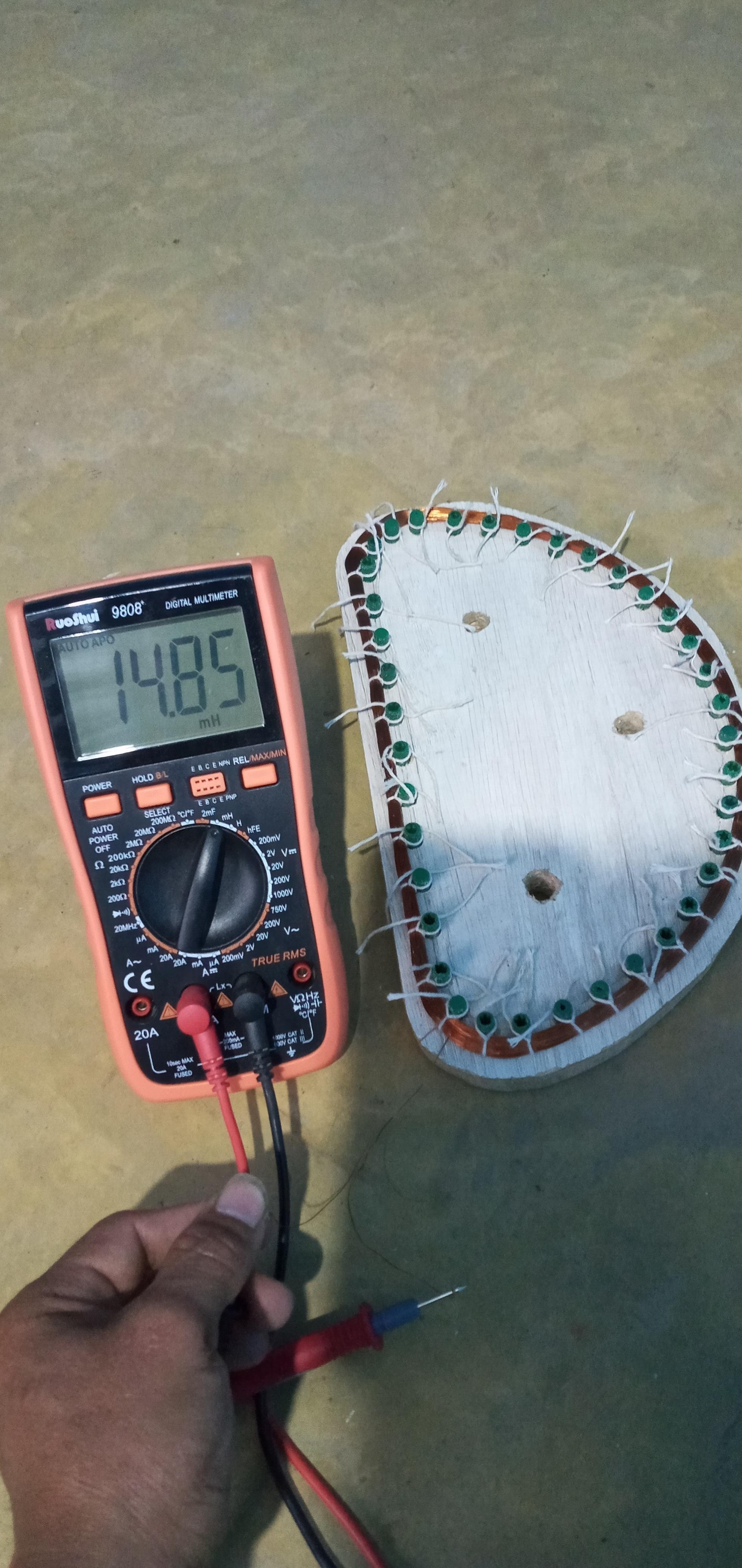

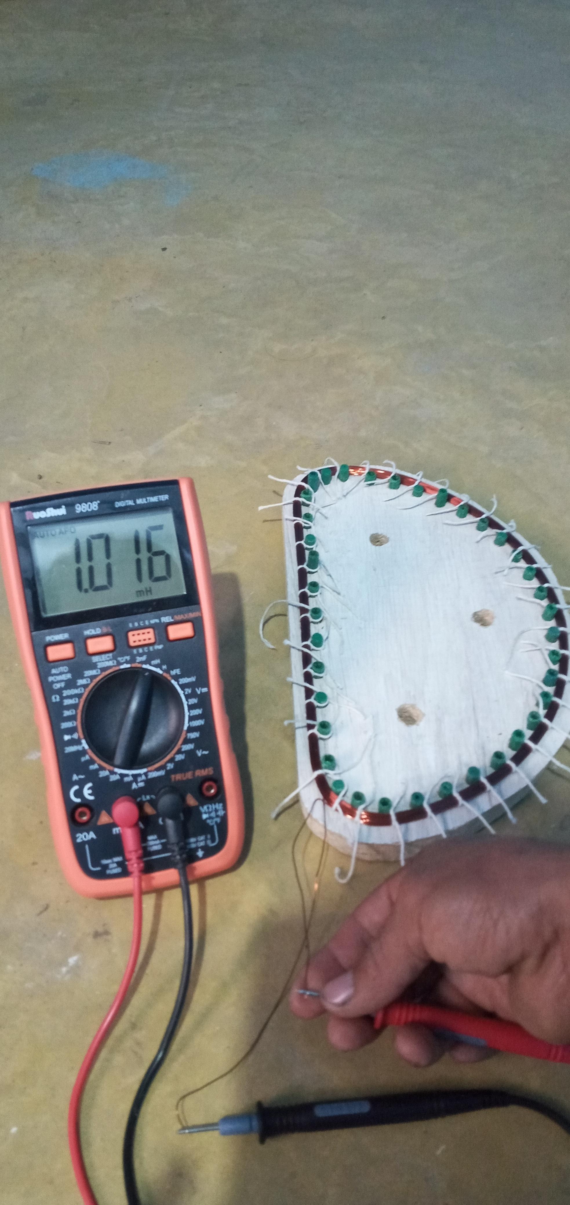

                            • This is my new coil with the inductance and ohms measurements. [ATTACH] 55193 [/ ATTACH] [ATTACH] 55194 [/ ATTACH] [ATTACH] 55195 [/ ATTACH] [ATTACH] 55196 [/ ATTACH]
                              • Details of my DD 27 cm coil. TGSL model.
                                TX = 45 turns = 0.511 mm.
                                RX = 171 Turns = 0.286mm.
