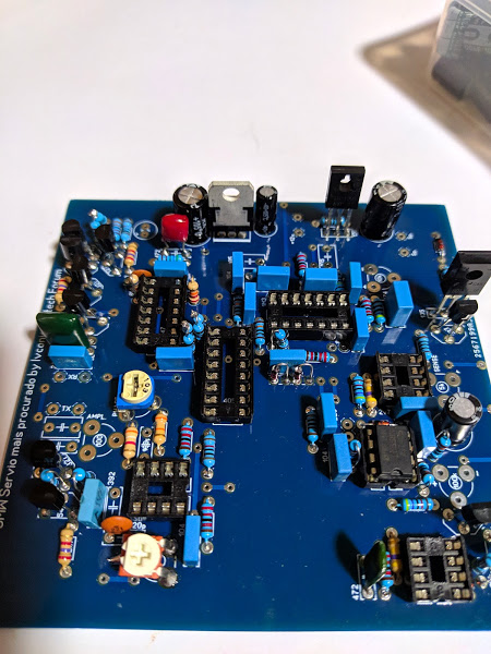

            starting SMW
            hello master Emersonpaz;
            smw detector what stage are you at?
            What should be the coil resistance, inductance and frequency values?
            Best regards
            Gurdal
            • Hello friend, I will follow according to Ivconic's specifications
              The TX coil inductance can range from 1mH to 2.2mH and resistance from 2.5 to 3.5 ohms.
              In the case of 1mH; the parallel capacitor is 474 + 473 in parallel.
              In the case of 2.2mH; the parallel capacitor is 224.
              RX = 160 windings, 0.27 mm wire
              TX = 70-75 windings, 0.45 mm wire
              In this case, the TX parallel capacitor is 220nF.

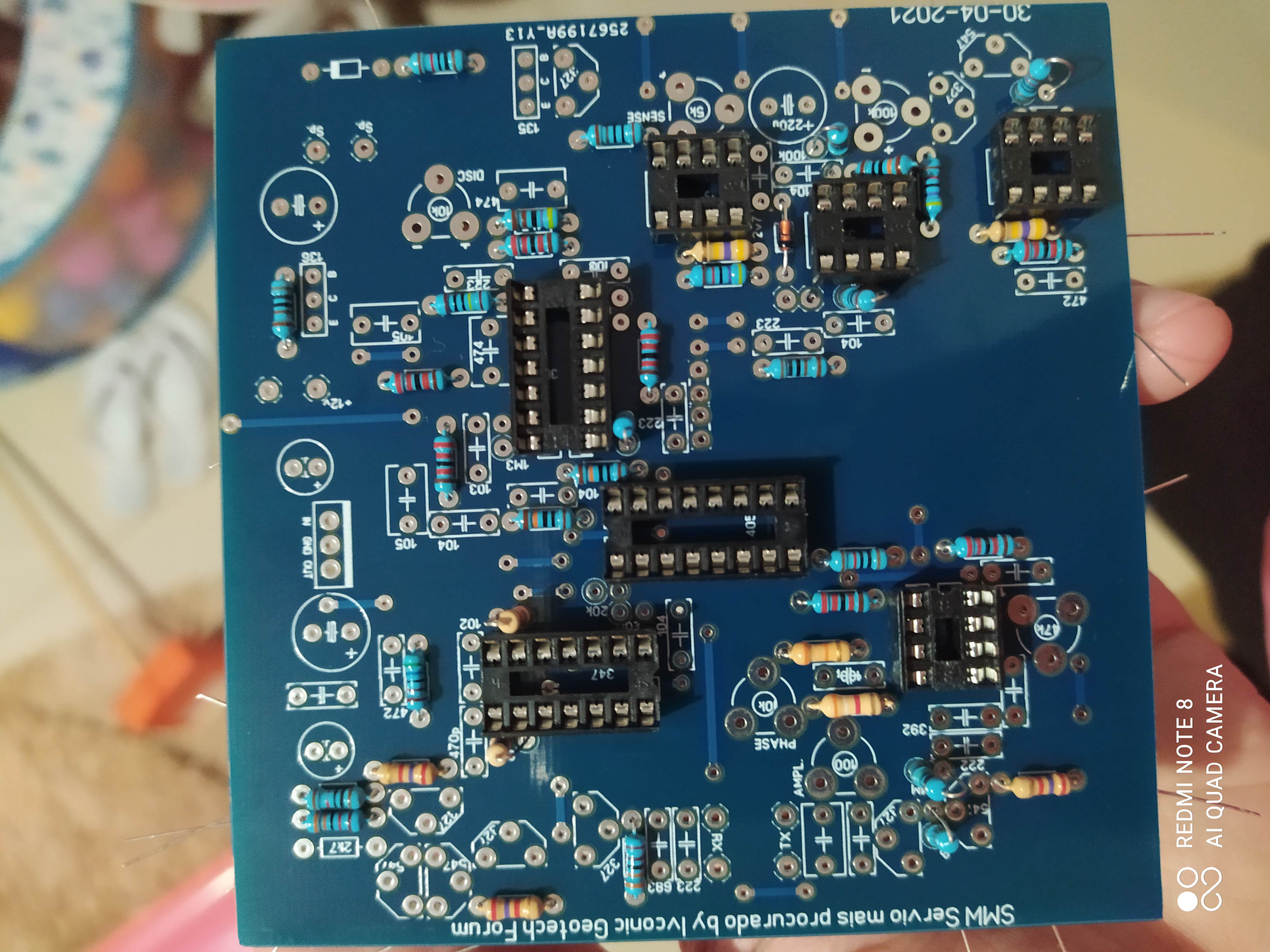

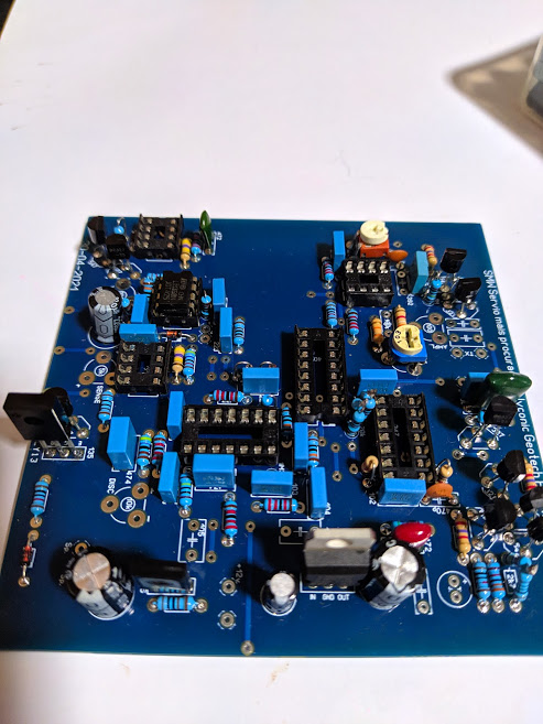

              • I'm missing some capacitors and the 100r trimpot I have to buy

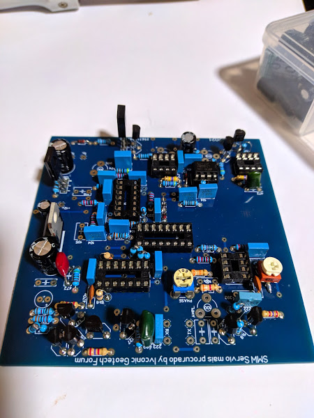

                              • Originally posted by Emersonpaz View Post
                                Hello Emersonpaz.
                                Do you know if this resistance is important, it does not appear in the diagram?
                                you can see it in the link in # 156
                                https://www.geotech1.com/forums/show...25477-Hi/page7
