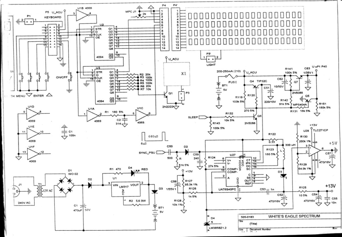

            Does anyone have the schematic for it....
              Whites

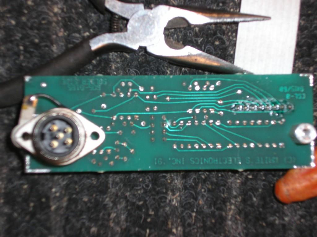

              I have the White Eagle Spectrum and I'd like a scematic too, it is working fine, but the control panels backlight doesn't function. I would like to know how to open the control panels case without damage, I can only see one screw underneath it. This is a great detector and I'd rather not try to open it, unless I can without damage. There is no difficulty reading the display in daylight, but in the half light of late evening, you have to use a torch to see it. I am told this is a common malady for this model. So someone must have `fixed' one sometime.

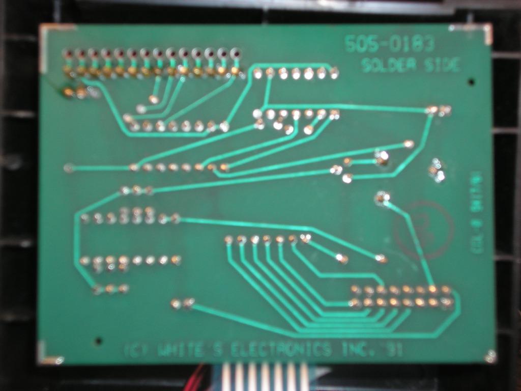

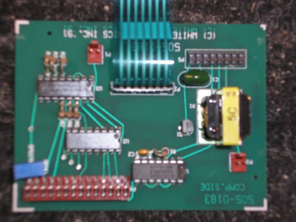

                      Display board schematic if somebody are interested.
                      For more look:
                      http://thunting.com/geotech/forums/s...77&postcount=6
                        The White circuit!
                        What an obliging chap you are, I'll print that, You don't know how to open the display's case do you? There is only a single screw on the back visible!
                        VBR
                        Martin
                          Ok. I will try to find one Eagle for disassembling.
                            open and shut case.
                            If you find one, don't wreck it on my acount chap! I did try to open mine before, but I gave in, not wanting to damage the casing. It was a stuborn case, but likely I was not using the correct technique.
                            Martin
                              I promise the Eagle will be survive.
