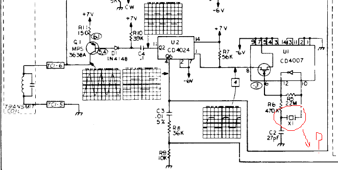

                Hi Geo
                In the plan not wrote crystal frequency.
                Can you read what is wrote on the crystal ?
                  standart crystal for whites is 26,37 kHz. HH
                    Not hard to obtain; may use any of crystals used in CB radios...
                    Bye!
                      I have for repairing a old 6000D-1. This detector has not crystal for oscillation.
                        Even better!
                          kt315 standart crystal for whites is 26,37 kHz. HH
                          KT 315,thank you.
                            Geo, I have for repairing a old 6000D-1. This detector has not crystal for oscillation.
                            Hi Geo
                            Please see attached picture , my opinion that crystal.
                            kT315 reply is correct .
                              This is 6000D-2 series. I don't have it, so i dont know.
                              Sorry
