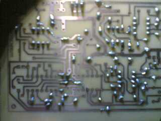

              • Surf Long PCB Single Side
                Hi! All

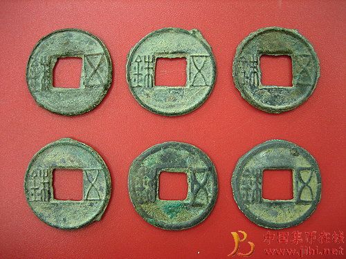

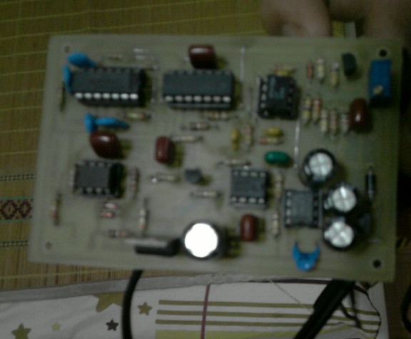

                • SURF PI test
                  SURF PI I have build up.
                  Today, the actual use, the effect is still good, but full of nails, depth can be. Is not discriminatory. To find a few ancient coins.
                  • Originally posted by yhl View Post
                    Good work yhl. You are young, you do not need discrimination, you can easily dig 100 hole per day, which is only way to your gold treasure and well build musculature.
                    • Thank you and I think Gary and the maximum distance is the same.
                      However, sensitive to small things. Gary is not sensitive.
                      SURF PI can be used to locate and search for a small coil of small objects.
                      Gary PI / bigger objects can be detected with a large coil.
                      • with strange noises bc337 audio. put 2x BC547 in Darlington configuration and will go well. (in the absence of MPSA13) Regards, Cristi.

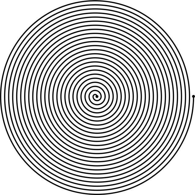

                        • hello all
                          can be made ​​a coil pcb? some dimensions?
                          waiting for answers
                          Thank you
                          • surely go (merge sigur)

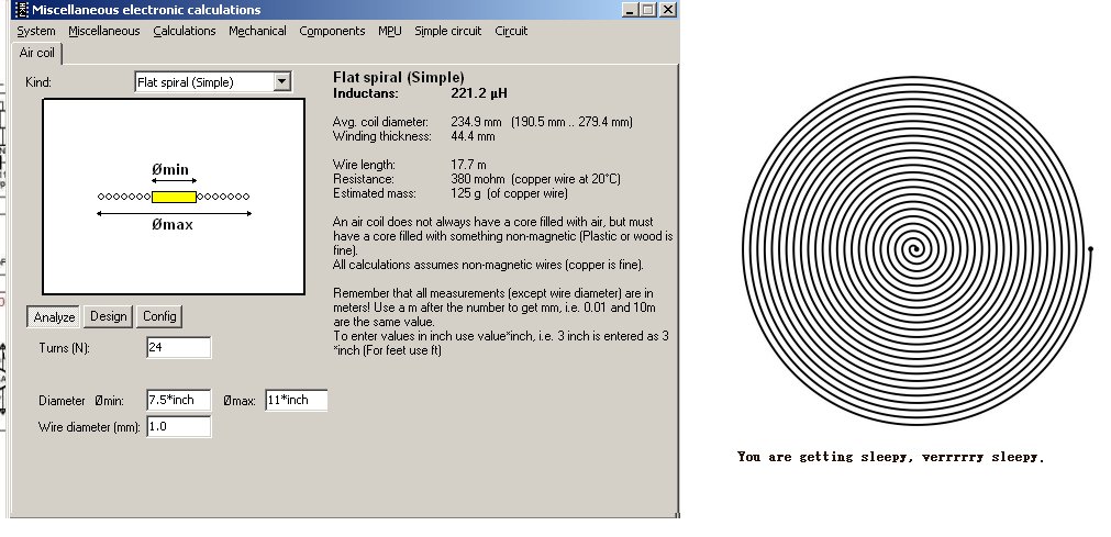

                            • Originally posted by bebe2010 View Post
                              hello all
                              waiting for answers
                              Thank you
                              I don't know if this is relevant to the Surf PI schematic but I'll answer anyway.
                              This spiral coil would be more useful if it were compressed towards the outside. The inside diameter is almost zero (I'll say it's 0.5 inch for the sake of my calculator not liking the number zero). I used the spiral coil calculator in MiscEl and plugged in values of 0.5" for inside diameter and 11" outside diameter. The calculated inductance was only 59uH.
                              Keeping the 11" outside and increasing inside diameter to 7.5" would give a more useful 221uH. (Watch out for the traces being too wide and contributing excess interwinding capacitance).
                              Now, if you were to use two of the zero i.d. coils etched on PCB, stacked one on top of the other and wound in series, you would probably obtain almost 4x the inductance of a single coil (depending on mutual coupling). That could be useful but may be tricky to implement successfully.
