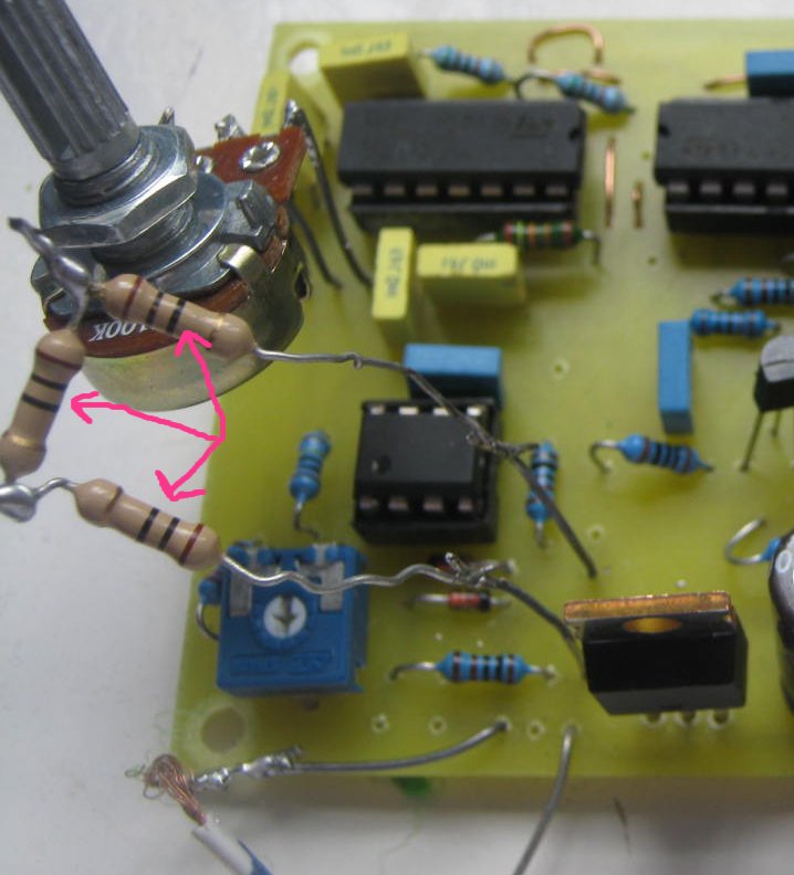

    In your top photo it looks like you have three 1Ω resistors in series, totaling 3Ω.
    IF that is your damping resistor you should have (depending on your coil) about 390Ω there.

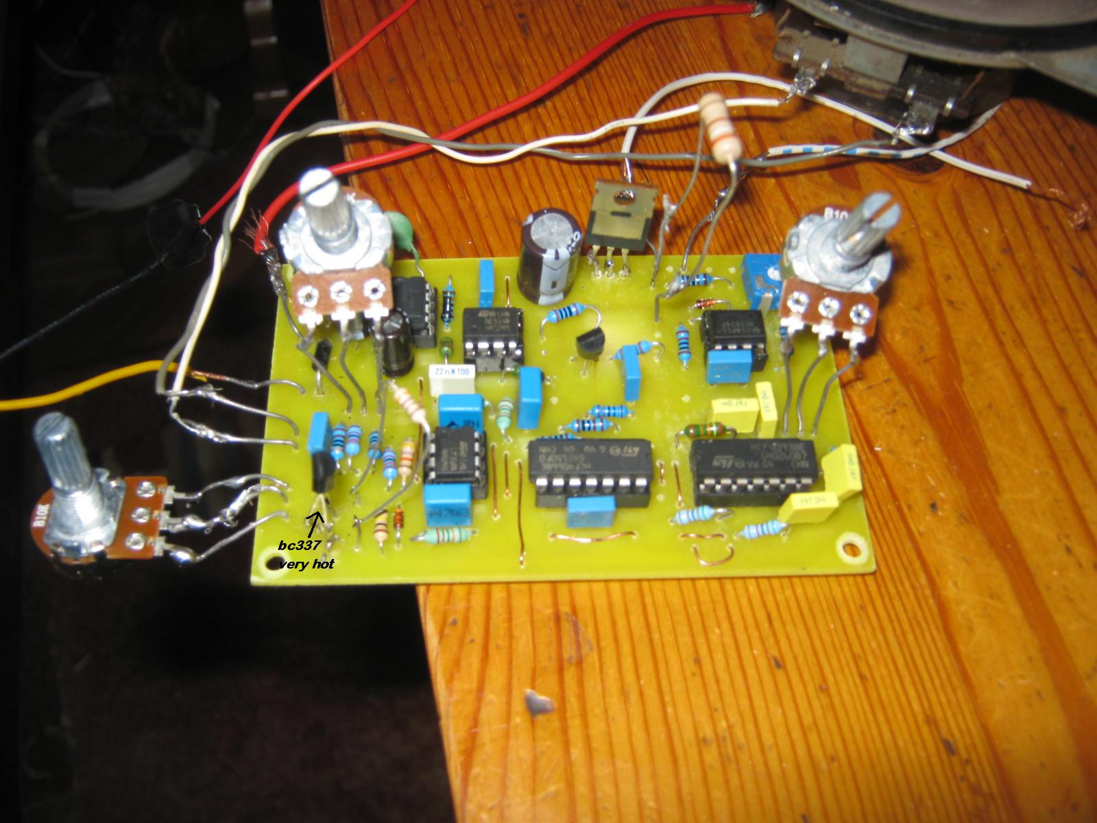

      • Hello people. These days I have tried to do something but I did not succeed. I found that the BC337 hot. I replaced BC337 with new but still the same. I put the bc639 not heating up there, just one tone, and does nothing more.

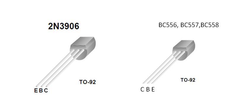

        • Hello Dimovnis, if you are replace the 2n3906 for BC337, is a mistake.
          The 2N3906 is a PNP transistor and BC337 is NPN, you can replace the 2N3906 for BC556, BC557 or BC558, this transistors are the same type PNP, and the parameters are closer than 2N3906.
          Be carefull with the Pins in the "BC" transistors are diferent from 2N3906.
          I you see the 2n3906 with the flat side up, the pins are (from left to right) E B C
          The "BC" transistors,seeing with the flat side up, the pins are , (from left to right) C B E
          I hope this information can help you
          Be patient.
          Escarabajo.

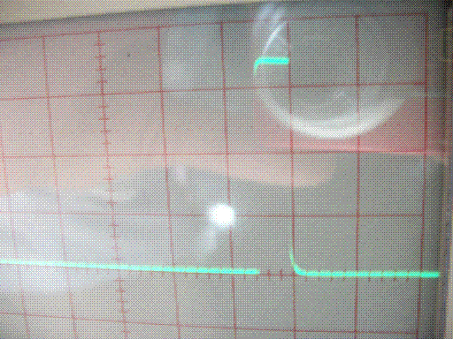

                  • I had problems with the Surf PI, already discuss elsewhere in the forum, but I repeat again, to try and help those in trouble.
                    The cause was a malfunction of T1, apparently by the type of 555 that I'm using, producing poor bias of this transistor
                    This transistor (T1), saturated and collector pulses are weak or low amplitude making it run incorrectly the 4093, the pulse delay, appears immediately after the pulse TX, (no delay work), producing MD malfunction.
                    The best way to check if T1 works well, is with the oscilloscope.
                    Without oscilloscope, you can measure the voltage between collector T1 and GND, and should be around 3.8 volts.
                    If the voltage is higher, in my case was 11 volts, then T1 is not working properly.
                    I solved the failure by installing a 3.3K resistor between emitter and base of T1. Jose

                            After assembling a long plate detector work properly about 30 seconds, then started to heat up the IRF, which consequently burned along with tlc 555, after investigation the cause was C2 (1000uF) which also heated up , replaced the burned items. I have a question how it should look the signal at the collector of transistor Q1?, on a base is the signal from the 3 pin NE555, the emitter v. 11.8
                            • Originally posted by inio_01 View Post
                              Hello
                              Q1 collector waveform, approximately 17 volts.Click image for larger version
                              • Hello everyone
                                Thank you Jose that's what I needed
