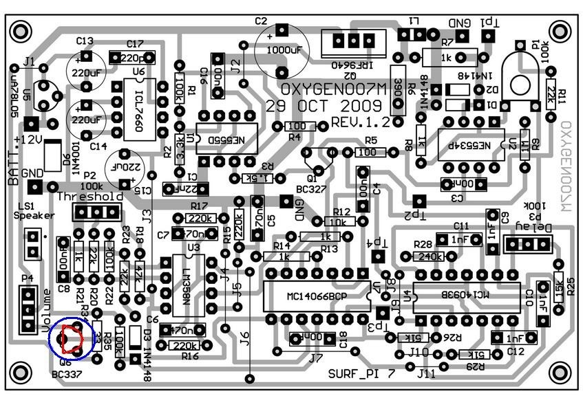

                  • hello everyone
                    in my circuit when i plug power it made discontinuous beeb
                    and the Q6 gets hot
                    here is the circuit
                    Note:
                    i replaced Q6:BC337 with KSP13 ---> MPSA13
                    and replaced Q1:327 with 2N3906 and i inverse its polarity according to datasheet
                    any idea what could be wrong ?
                    iam using 10 ohm speaker
                    Thanks in advance
                    • 10 Ohm Speaker.
                      Better Yet, Use a 32 Ohm or a Much Higher Ohm Speaker.
                      This is one reason Why I use the TL026 Transformer.
                      • Originally posted by chemelec View Post
                        maybe this is the cause of Q6 hot ??

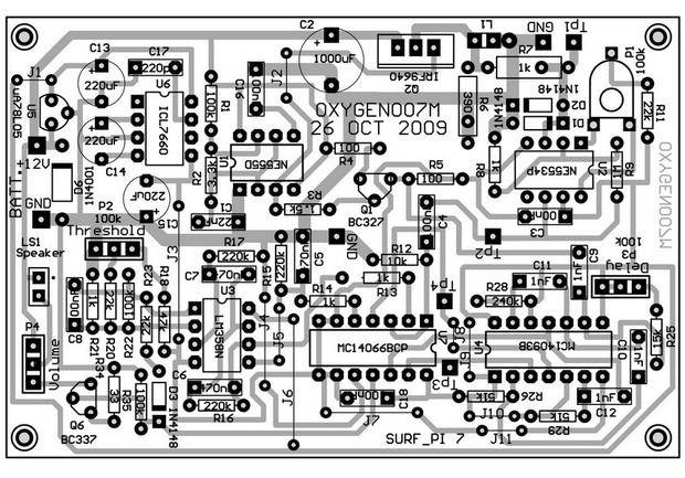

                        • This PCB has an error, Q6 is in wrong position. Must be reversed.Click image for larger version
                          • Originally posted by Fabian View Post
                            This PCB has an error, Q6 is in wrong position. Must be reversed.[ATTACH]26625[/ATTACH]
                            i replaced Q6:BC337 with KSP13 ---> MPSA13 so its placed correctly
                            • Sorry. You're right. I have not read the previous post altogether. Just saw the picture and remembered that mistake.
