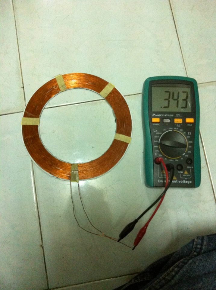

                i have finish make spiral coil how to shiled this coil any one know
                • hello paku
                  well done
                  mix clear laquer or paint (acrylic or epoxi base) with graphit powder and use this as shield
                  if you dont want to by clear paint
                  use acetone mix this with styrofoam ( search Q-dope) and add graghit powder (you can measure resistor with meter around 200K setting)

                    allright thanks bernte_one
                    Best Regards, Paku

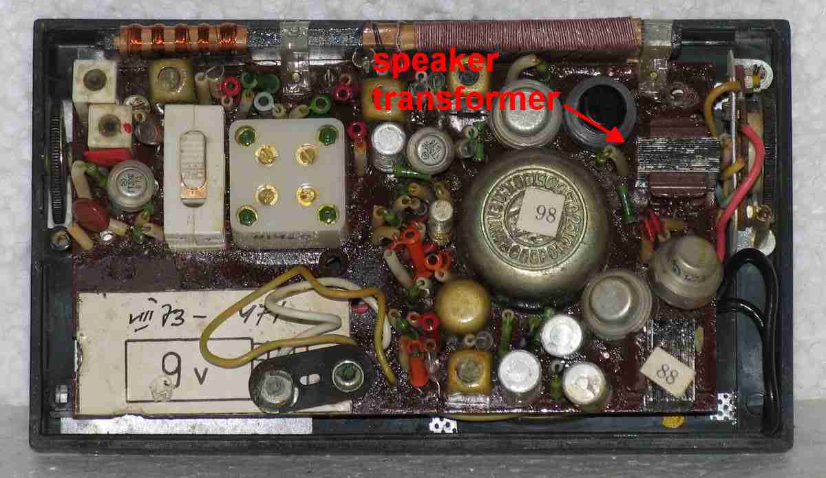

                    • how to make sound loud with this board
                      • You can use a transformer from an old transistor receiver, and make sure to connect a speaker to a low impedance end. Works for me in another project.
                          can you show me some sample of picture
                          • No problem, seek a transformer like the one in the picture, and measure windings resistance. The winding with lower resistance goes to the speaker, and the other one is connected to your machine instead of a speaker. In effect you get a speaker of a larger impedance, and because it is driven with current, it will be louder.
                            Alternatively you can seek a 50ohm loudspeaker and use it without a transformer.
                            • ok Thanks davor i will try find that transformer
