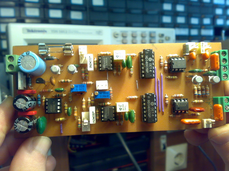

              Hi to all
              Although Turkish guys at Turkish website said that this circuit without success
              And didn’t work truly.
              But I believe Sascho and decided try it again by myself.
              Thus built PCB of the "best vlf detector" and montage it. I apply some alter
              To Leto PCB . omitted two big wire jump and other changes.
              Not test it yet. I am saying more afterwards.
              Best regards.

                  Excelent work Aft....
                  Dont listen to the turkish!
                  I made it work more than good.Wasnt able to made proper coil then.
                  But wit average test coil showed very good behaviour.
                  So if you tune it right you will see for yurself.
                  Can you share those changes you made to the PCB?
                  keep on ................................................. detecting

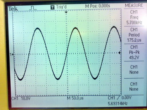

                              • Hi to all
                                I testing oscillator section today .clear and stable sinus wave .
                                All of measuring parameters illustrated on picture .
                                Best regards.
