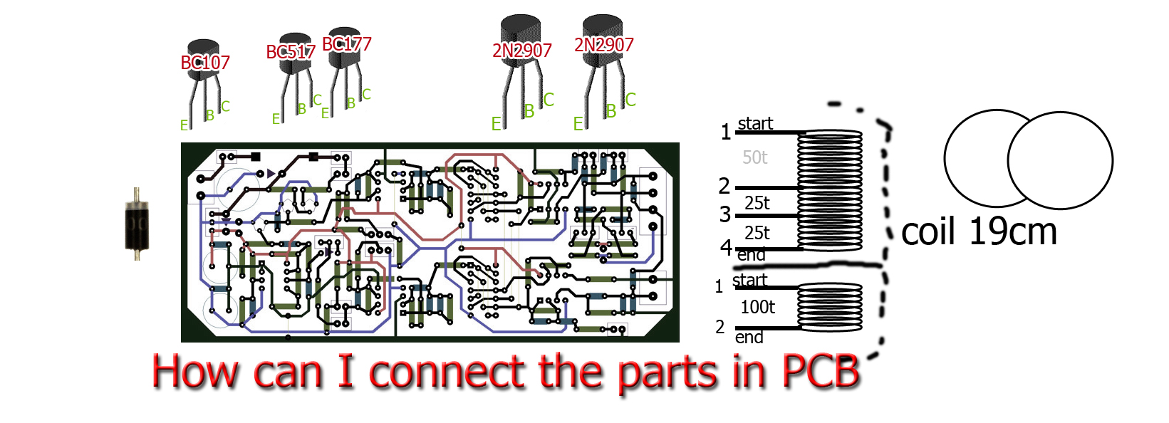

                                I agree with you its difficult Made
                                But I'm determined to Made MD VLF With your tips Of course
                                Now it works , Results: 2.2 coin in Air 10cm
                                I want to know How can be connected coil to PCB and whta its Gauge wire is 0.25 or 0.28 or 0.40
                                You can use the picture I sent to you to show me.
                                Thank you
