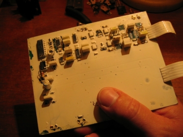

          One question about the schematics
          Hello Zed, thanks for the schematics of the SD2000 but something doesn´t match when I compare the schematics and the pic belonging to this. In the pic I can find two crystals vertically aligned on the left upper half - in the schematic I couldn´t find the second crystal. Can you help me to solve this problem or doesn´t the pic belong to the schematic? Please apologize when you find some mistakes in my post but English is not my mother language. Best regards Pulsfuehler
            G`day Pulsfuehler
            The second crystal wasnt included because,well i just didnt think of it,m/lab included two crystals so as two detectors would be able to work in close proximity to each other with out interfering with each other to much.
            One detector would use one crystal and the other detector would use the other crystal,both crystals on the board are diffirent,say 2.1 mhz and 2 mhz.
            the crystals are enabled with jumpers and both crystals are not used at the same time on the one detector.
            Thanks for your interest and your English is just fine.

                    HI ZED.
                    With many thanks for Your scheme. I want to do the detector SD2000 on Your scheme. Can You have a good photo of the printed charges to do PSB.
                      Hello Foma
                      umm i dont know what you mean by "printed charges".
                      Zed
                        HI ZED.
                        To do LAY, necessary such photo for SD2000.
                        To was seen tracks.
                          Yummy paint
                          Sorry FOMA,m/lab like to paint there boards.
                          Zed
