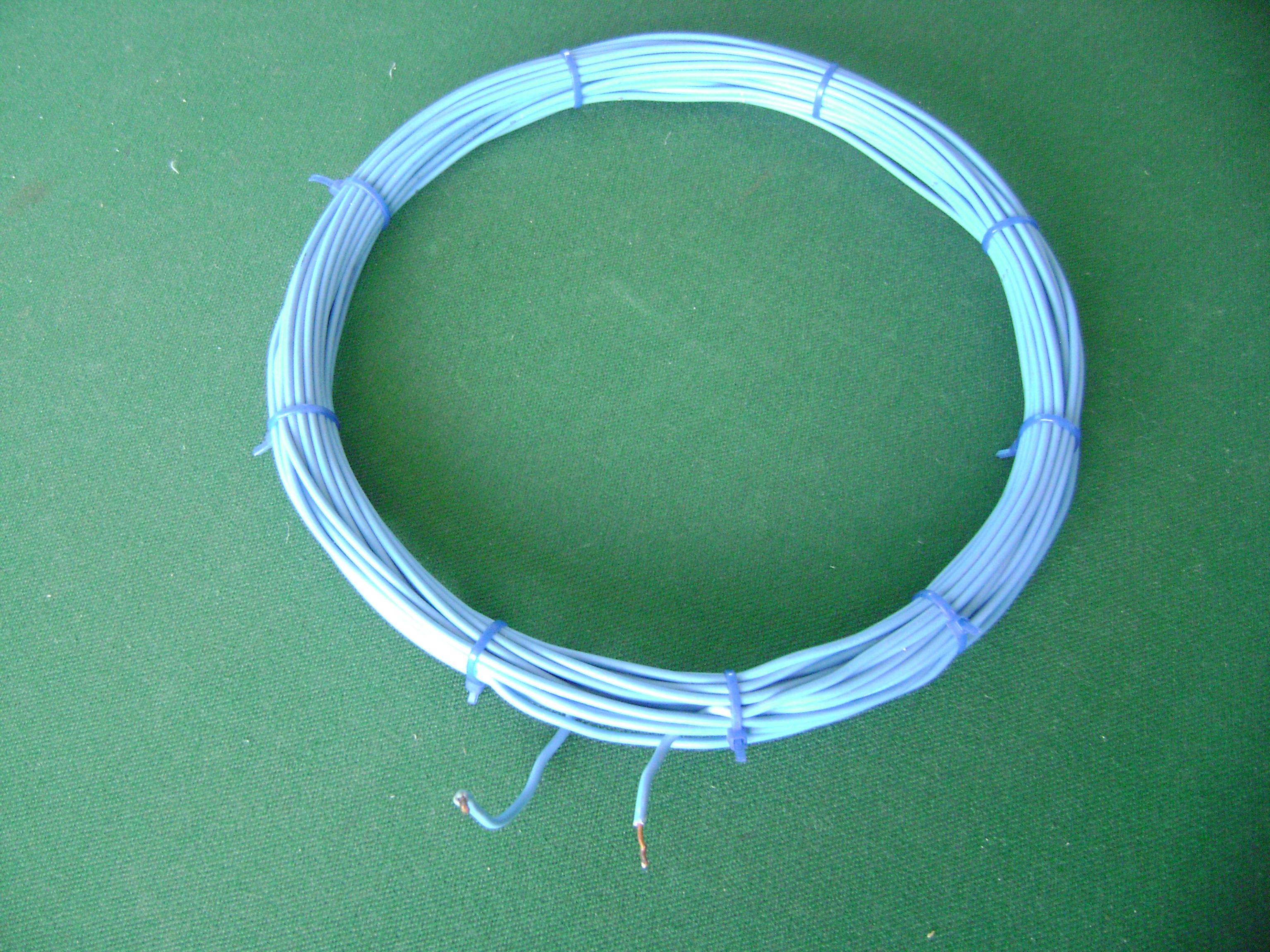

                  • Can I buy 0.4 the 0.3 enamel wire , I can use this caliber.
                    • Hello, I suggest insulated wire, as in the photo, I am developing the project in a DIP format, and in this example has 298 uH and 0.4 ohm.
                      • Originally posted by g.s View Post
                        Can I buy 0.4 the 0.3 enamel wire , can I can use this caliber.
                        g.s...very hard to build a coil with R = 0.4ohm with any solid copper enamel wire.
                        Good quality Litz wire or next best Teflon multistrand wire will help to keep R > 1.0hm.
                        Try the wire you have....22-23 Turns at 30cm.
                        Use on detector and see how it operates...Follow my picture above.
                        If all else fails. Get real Minelab Coil, Coiltek Coil, Nugget Finder Coil. So many out there.

                        • Originally posted by Baterista View Post
                          [ATTACH]23752[/ATTACH]
                          Hi Baterista, where did you get that wire from?
                          Sid
