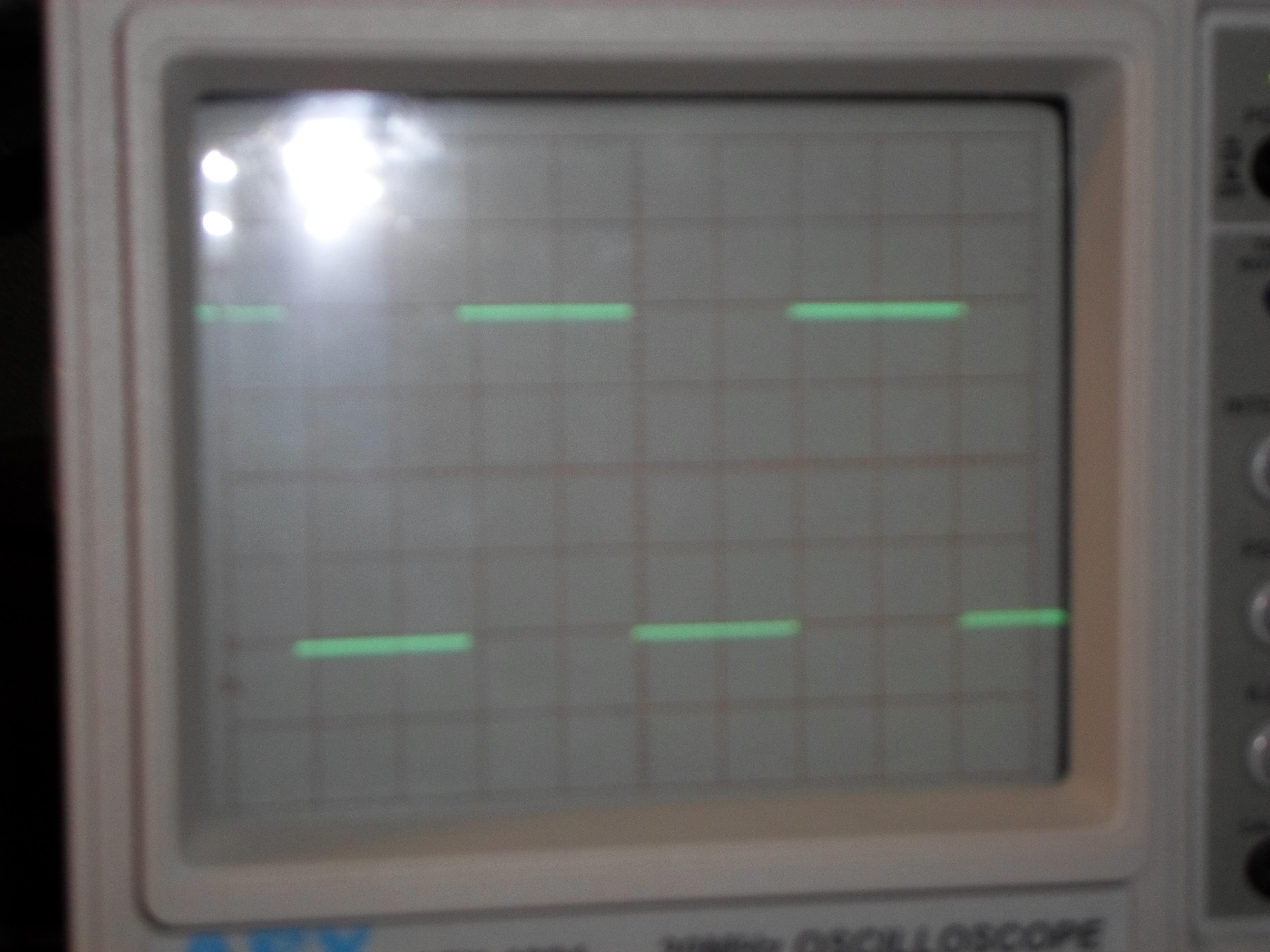

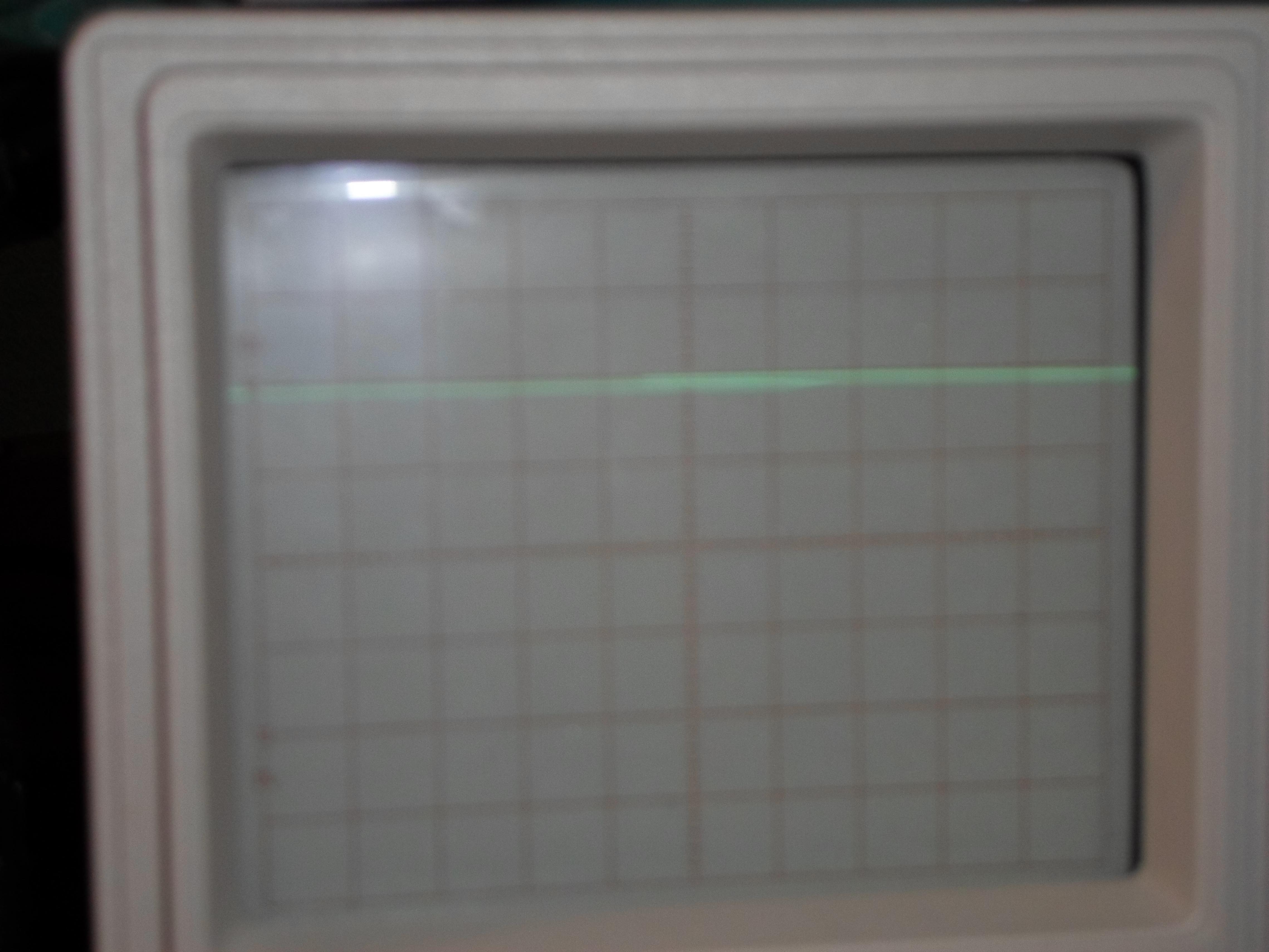

                • for again...
                  I still have problems with the threshold ...
                  at lm13600 at 12 pin I have square wave .. like the picture ( 1 ) ..When approaching target tO the coil be it metallic or anointing is then I have the same result picture ( 2 ) ..
                  now at 4053 at 14 pin I have evidence so -5v but dependent to the object approaching the target.. there changes from the 0v to -5v..
                  at pin 4 at 4053 I have -5v up to +3v..
                  at pin 3 and pin 5 I have -5v up to +3v.. while on pin 13 and pin 12 I have only οv until -5v..
                  it pin enable It is connected to -5v.
                  believe to explain as best I can..
                  continue to but I have a problem with the threshold not responding ??..mutation does exactly at tlc074 at 9 pin Can you explain..
                  I WANT TO TELL YOU that it is my placement and DIODOS lying there at tlc074 what is the role of this..
                  even the sound heard from my headphones When approaching very GOAL IS A VOLTAGE clogging,, as gggggggggggggggggg ..
                  HELP suffocate.......

                  • Hi GS,
                    on the 4053, when you have no target or coil movement or emi, is the voltage about 0v? When you move a target near to the coil, these voltages should change, which I think they are for you.
                    On the lm13600 do you have the bc857 connected to pin 1 or 5? Should be pin 5. Does the signal going to pin 5 vary as a target approaches the coil? Does the frequency on pin 12 vary as a target approaches the coil?
                    The diode is on the tl074 to stop some noise on ch2. What happens at pin 8 when a target approaches the coil? Take a scope shot of this, 0.5 seconds/div (very slow).
                    The schematic works.....
                    Cheers Mick

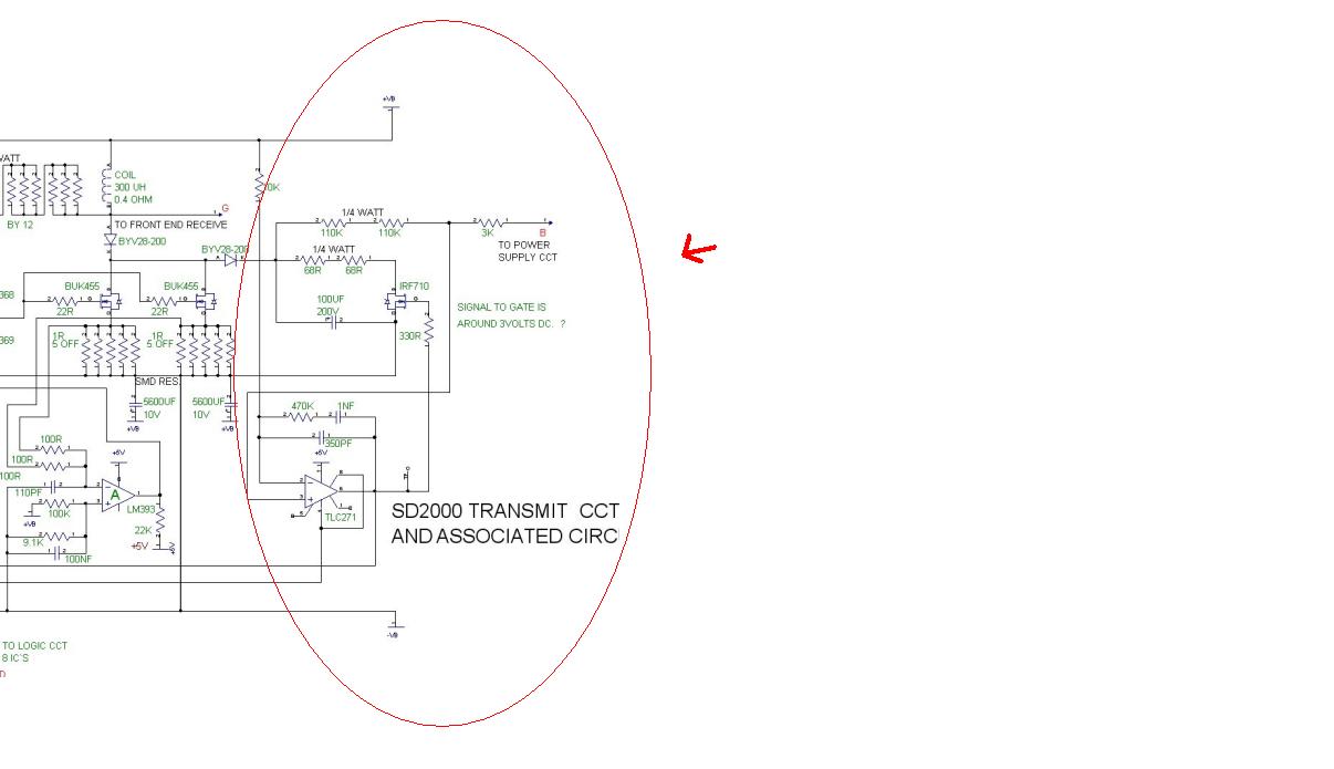

                          • GOOD EVENING TO ALL..
                            I WANT TO INFORM YOU into something I did , reduce resistance 3.3 meg at M the pot threshold in 100 k and I finally got it functioning..
                            Can you explain the below stage depicted in FIGURE.. What is the role him for he does not realize WHY they there is..

                            • Thanks Sido for the translation!
                              Hi GS,
                              Thats good that you got it working, but odd that you had to lower the resistor that much.
                              On the tlc27m7cd before the tlc074, what capacitors did you use? The 100nf and 220nf caps should be polyester caps. Also check that the connections are correct around there.
                              Did you use a pcb program to make the pcb from a schematic automatically or did you manually route the pcb from the schematic. You may have made an error if you had to manually route the pcb that you cannot see.
                              Anyway that section you have circled above regulates the voltage on the 200v cap to 180v which limits the flyback voltage to 180v preventing the flyback from avalanching the tx fets and blowing the front end fets. It is a good design.
                              Cheers Mick
                              • for your mic ..
                                I have used 220 nf 63 v polyester...
                                it pcb has created manually..
                                there SURROUNDING I have looked but can not find a my fault..
                                until the n68 ok..
                                I'll look BACKWARDS Do I Have do something WRONG..
