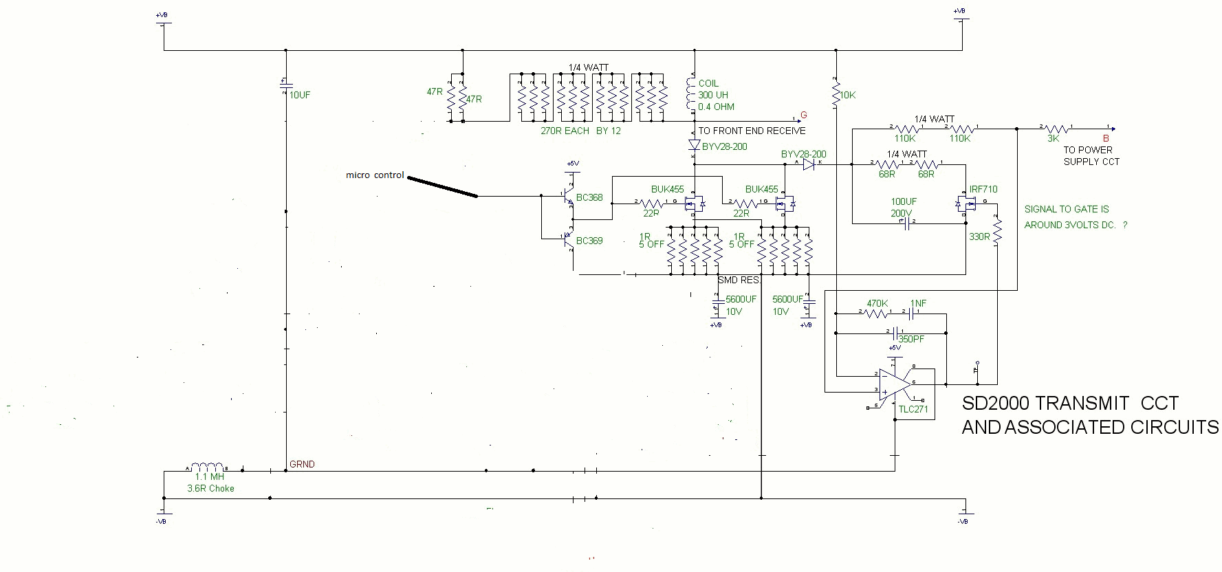

                  • Hi g.s. Nice to see your circuit is working. Test your machine where there is minimal emi and it will behave very well.
                    • Hİ mechanic. I want to cancel CTT pulse solid. I do with timings 62khz processor .I took off the redundant portions for . Is there a mistake? regards Click image for larger version
Name:	sd2000  transmit cct  .gif
                      • Hi Serci,
                        Sorry I have not replied, to say I have been busy is an understatement!
                        No you can't connect up to there. You need to use a level shifter of some sort between the mcu and the transistors. The voltage swing at the transistors needs to be from 5+ to batt-. Perhaps feed the signal into the 40106 instead but you still need to make sure the voltage level of the signal is correct to turn the 40106 on and off.
                        Cheers Mick

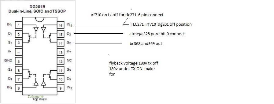

                            • Hi Serci,
                              No, what you propose in the rar file will not work. You have all the control pins connected to the tlc271. The control pins should go to your mcu. You need a different chip as that one only has single throw switches, you need double throw, so when the control is off it connects the common pin to the nc pin and control on connects common to no pin.
                              The tlc271 controls the flyback voltage limit, don't connect it to the tx! It is connected into the front end fet control cct to lock the fets off when the voltage on the 200v cap is too low.
                              Perhaps Woody might have time to help you The optocoupler he has suggested would probably work.
                              Cheers Mick
                              • hi. Tx flyback voltage 180v off under on Click image for larger version
