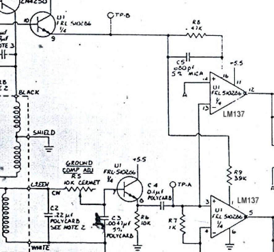

              • misleaded. LM13600 is dual while I gave single one both. you need NE5517, you are right. also some tipe I see in fisher schematic... do not see sure marking...
                something FRL510286 -???

                • NE5517 looks almost like a direct replacement for LM13600 and is certainly worth a try. LM13700 has only slightly different internal circuit (but same pinout) so you could give it a try also.
                  It looks like either of the other two should probably successfully fill in for the LM13600.

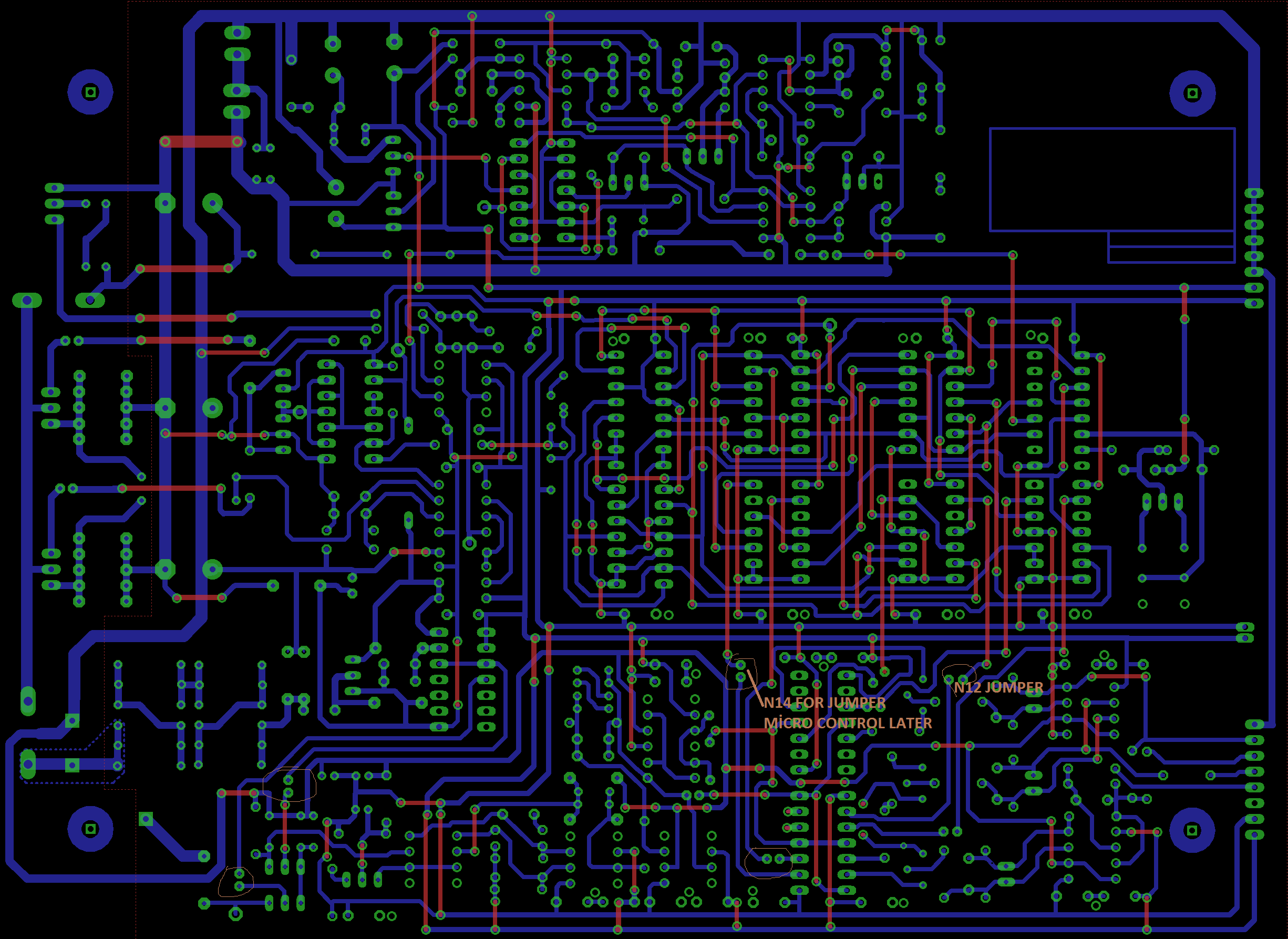

                          • I took g.s project example (DIP packages)20x15cm I run to connect the micro control..... the later micro control connect Click image for larger version

                            • Very nice. Lay format file ?

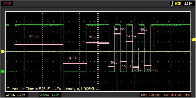

                              • Hello there! found in the Russian forum md4u.ru idea how to replace multiple ICs with processor attiny2313. Thus can be made smaller boards. I made a model of the scheme but it turned out that the times are not accurate. Someone who has more experience in programming you will be able to write a new correct hex?
