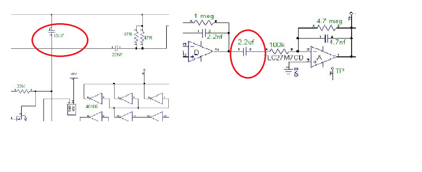

      • Hi Finderskeepers what type of capacitor Click image for larger version

        • Hi Serci,
          The 10uf cap is a tantallum, the 2.2uf is polypropylene, for the 2.2, choose as high as possible voltage as they normally have less leakage. You want a low loss tangent.

            thank you for answer Mechanic

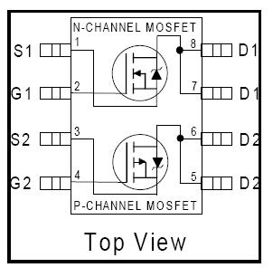

                    • hi guys well there is not enough about the 2100 to be of much help so many featurs are different my 2100 is the first model so even all the posts from Mario while they give me the idea they are different and right at the frontend to the reciever there is a fet and my 2100 doesnt have it. it has an ic in the same spot 8 pin dil
                      the running of the detector with the yellow wire cut gives a low tone that is constant and pure , reconnect the yellow wire and there is a warbelling noise that cannot be cancelled tried a different coil and same noise . the level of the warbel did change up and down and that is the fault it has always had so it is possibly a design fault , hence the V2 or sometinhg is varying in the circuit but i havnt found out what yet .
                      • Originally posted by Ronk View Post
                        it has an ic in the same spot 8 pin dil .
                        Two fet in Dip8 maybe.

                        • thanks N@asko I have been trying to remove some paint with little results but that might explain the difference i will check into it and see if i can sort it out
                          • that ic is a lm394 matched pair transistors
