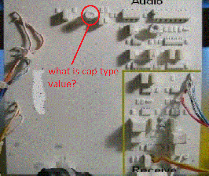

        • Hi.What is auido board cap type..Click image for larger version
