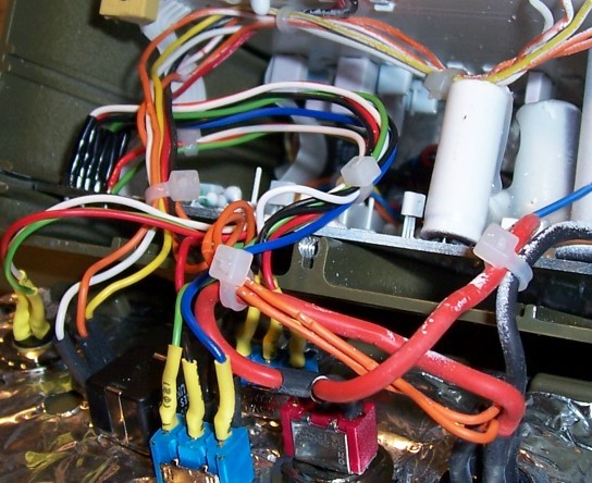

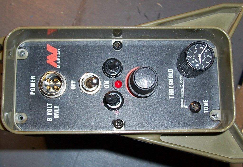

                          Is this 10% ? Just kidding.Its not a great mod but I can use all 4 channels on my 2100. Just tyed into the factory jumps and added two toggles.. But I can only run two channels at once. (so far) just havin fun.
                              Hi AzNuggetBob,
                              Try running all 4 channels to a summing opamp. I have no idea why ML didn't do this with the 2 channels in the SD2000, only 1 channel (the strongest) ever gets through to the audio. Candy referred to the SD2000 as 2 detectors in 1, the problem is as it stands you only get the benefit of 1 at a time.
