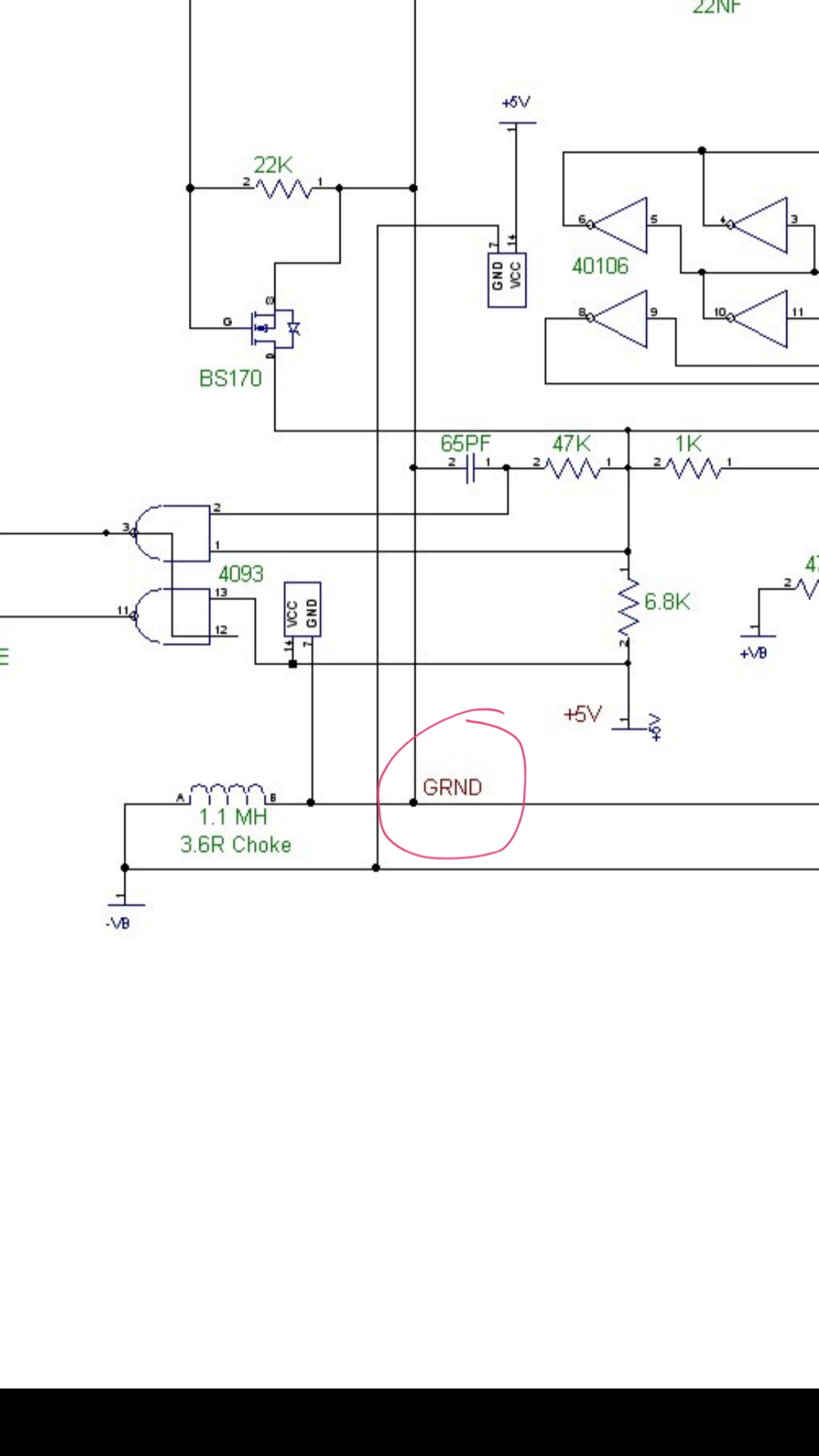

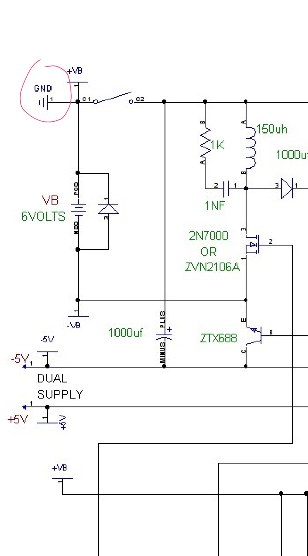

  • Hi genius, finally I ve complete my work on this big project,
    First start was with bad result (no sound), so I v started with cheking voltages +5v -5v, here I was a little bit confused with references GRND/GND(=+VB) as below pictures, so please can any one help ��...Click image for larger version

        It is Very common to have the Battery Positive to be circuit Ground in PI detectors.
        "Ground" is a bad term, better if it is named "Common" or even "Zero".
        • Hi Andrei, I will upload today, soon when I get home...
            Hi Waltr, thank you for your replay, if I understand,to measure the:
            * +/- 5V with multimeter connected to common and (one time to +5V line, one time to -5V)
            In this case +5V is ok for all IC, -5V is bad= 0.4V
            *measure signal's with scope, same grounded to common and sensor to test points.
            m I right?
            • Looking at the SD2000 Power supply and regulator page os schematic:
              That sound like the correct way to measure the +/-5V PSs.
              Are you measuring PS WITHOUT any chip that use the +/- PS installed?
              Problem could be in the -5V circuit or you have a short or bad chip somewhere.
              Do note that it looks like the transistor XTX688 in the -5V is shown backwards. Emiter should point to the lower Voltage.

                • is it possible to replace LT1057 with ad712? did I make the board for standard software (pin 4-, pin 8+), and lt1057 (pin 2-, 6+)
                  • The schematic by Zed shows a SMD lt1057S8 (pin 2- , 6+). If you look at the datasheet for lt1057 the dip package has a different pinout (pin 4- ,8+).
                    • Originally posted by au1 View Post
                      The schematic by ZED is 100% correct.
                      Then there are errors in Zed's schematic!
                        No the SMD pinout of the lt1057 is odd and only a handful of other components share the same pinout. Just stick with the 1057, there is nothing to be gained by swapping it out.
                              Yes, but have board with LT1057S8
                              • Sorry ), I have board with pin 4- , pin 8+. So, I want change LT1058S8 to another
