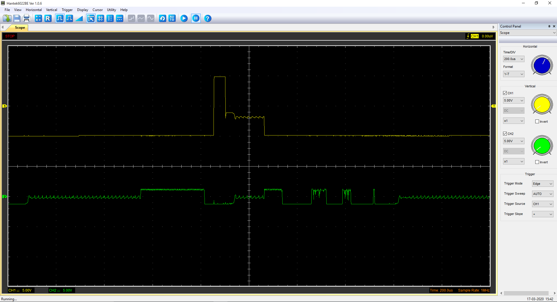

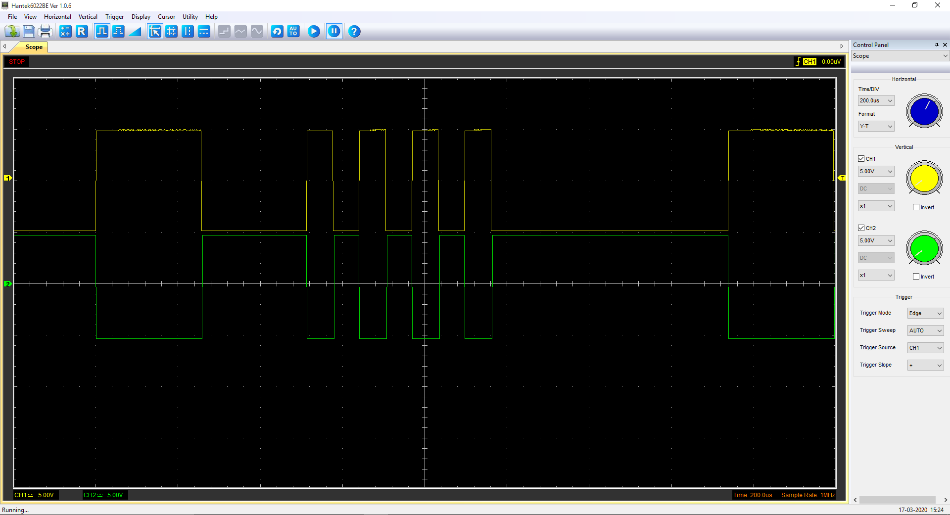

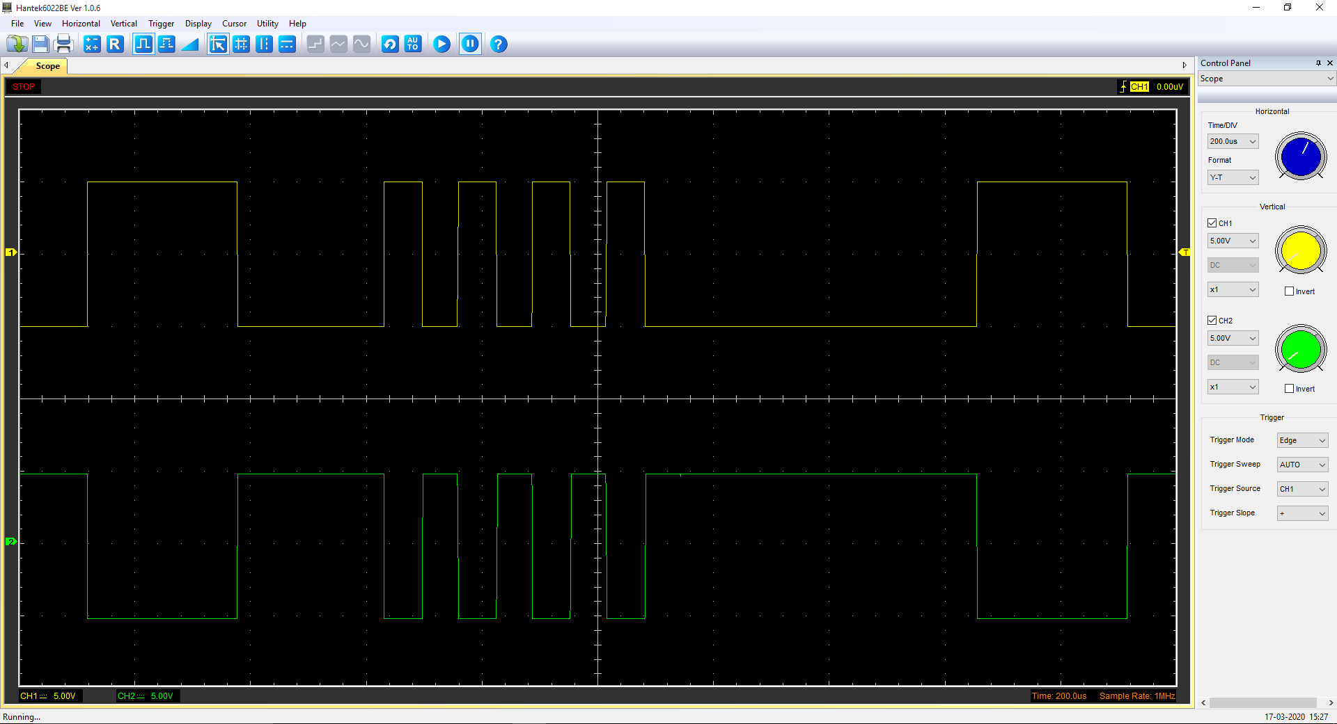

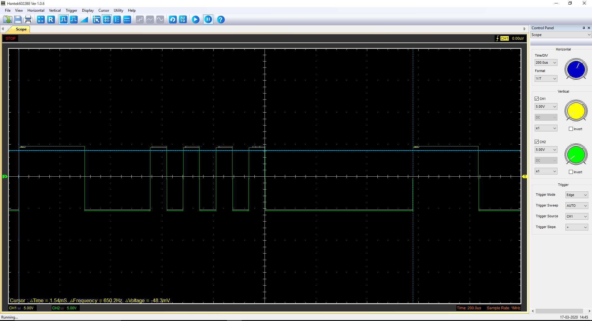

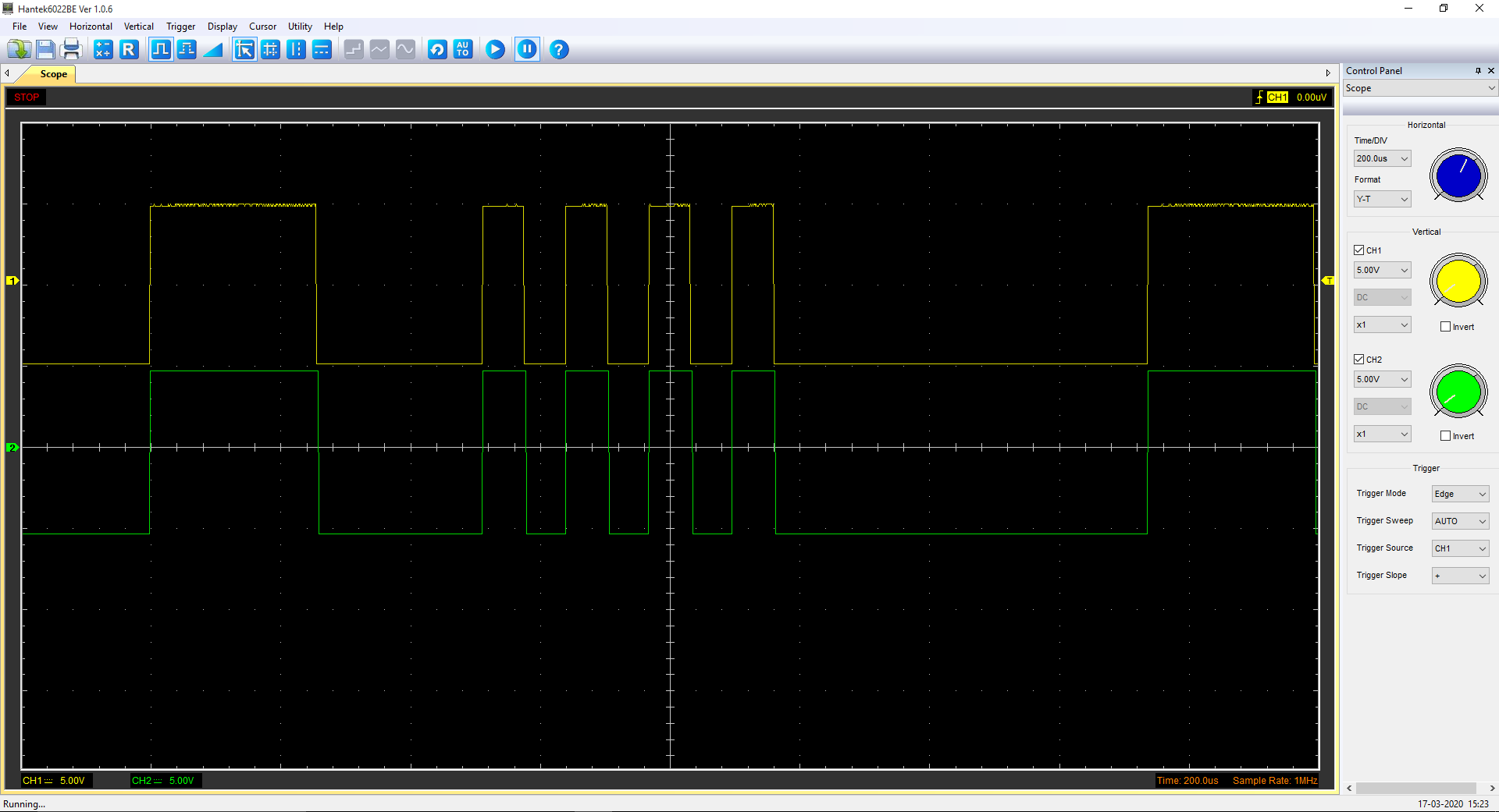

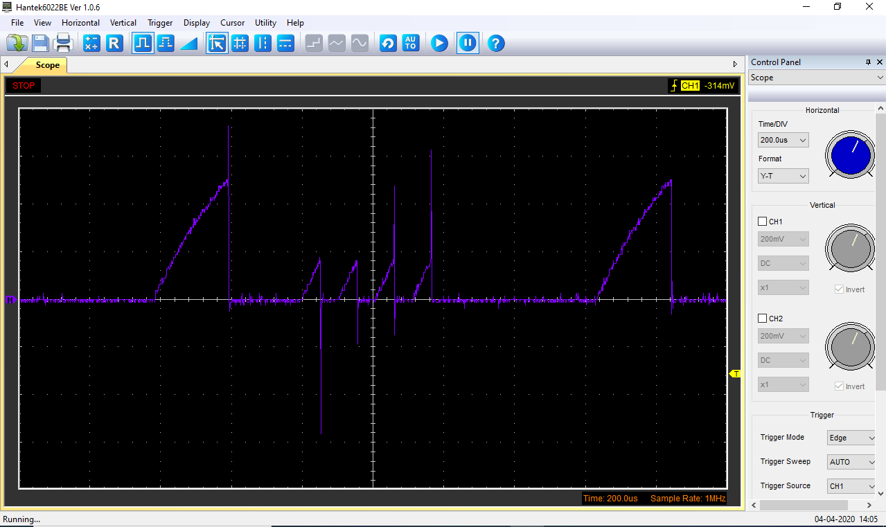

    • Hi Mechanic,
      Sorry for the too late replay, I was waiting for new wires and new part which i recieved recently,

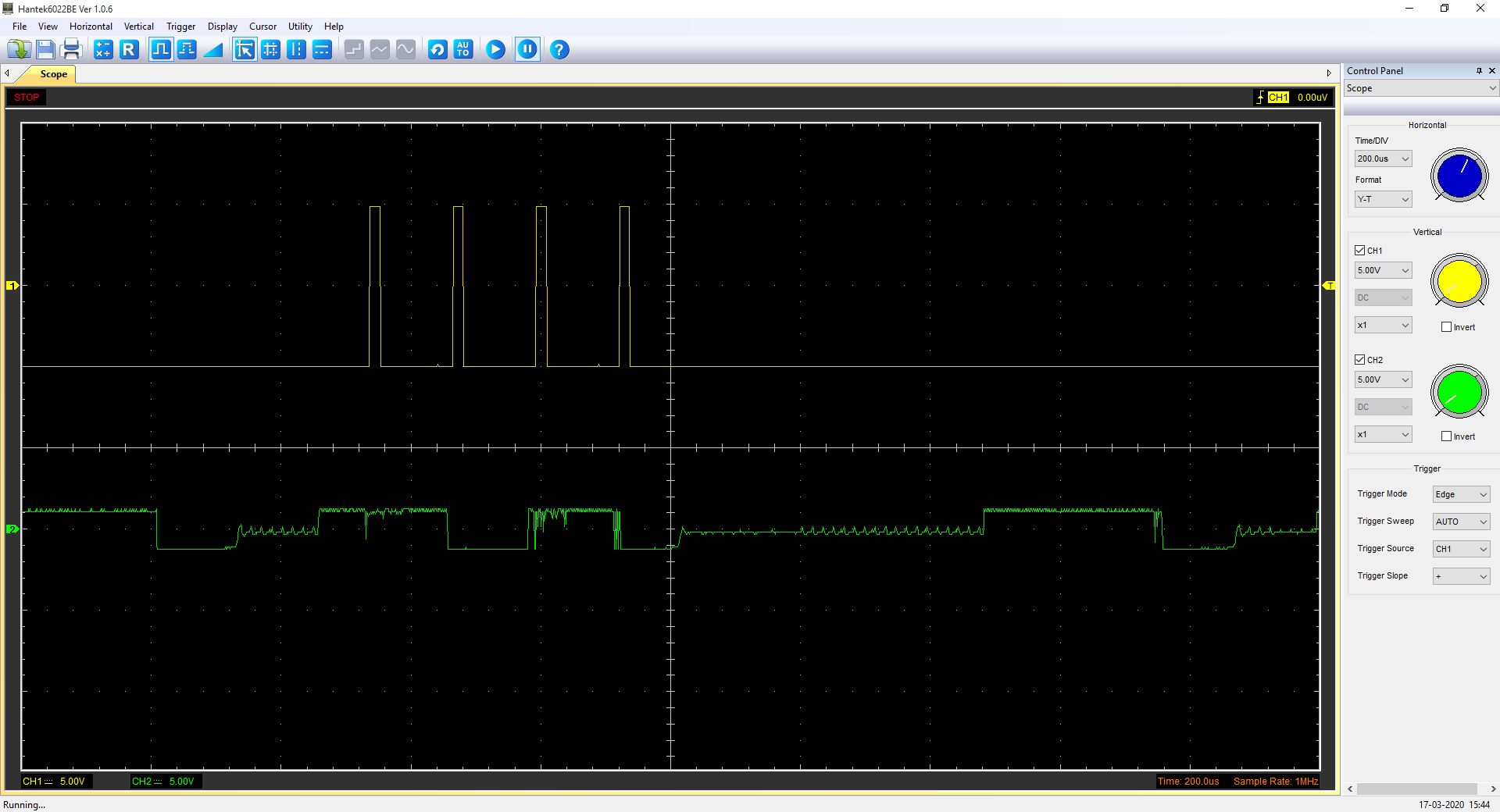

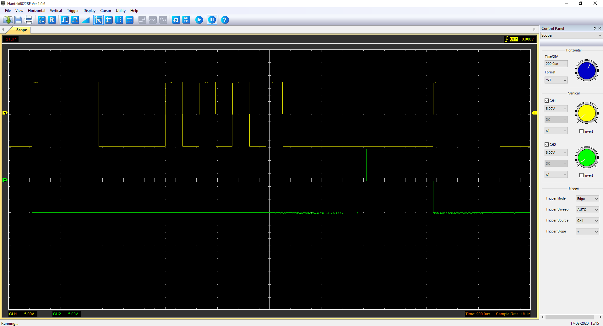

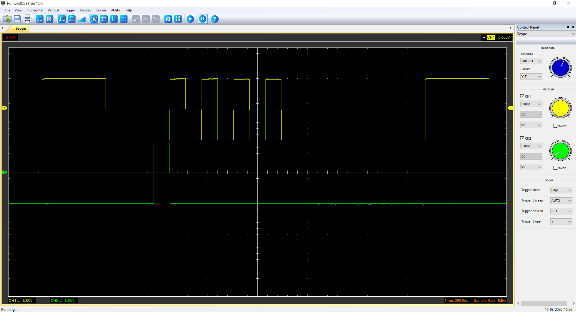

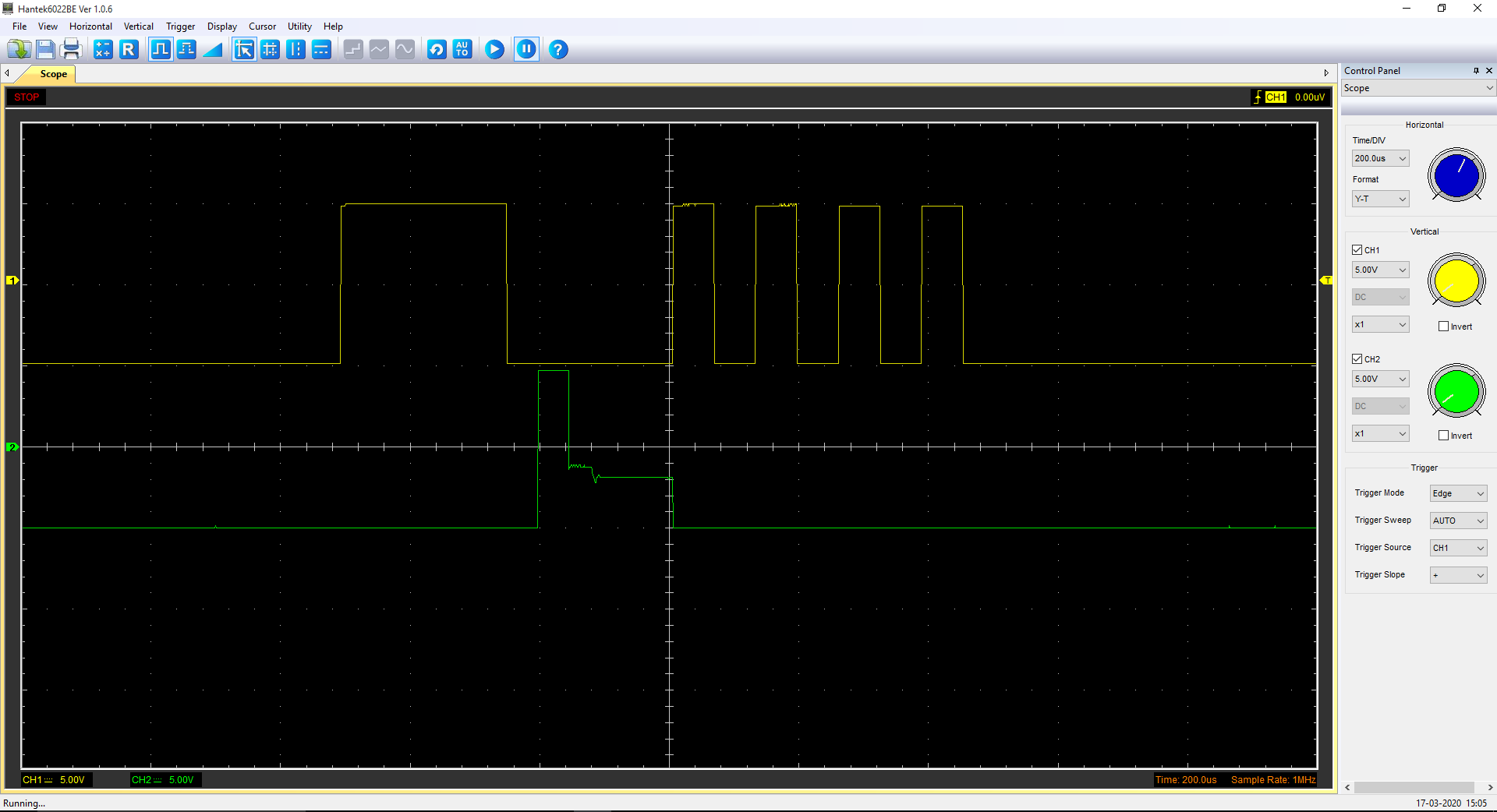

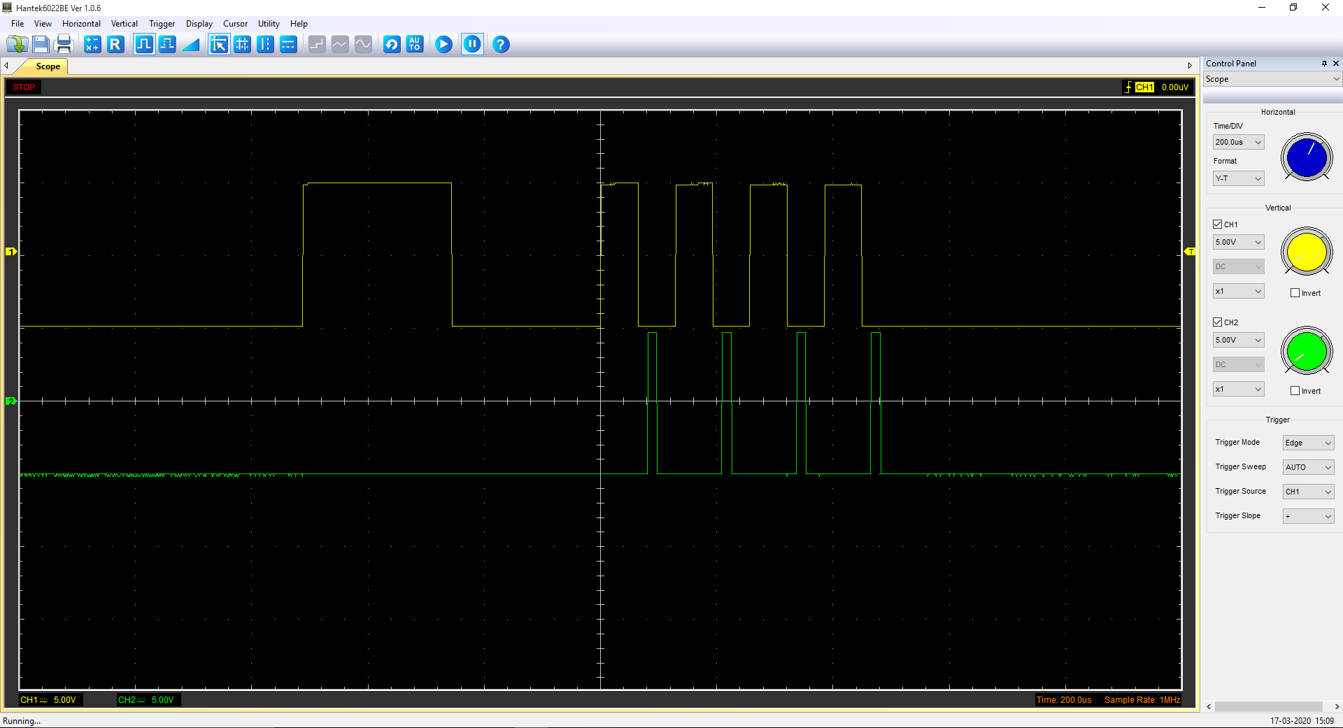

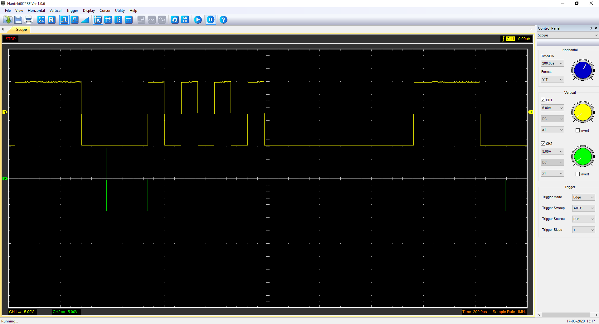

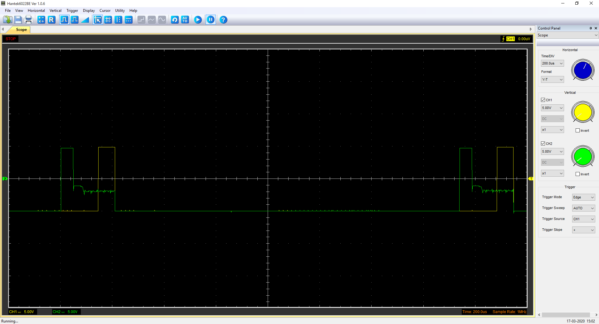

      Please see below are the new SD2000 Transmit And Sample Timings:
Name:	CH1-G BUK and CH2-N9.PNG
Name:	CH1-G BUK and CH2-N10.PNG
Name:	CH1-G BUK and CH2-N11.PNG
Name:	CH1-G BUK and CH2-N12.PNG
Name:	CH1-G BUK and CH2-N13.PNG
Name:	CH1-G BUK and CH2-N14.PNG
Name:	CH1-N11 and CH2-N12.PNG
      • SD2000 Transmit And Sample Timings follow:
Name:	G-ZVP4105 and G-VN2410L.PNG
        N50 compared to N12 and N14:
Name:	CH1-N12 and CH2-N50.PNG
Name:	CH1-N14 and CH2-N50.PNG
        I ve build new coil with litz wires, inductance=340 uH
        till this moment I can't reach the 180v in the 100uF/200V capacitor, could you and all genius people here help me with this?
        Thx
        J.Anis
        • Hi waltr, could you please take a look on these screens schott and advice ?, I m stuck in this result.
          Rgds
          Anis

            The coil it must have both inductance and resistance and capacity like the original i tested the coil of goldscan5 which has similar inductance but greater resistance and on sd 2000 i get about 120v of the required 180v!
            • I posted this morning but my post seems to have disappeared.
              The N12 signal on the scope looks wrong.
              Why does it have three Voltage levels??
              This is driven from a 4013 running at 5V. Should be either 0V or 5V.
              Where is the 10uF/200V cap? I could not find it on the schematics.
              • What is the resistance of this new coil?
                What is the self resonant frequency?
                What voltage are you getting on the 200v cap?
                Coil resistance should be about 0.4r and the self resonant frequency between 250 and 750khz.
                Waltr, the 100uf 200v cap is on the transmit page.

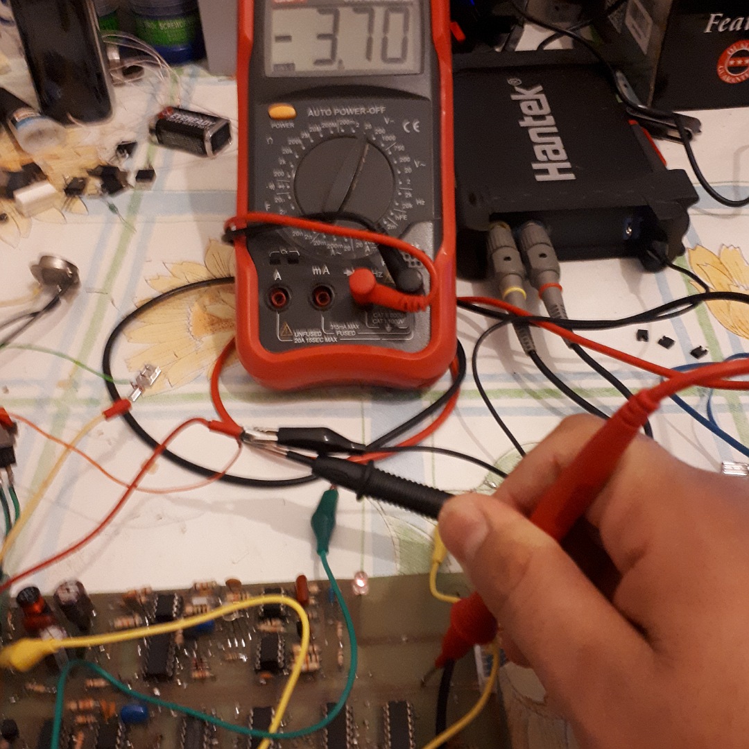

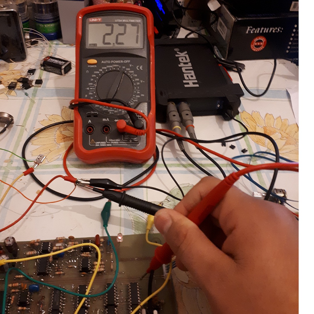

                • Back late again, and sorry for that!
                  Mechanic, I have to build an adjustable oscilator to see the SRF for my coils, anyway, below are my answers to your questions:
                  Coil1 (build with 160/44 litz wires)=1,24 ohm
                  Coil2 (build with 1,2 Dia single wire)=0,7 ohm
                  Coil1 SRF= about 400 KHZ
                  Coil2 SRF= about 20 KHZ
                  Coil1 Voltage= 8V
                  Coil2 voltage=13V
                  Note 1:
                  Both of the 68ohm resistrors become too much hot even they change color.
                  After dowing meany measures and tests...I was electroted when accedantly tached the 200V capacitor! (I have to take security in concediration)
                  -->In fact the circuit is fuctionnal.

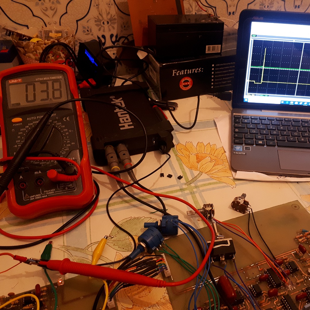

                  So ,and this is the important thing, I started to measure volts references: (coil2 used for these tests)
                  -Battery voltage= 3,8V (condition confirmed by replacing battery with adjusted power supply)
Name:	Battery voltage= 3,8V.jpg
                  - (+5V)= +2,27V
Name:	(+5V)= +2,27V.jpg
                  - (-5V)= -3,70V
Name:	(-5V)= -3,70V.jpg

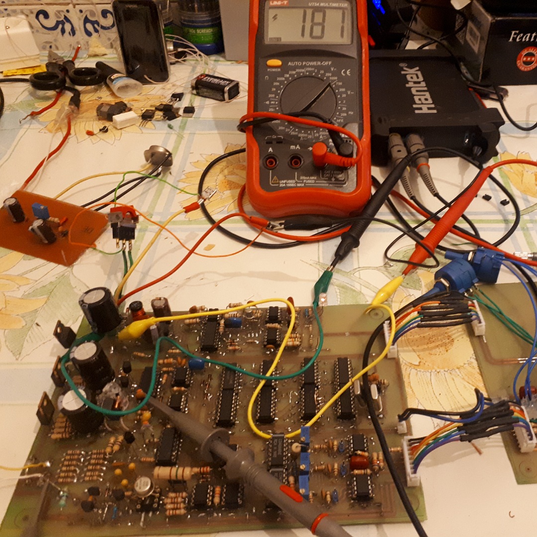

                  - 200V capacitor voltage= 181V
Name:	200V capacitor voltage= 181V.jpg

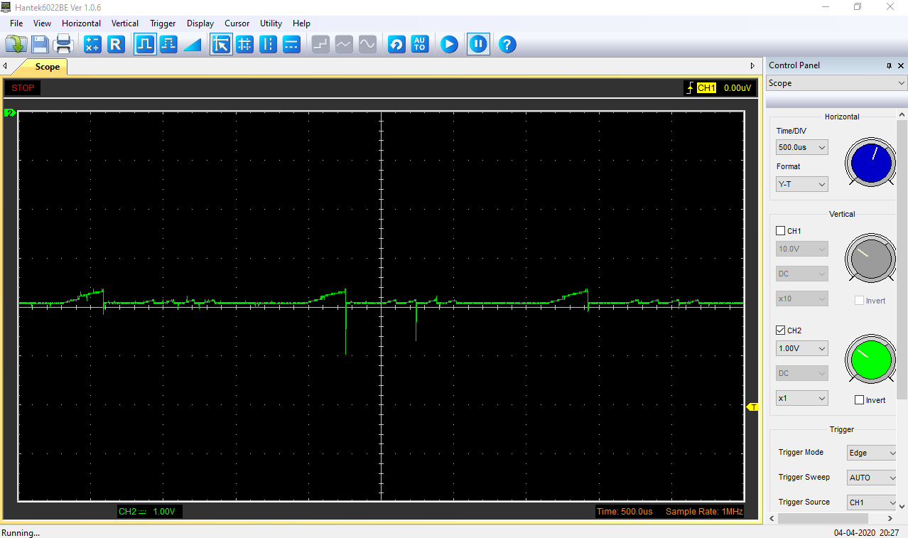

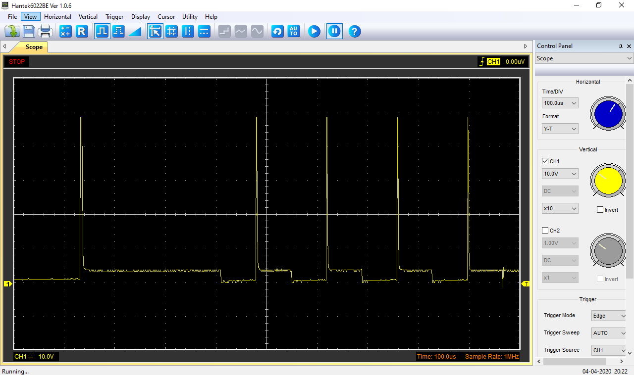

                  In addition I v screaned the voltages through coil, pin 2 of the 393 IC and the curent wave as per Zed recomandation as below attachements:
                  Coil voltage:
Name:	coil signal.PNG
                  Pin 2 of 393 IC:
Name:	Pin 2 of the 393-2.PNG
                  Curent wave:
                  with this condition and the +/- 5 voltages there is no sound from speakers, and ones I increae battery voltage to 6V:
                  -sound comes again
                  -the 2x 68 ohm resistors become too hot
                  -200V capacitor volts reduced to 13V
                  -signals from coil and 393 are decreased
                  with this results things becomes more intersting and confusing too, hope that you can help and drive me to the good way
                  Thx
                  Anis

                        Hi Anis,
                        You need at least 6v to run properly otherwise the 181v won't be high enough and there are protection circuits that stop the receive fets coming on. That is why you don't hear anything before raising the voltage to 6v.
                        The IRF710 will need to be mounted to some sort of heatsink as it will get hot. Make sure it is insulated as the tab has 180v on it. It is normally mounted to the case on the sd2000. If your 68r resistors are getting hot then the irf710(or tlc217) isn't working correctly or the resistors current rating are too low.
                        The tlc271 can easily be damaged, you might need to replace it.
                        Also make sure your connections are correct to it, that GRND is correct and you have the link to the 2.5v reference from the power supply circuit.
                        For the coil srf, to measure it I just place the coil(just connected to the scope) near(just close enough to observe decent ringing amplitude) another coil connected to a detector and look at the frequency of the ringing after tx off.
                        A single strand coil is no good for the sd2000. It takes too long to settle to 0v
                        Cheers Mick

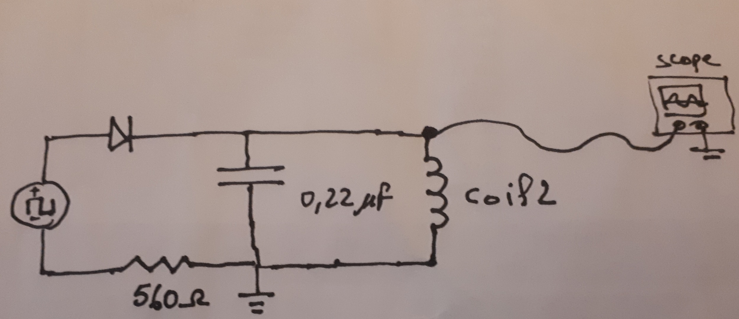

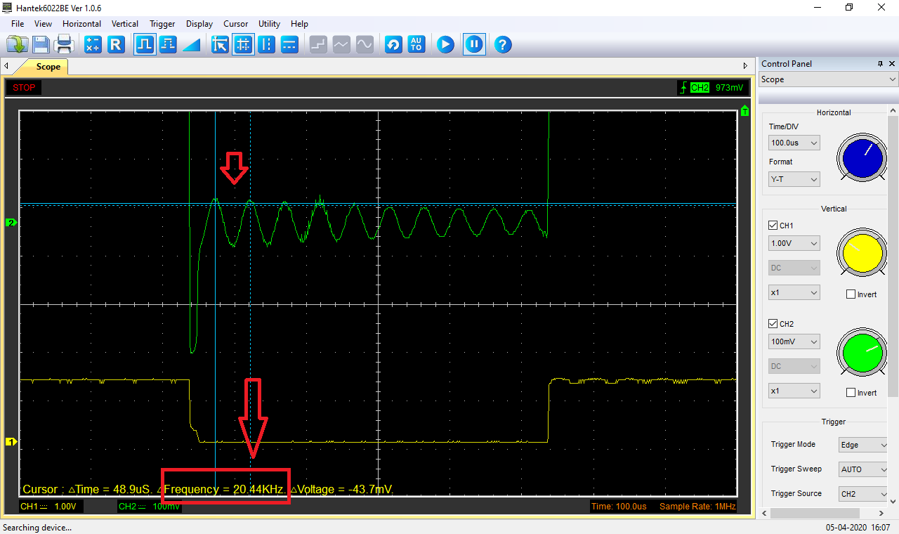

                        • Originally posted by Anis View Post
                          Yep, I will put screens for the SRF and detail the measuring method by tomorrow.
                          Hi WM6, below are test circuit and screen of coil SRF
Name:	test circuit.jpg
                          Thx
                          Anis
                              [ATTACH]49849[/ATTACH]
                              [ATTACH]49850[/ATTACH]
                              Thx
                              Anis
                              OK, if 0.220uF C is as per schematic?
                              I was thinking in classical PI configuration coil SRF.
