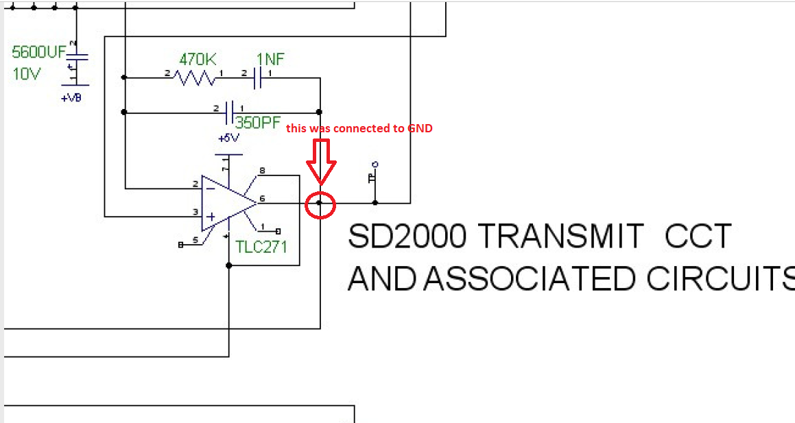

                  • Has anyone succeeded in compiling this schematic ?
                    • Originally posted by Mechanic View Post
                      Hi Anis,
                      You need at least 6v to run properly otherwise the 181v won't be high enough and there are protection circuits that stop the receive fets coming on. That is why you don't hear anything before raising the voltage to 6v.
                      The IRF710 will need to be mounted to some sort of heatsink as it will get hot. Make sure it is insulated as the tab has 180v on it. It is normally mounted to the case on the sd2000. If your 68r resistors are getting hot then the irf710(or tlc217) isn't working correctly or the resistors current rating are too low.
                      The tlc271 can easily be damaged, you might need to replace it.
                      Also make sure your connections are correct to it, that GRND is correct and you have the link to the 2.5v reference from the power supply circuit.
                      For the coil srf, to measure it I just place the coil(just connected to the scope) near(just close enough to observe decent ringing amplitude) another coil connected to a detector and look at the frequency of the ringing after tx off.
                      A single strand coil is no good for the sd2000. It takes too long to settle to 0v
                      Cheers Mick
                      Hi Mick, again thank you to drive me to the right way,
                      -Accidently connected pin 6 of TLC271 to GND this caused the blocking of the Fly back, now corrected the circuit is running well and I can see stable 181V in the 100/200V capacitor.

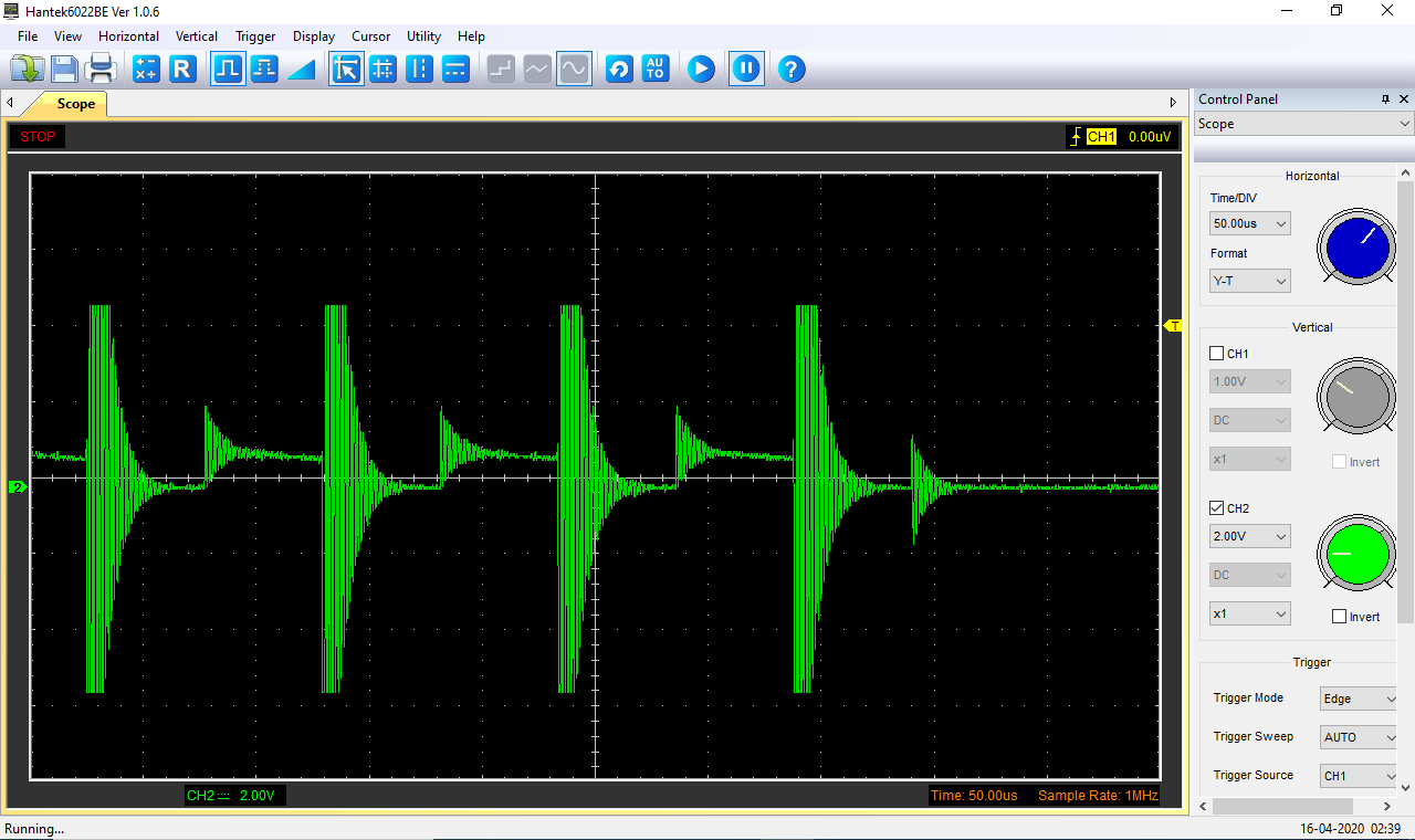

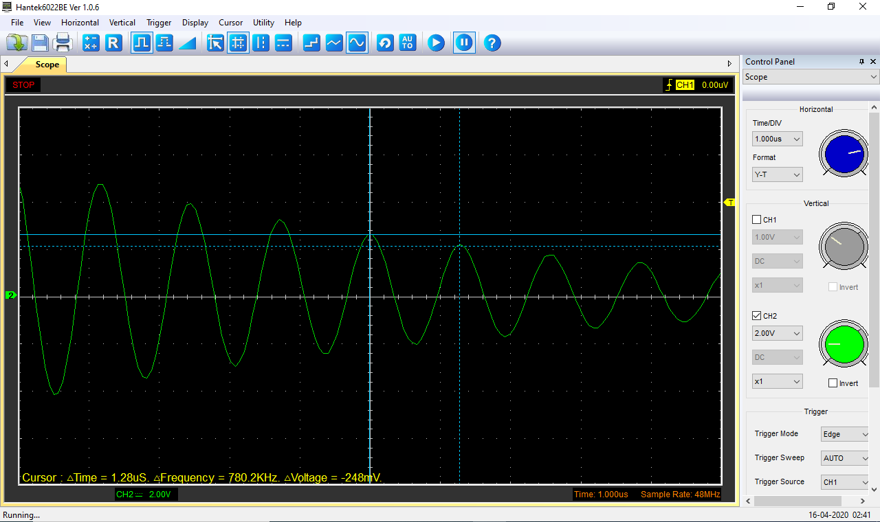

                      -Coil SRF, I followed your measuring method and below are my results:

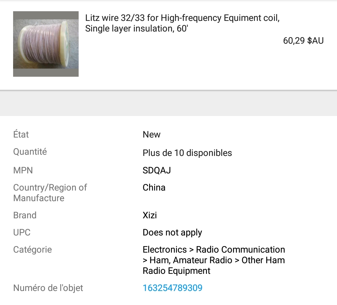

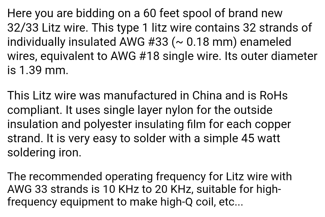

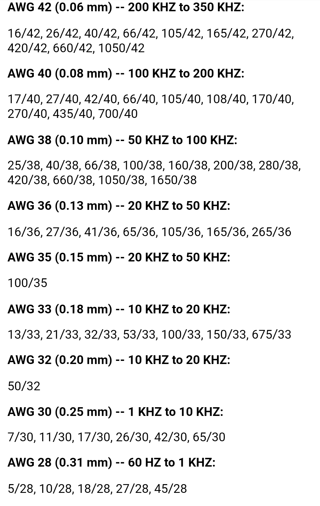

                      -I'm now looking for new litz wire for additionnel coil below are specifications for the wire, please is this a right chois?

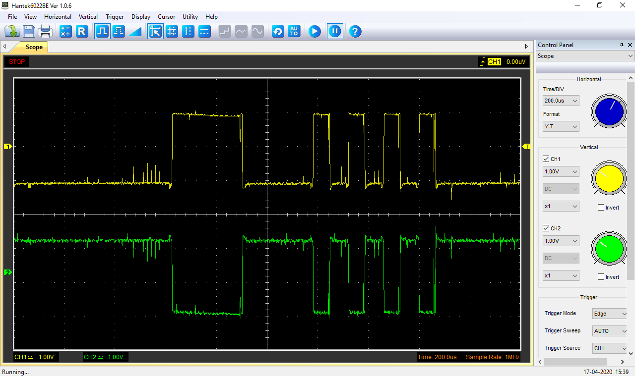

                      -Then I connected the audio board to see if sound response is working, result was:
                      Sound okay, but there is no change of the tone that mean that there is no coil response to metals.
                      Attached is screen for N40 & N50 from the front and receive.
                      Please do you have any advices, you and all genius team of this forum?
                      Cheers Anis
                      • Anis, in N40 N50, where is gnd for each trace? The receive signal should stay very near gnd.
                        Also if you take a large metal tin, you should see an obvious change in the receive signal.
                        It is possible that you have damaged the front end fets and 4093 when the 200v circuit was not working correctly.
                        The srf coil frequency measurement is useless, you need to use a faster timebase.
                        For the coil wire, you need to search here as there is a lot of good information posted on coil wire specs for Minelab machines. I am no guru of coil building! Check posts by IBgold.
                        Cheers Mick

                            Hi Mick,
                            GND is the middle of each wave.
                            Yep, I v already bought some spares for that as precaution,
                            Now I think It's working, I will share N40 and N50 waves soon (now I m replaying from my phone).
                            I tried with some big stainless steel saucepans and it seems that there is some responses, I m not too glad with the results, it my be some errors in the audio board (need to verify wire by wire).

                              Hi Ian, thank you for coming to support me with the DIY coil,
                              Well I m looking for the 18" coil , exactly 457mm coil, (for deep big targets)
                              as per last attached there is a large choice for wires, please can you specify what would be the good one for this?
                              Best regards
                              Anis
                              • Hi Anis,
                                Litz made with 36 strands of 0.2 mm enamelled wire would be perfect for what you want for a Mono coil it is what I use.
                                Regards, Ian.
