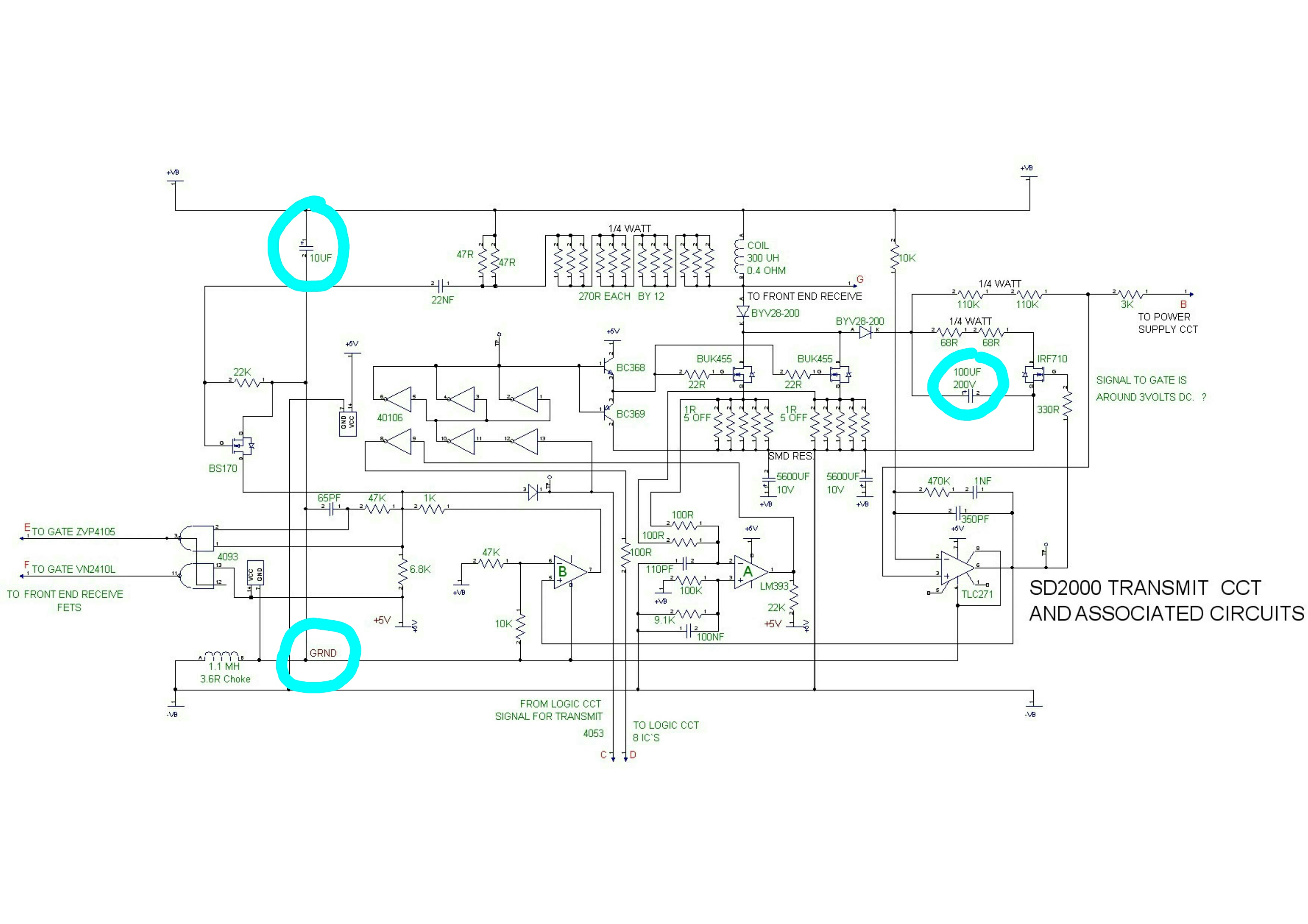

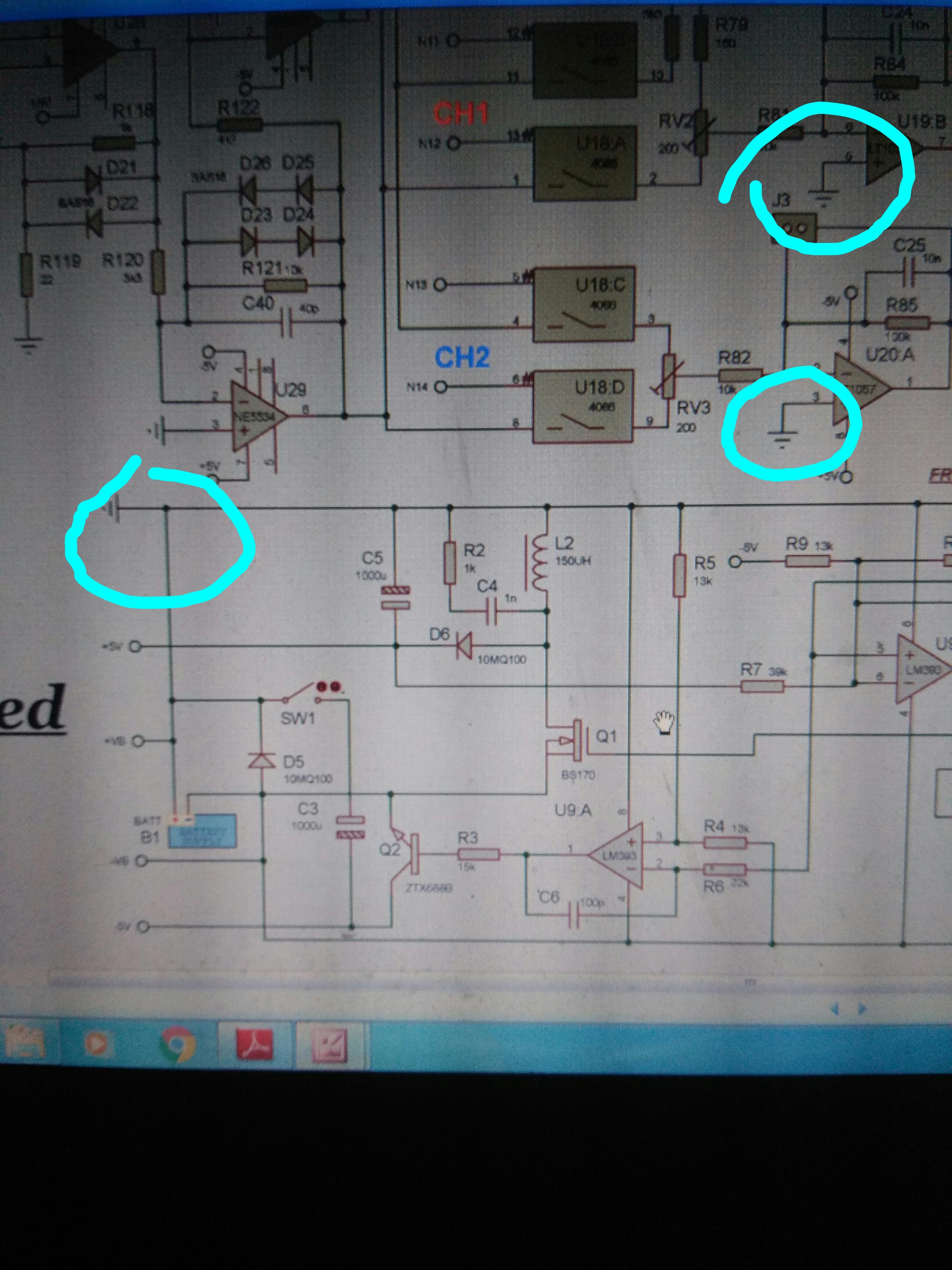

                how can this land symbol be accessed by the scheme sent by zed and kt instead of this positive path batrai

                  I do not understand what type of capacitor symbol is used and why there is a GND logo on the negative battery bar that I circled
                  • Originally posted by liekwang View Post
                    [ATTACH]50842[/ATTACH]
                    The 'plus' symbol on the cap indicates a polarized cap, typically either electrolytic or tantalum.
                    the "GRND" Name is a local 'ground' reference for the circuits on that page.
                      [ATTACH]50832[/ATTACH]
                      What they are drawing is the positive plate of the battery is ground, where you see the ground symbol all those points are connected together on the PCB, also to make drawing the schematic easier and to reduce the amount of lines they connect the component pins to the ground symbol.
                      • ok I have begun to understand what's in the scheme thank you sir for the quick reply
