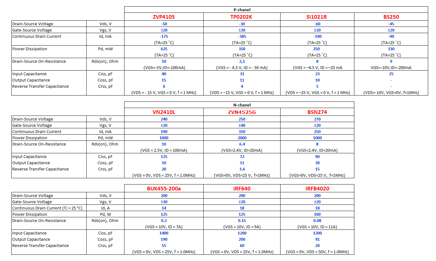

      From power transistors like good irf640, IRFB4020
      • I also found one TP0610K transistor, it seems to be not much better than zvp4105, but it is affordable and costs a penny
        • Hello Andrei
          Nice job on the tran.png file,makes comparisons much easier,the TP0610K is the same fet as the SI1021R,compare the two datasheets,the TP0610K is in a sot23 package,much easier package to work with than the SI1021R.
          Also the IRFB4020 fet is the same fet i use for a TX fet.

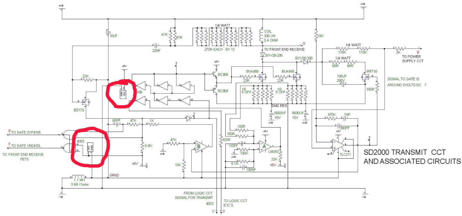

          • Hi, Can someone tell me what these componets are?
            Thank you!
            Greg
            • connections of power pins of the CMOSs' to power lines.

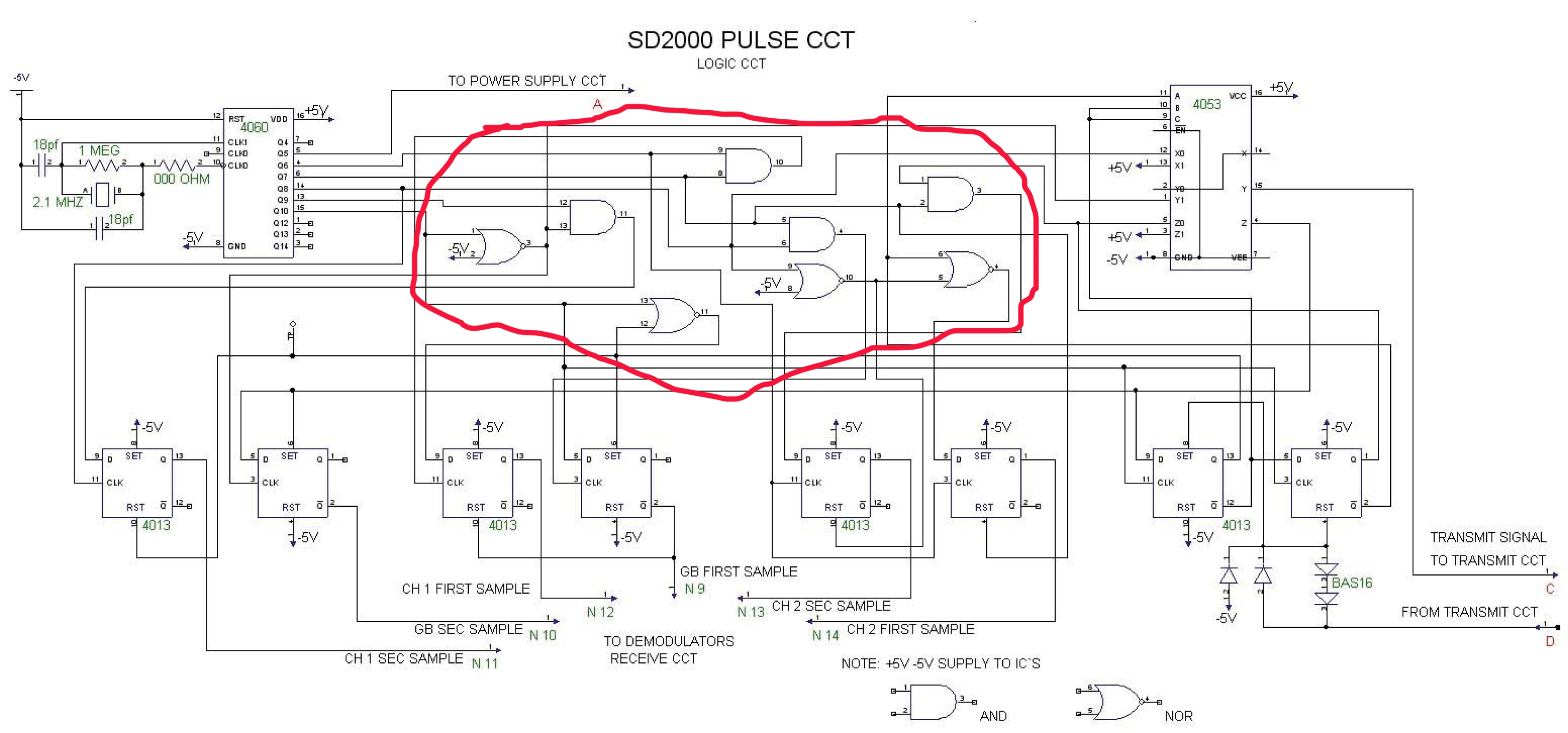

                What about the AND / NOR? Any part numbers? Are they individual AND/NOR ICs? On the SD2200 PULSE CCT...
                Thanks Again ?
                • 40106 and 4093? just add CD. CD40106. CD4093.
                  also HEF, also MM, HCF, etc.
                  MC140106. google more.
                  • which is which? 40106 = AND 4093= NOR?
                    • Originally posted by GOHO View Post
                      The CD40106B device consists of six Schmitt-Trigger inputs. Each circuit functions as an inverter with Schmitt-Trigger input.
                      The CD4093B consists of four Schmitt-trigger circuits. Each circuit functions as a two-input NAND gate, with Schmitt-trigger action on both inputs.
                      • I really appreciate the help but im still confused. I understand the Schmitt trigger and the components but on this schematic which is which, AND / NOR ?
Name:	SD2200 - LOGIC GATES QUESTION.png
                        Thanks!
                          [ATTACH]53982[/ATTACH]
                          Thanks!
                          Do you mean the logic symbol ?, they are shown at bottom of schematic

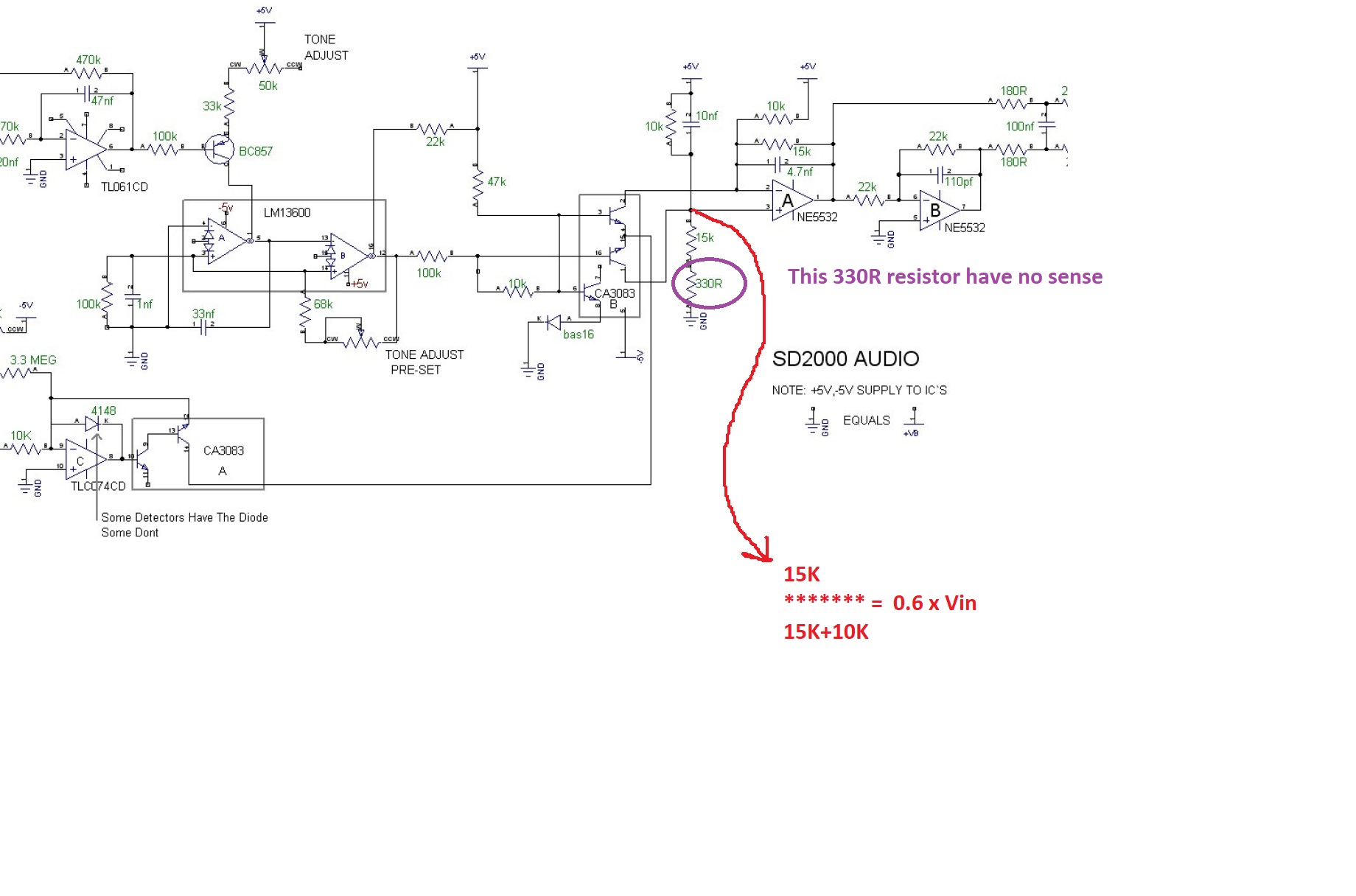

                              • I think i find one error in schematic and i am actually 100% sure its error as it have no sense.Click image for larger version
                                This 330R resistor have nothing to do in this voltage divider configuration.
                                Voltage is set to the 0.6 x input voltage and this 330R resistor simply not feet there.
                                Can anyone who own SD2000 check?
