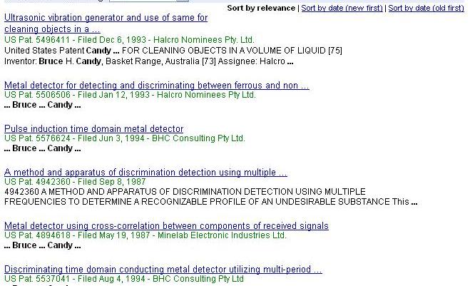

                      Patents
                      Visit Google patents, over 7,000,000 patents. You don't need to know the # of patent, you also can type the name of inventor, for example Candy, Bruce. See the pic. Whit this method we found 100 patents, metal detector or not, but is very easy! Also you can download the patent and see appart drawing, etc.
                      http://www.google.com/patents
