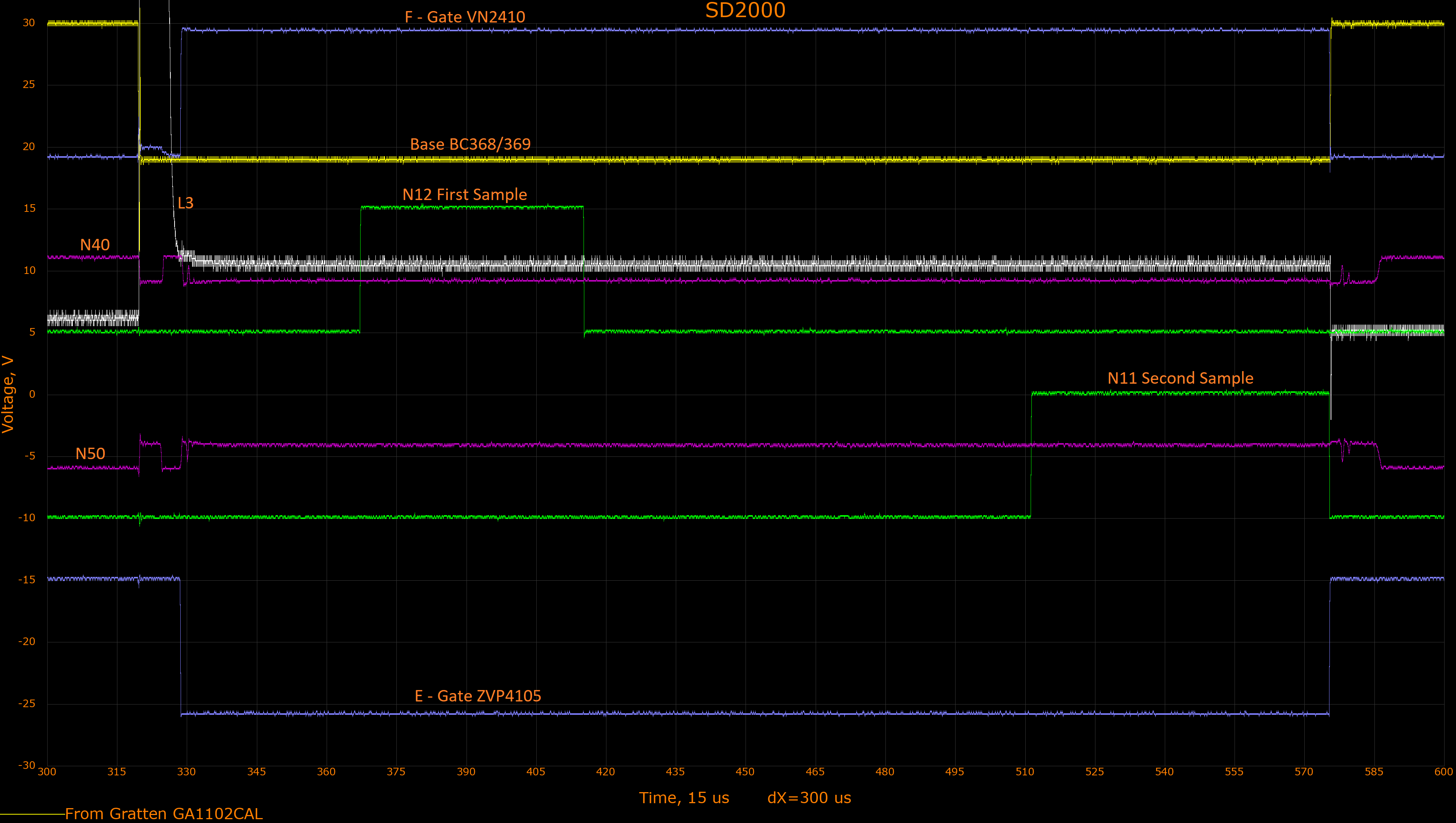

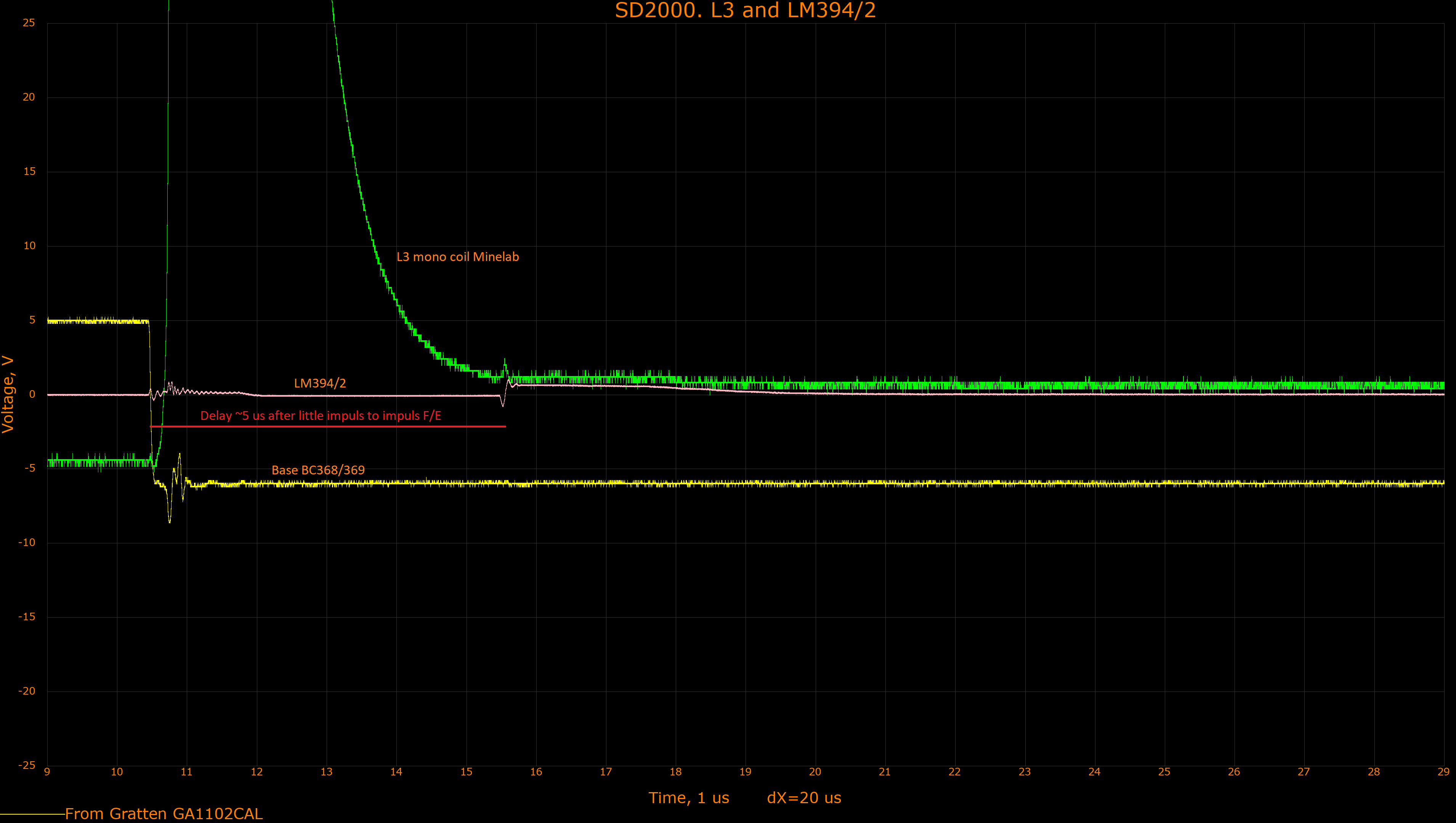

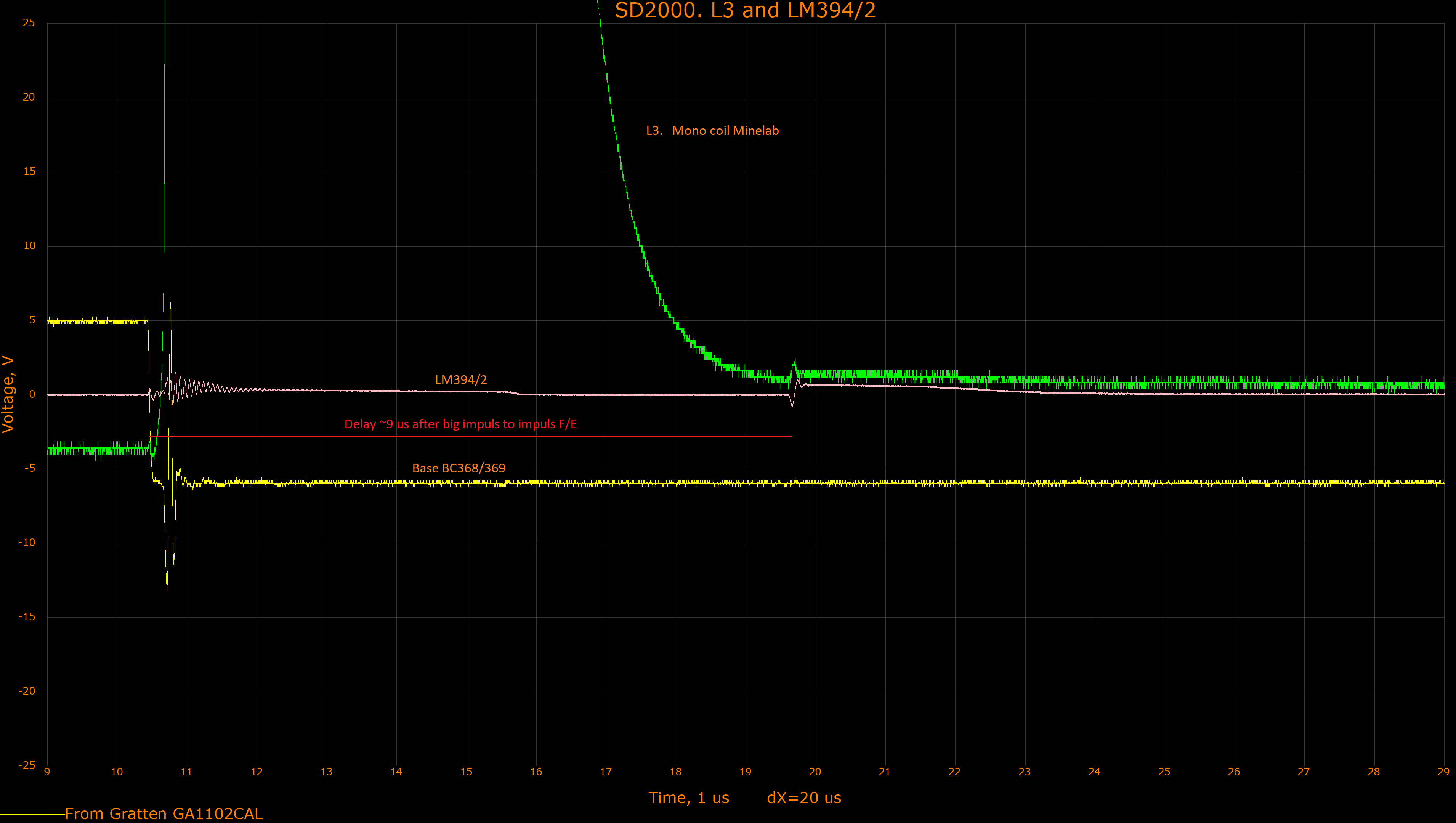

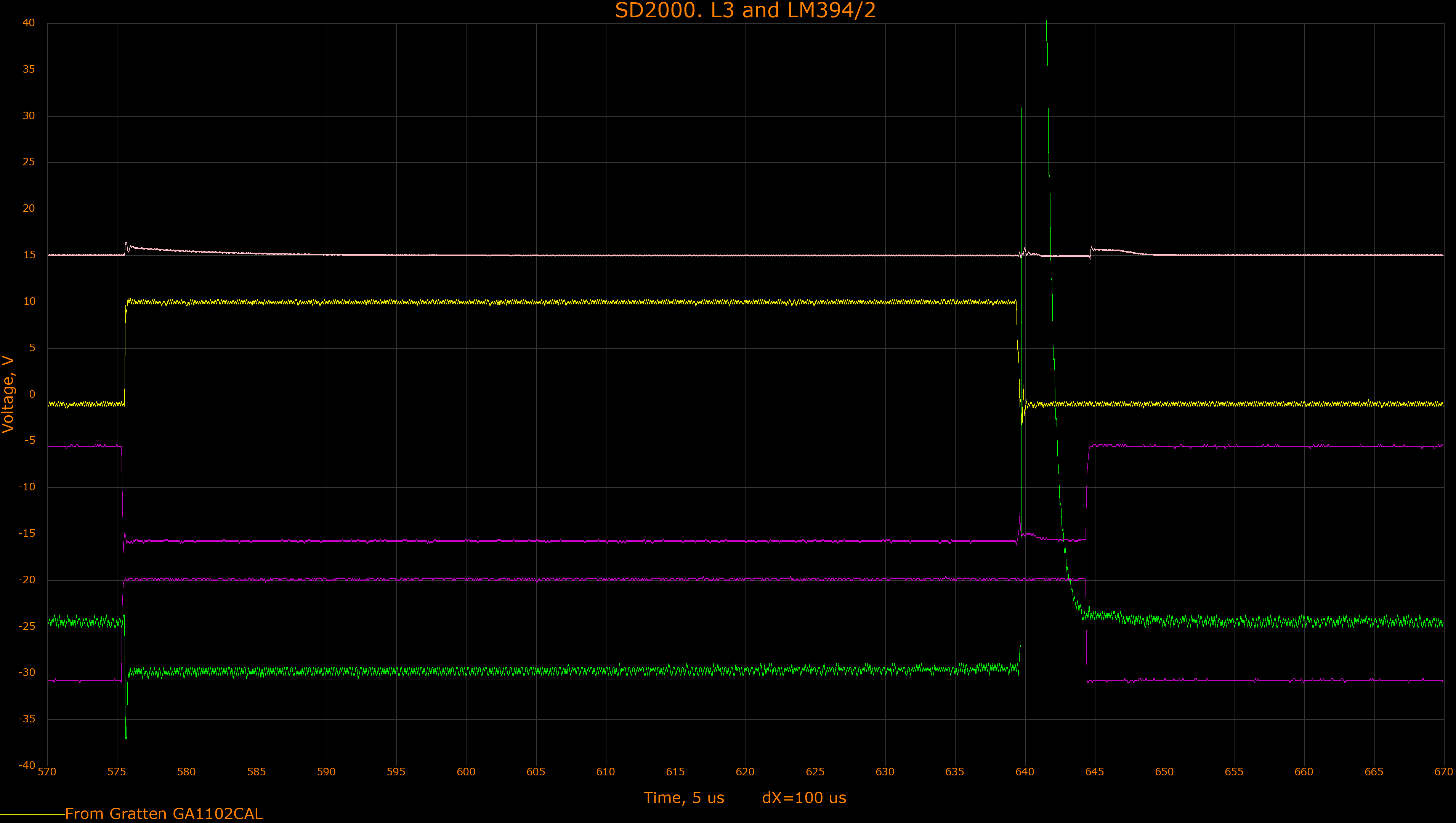

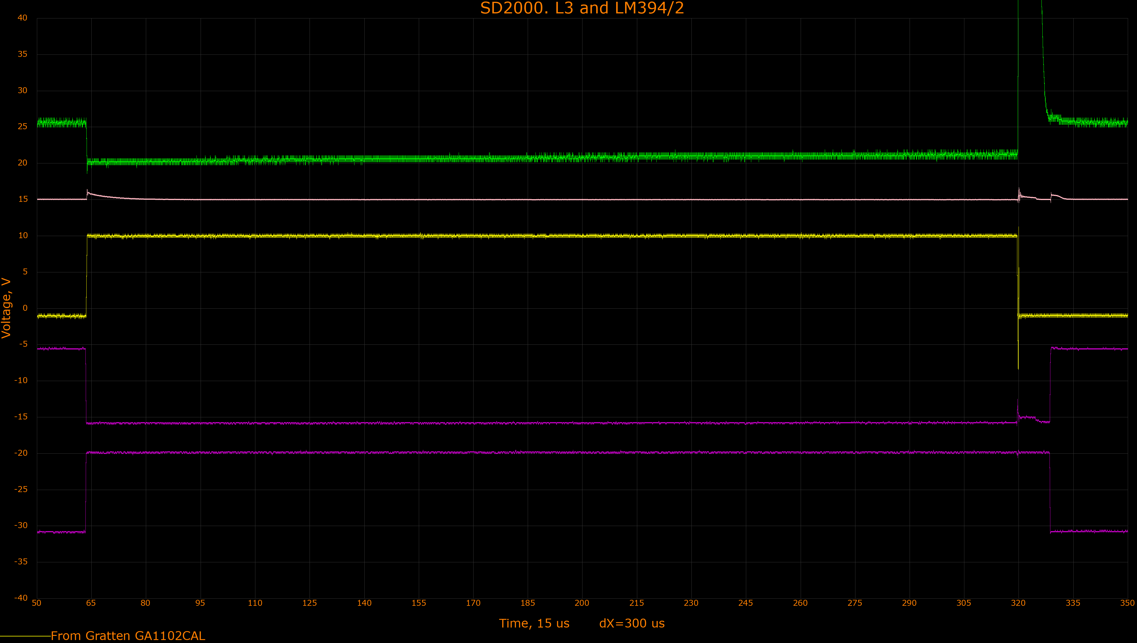

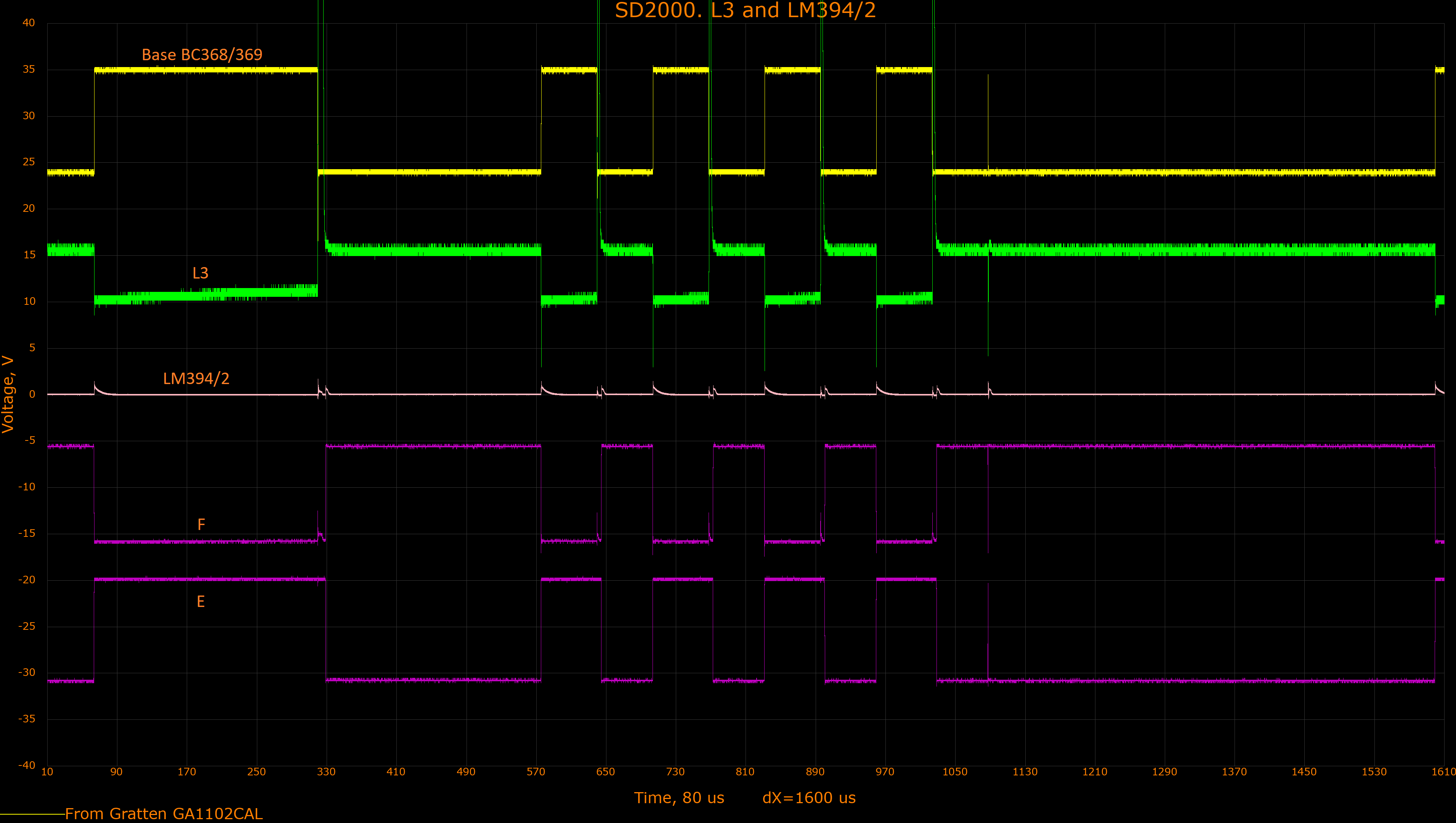

        • Hi! my waveforms are SD 2000. What should be the delay before opening VN2410 and ZVP4105Click image for larger version

ID:	361477Click image for larger version
ID:	361478Click image for larger version
ID:	361479Click image for larger version
          • The blocking fets are used to protect the preamp from the high voltage flyback. The delay turn on should be set to a point when the flyback has settled to a voltage that is within the supply voltage of the preamp less than +5v. As a practical matter for this circuit there may be a delay in the fets closing and some other factors. This delay will also very with different coils, depending on their SRF's. Zed or Mechanic will know, maybe they will see this and give you advice.
            • Altra is correct,the receive fets switch the pre amp away from the coil during the flyback period,once the flyback voltage settles close to zero volts then the preamp is re connected back to the receive coil,The blocking action should finish before the first sample begins.
              • Hello everyone. It turns out that the opening of the VN2410/ZVP4105 transistors can be shifted almost to the first sample and the sensitivity will not change from this. And why is the first sample taken so late? If the attenuation of the coil is ~15 us plus the time to open VN2410/ZVP4105, then probably the first sample can be taken probably after ~20 us and the sensitivity will increase,and it is taken after 45us

                    Changing the crystal oscillator can advance the sampling time, CCT is fixed and not adjustable

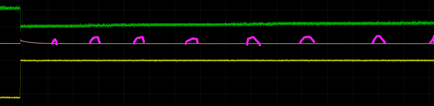

                            • My 4105 output has 62k interference, as shown in the figure below. I don't see 62k interference?
