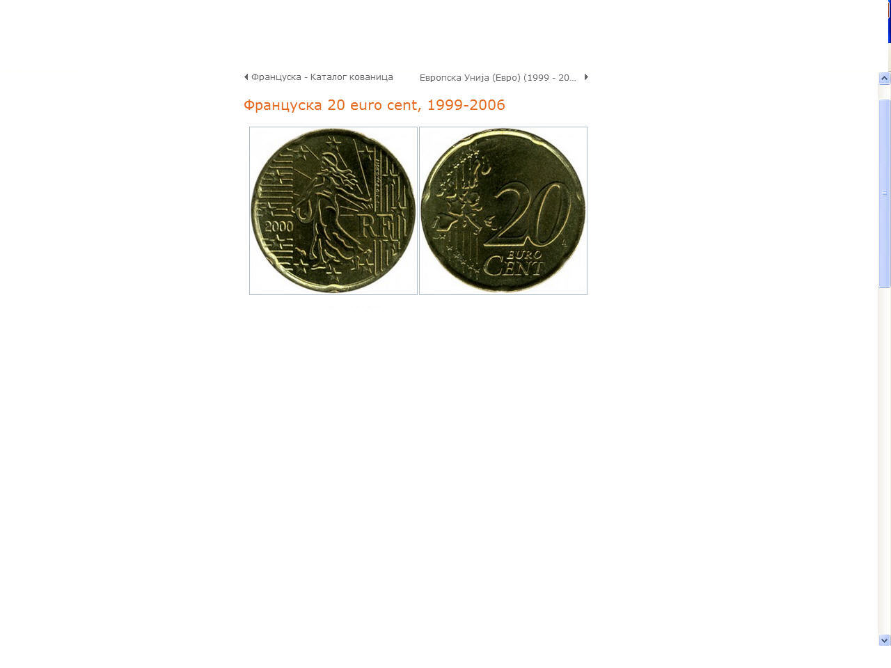

    Hello, what's the size and material of a 20 euro cent coin?
    Coin diameter 20 euro cent (22mm) -thickness 2.14 composition Nordic gold , originates from the year 2000! It depends on the country in which they were minted, I tested on this one!diameter- ?precisely? 22.25mm
    https://sr.ucoin.net/coin/france-20-...-2006/?tid=960Click image for larger version
Name:	20 centi.jpg
      https://sr.ucoin.net/coin/france-20-...-2006/?tid=960[ATTACH]55426[/ATTACH]
      OK, thank you very much!

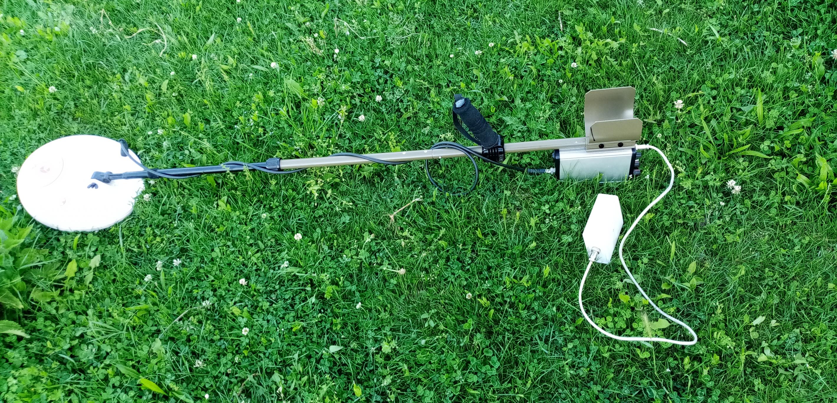

                              • here is sd2000
                                Hello everyone, here is a sd2000 pcb all everything on a single board here, dimensions: 170mm-110mm. But I don't have tc27m7 and I can't find a few parts I need your help on this.
                                Otherwise, I will not dare to produce.
                                Circuit photos are in the link below, friends. I could not add them directly. I have little knowledge about it.
                                https://ibb.co/HT2YcnQ
                                https://ibb.co/0fJW0Mb
