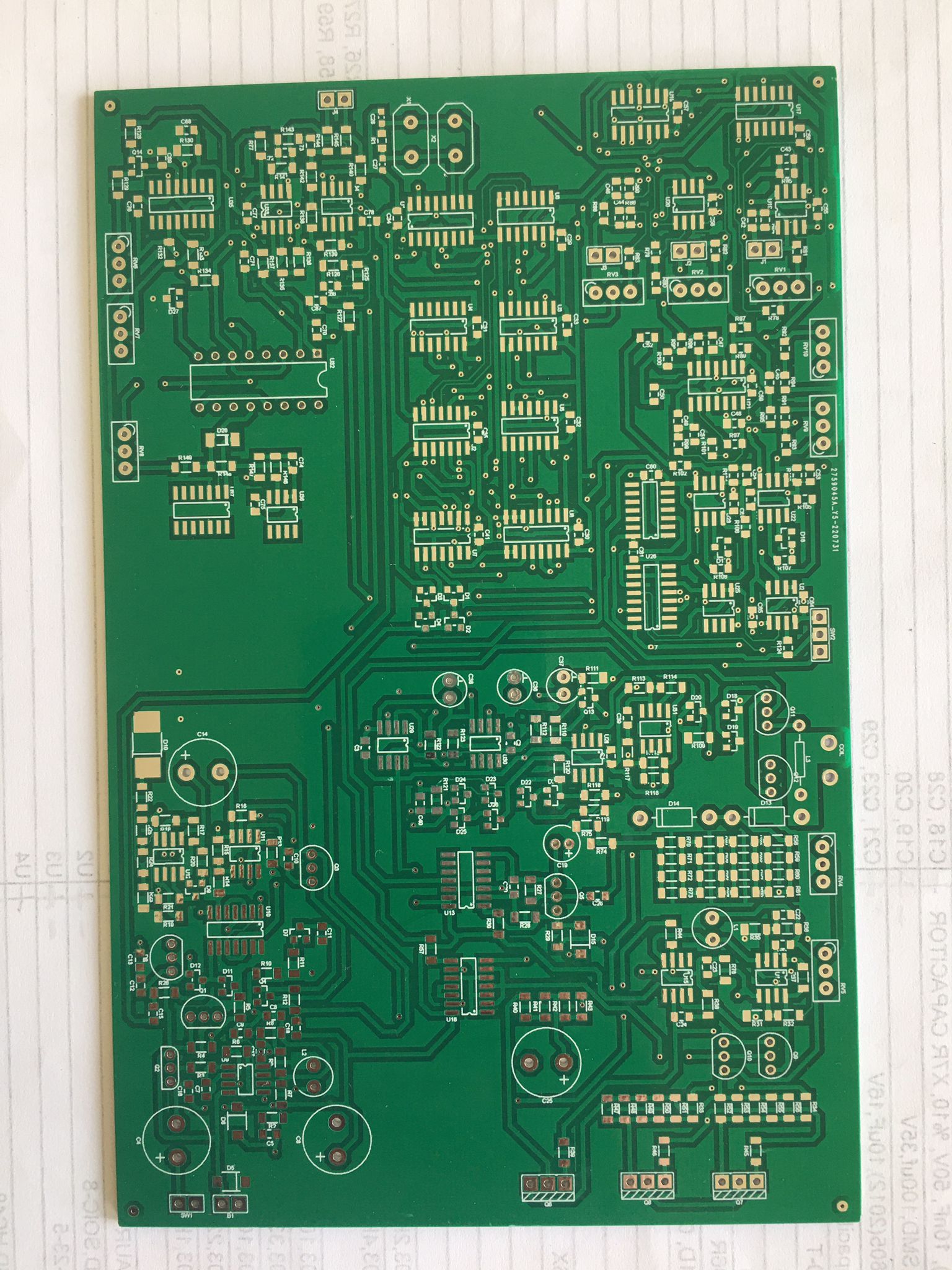

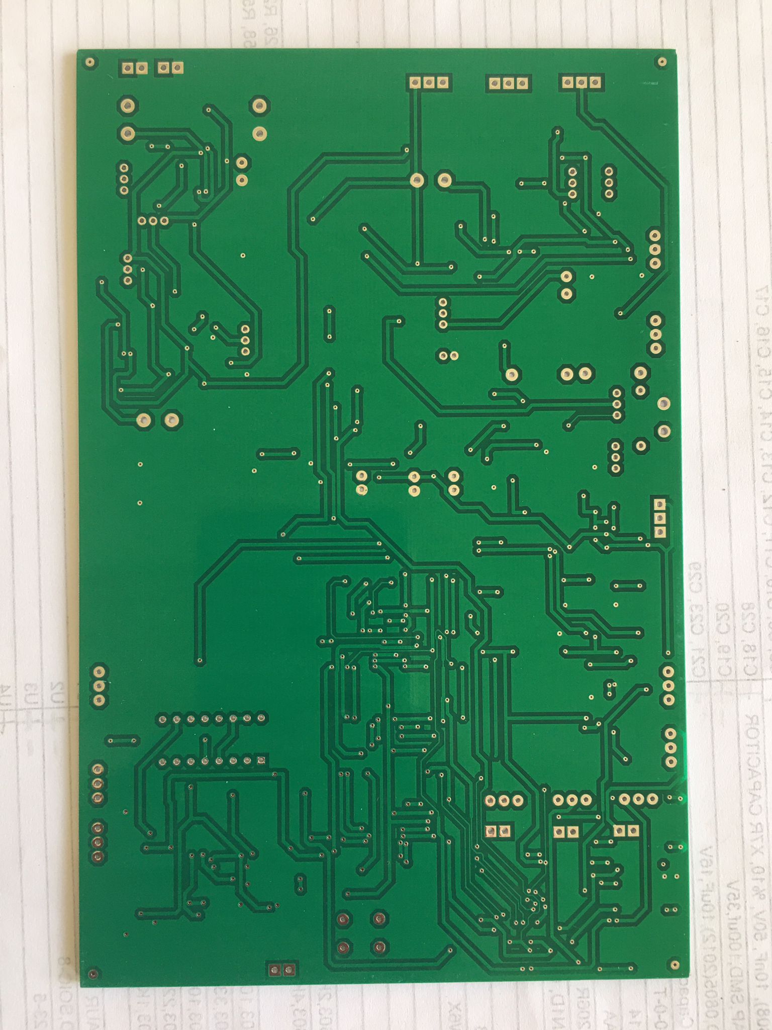

    • pcb arrived
      pcb geldi iyi iş?ilik par?alar i?in bana şans dileyin andrei

        • Do not use old parts, use TLE 2022 in place of TLE27m7 as is has faster settling time , greater bandwidth, less noise and lower power. And is much better, i have used this as a single supply buffer amplifier on the SD2000 .
          • May be TLC27M7?
            • if you install tle2022, will you probably need to change the amplifier harness?
              • TLE2022 may not be compatible, it is what is used in the GPX4500/5000 detectors, my bad. I had a re-chipped SD2000 but I sold it and now cannot locate my files.. I made some small sub boards with different chips, but like 8 years ago.

                  where is PCB file ?
                  plase upload PCB file.

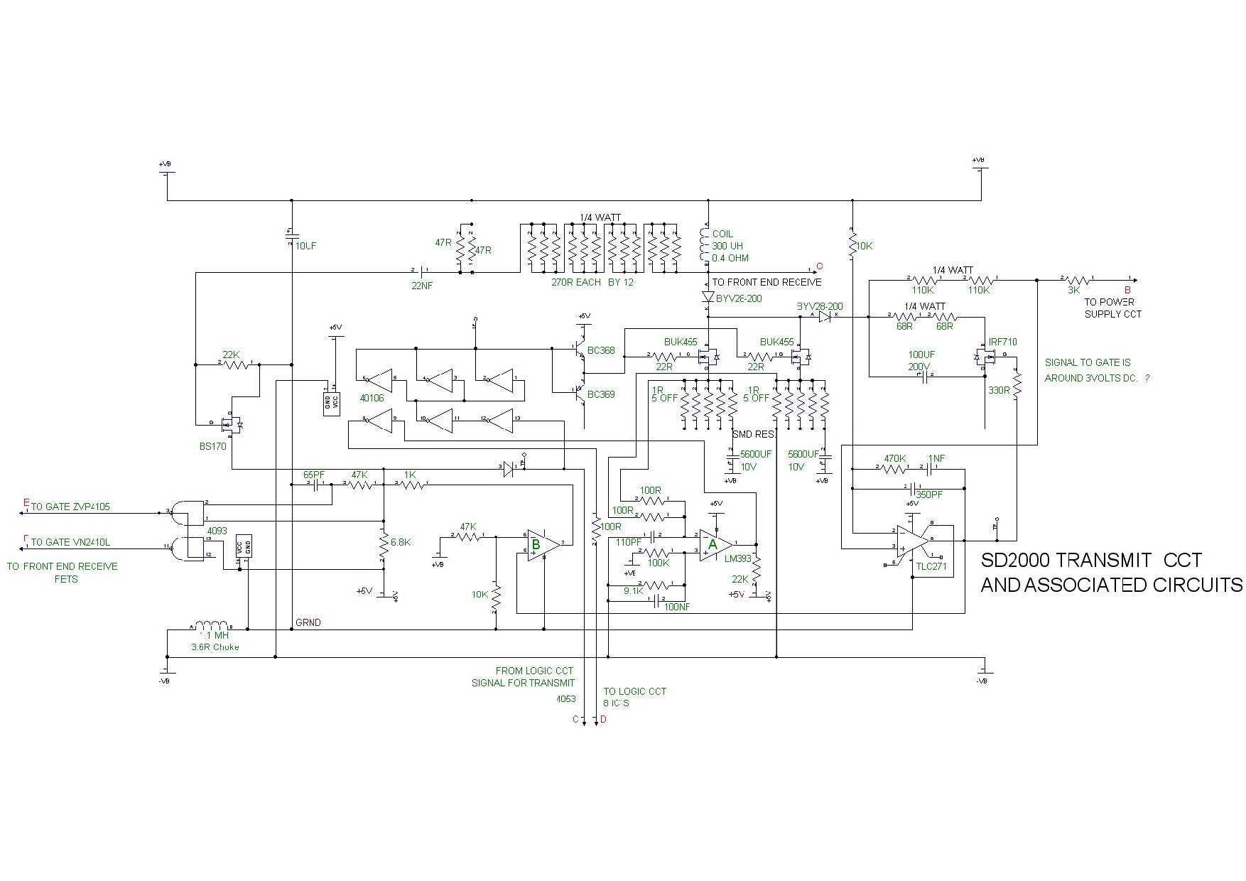

                  • ​ What would happen if you did not connect that is to 8 pin cd40106 with 100R ?​I know it locks Tx, does it affect anything else?​ Is it possible to take the sample later or earlier after closing the tx signal?​
                      It allows the detector to use 1Mhz or lower frequency timebase, beware stretching out the TX below 900Khz as the mosfets will nearly start glowing in the dark.
                      • Originally posted by detectormods View Post
                        Thanks Peter, that means no smaller crystal than 1mhz​ ..
                          You can go lower in frequency but the output Mosfets will need to be upgrades to lower on resistance types.
