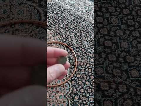

                  • Sd2000
                    • Originally posted by star View Post
                      Sd2000
                      Good work, what type of coil wire, and regarding the IC LM394, LM13600, CA3083, I can't find them on the internet to buy them it seems that they are obsolete chips, have you used them or did you use replacements , THANKS
                      • image widget
                        • Originally posted by zohir View Post
                          Coil 27cm
                          wire 1m
                          18 ture
                            Coil 27cm
                            wire 1m
                            18 ture
